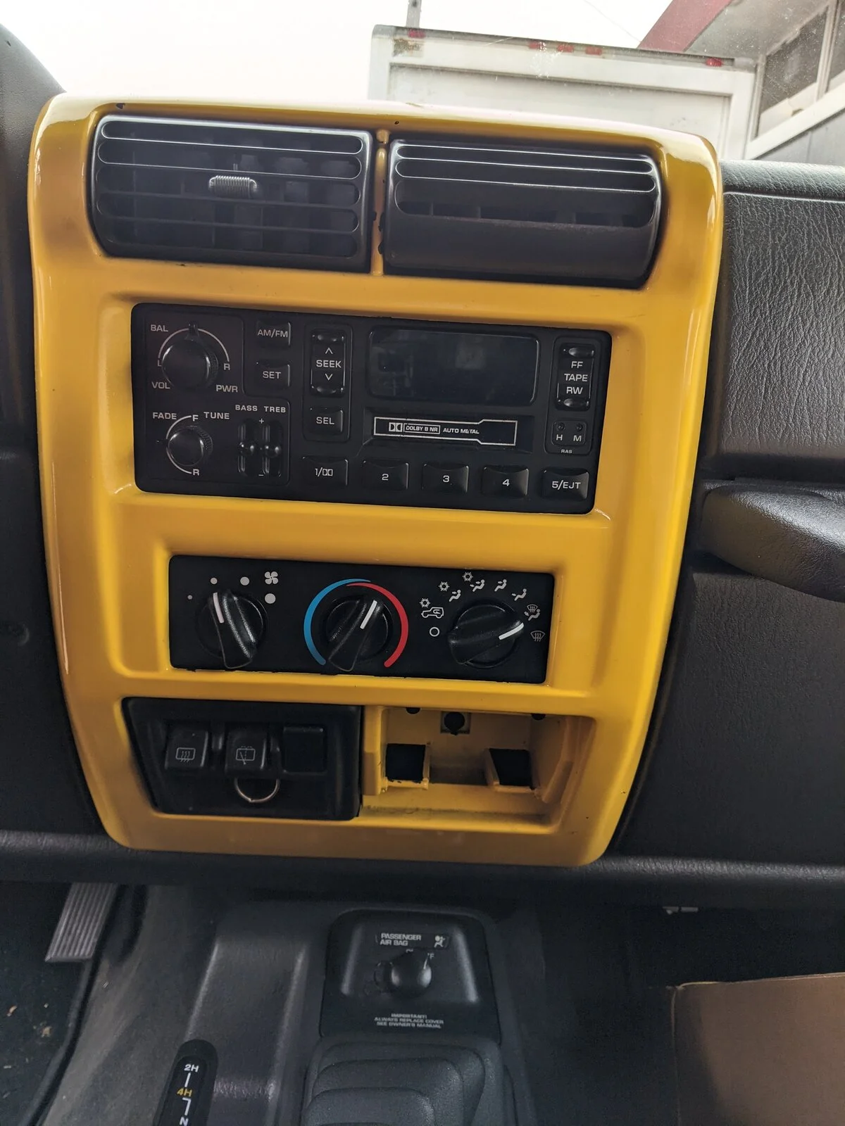

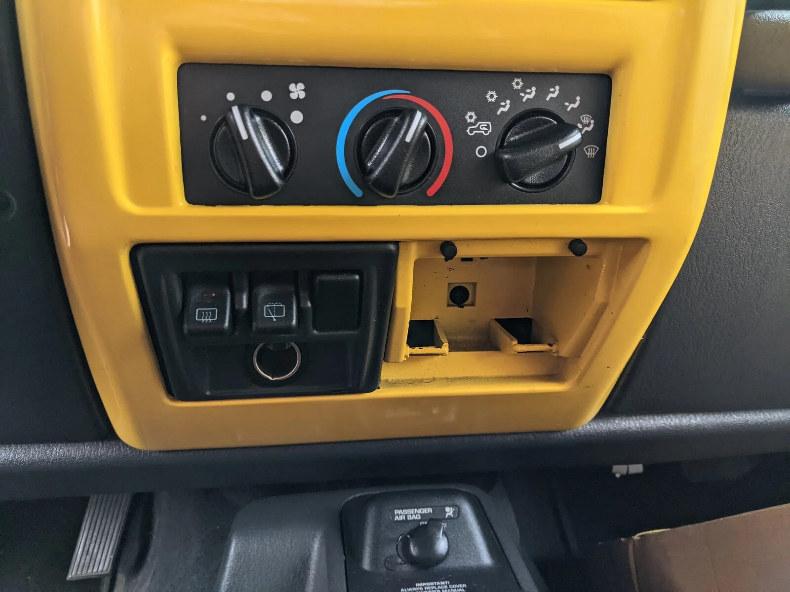

Dashboard in my 2001 jeep Wrangler has an empty spot where I assume an ashtray was located. I would like help finding the panel that would fit here so that I could add light toggle switches. Please see attached images...
That’s actually where a blank panel comes from the factory. Many people use that blank panel and use it to place switches on for aftermarket accessories.

No, it's made to snap into place where the vents are on the upper portion of the center stack. I'll post a couple photos later today of how I modified it to work.
Follow tworley's link for an idea on joining the switch panels together. The ash tray mount section of the bezel will have to be carefully cut out for the second panel to fit. Just remember, measure twice, cut once!

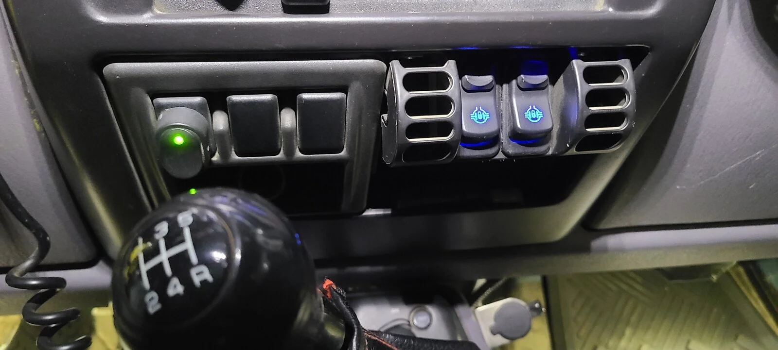

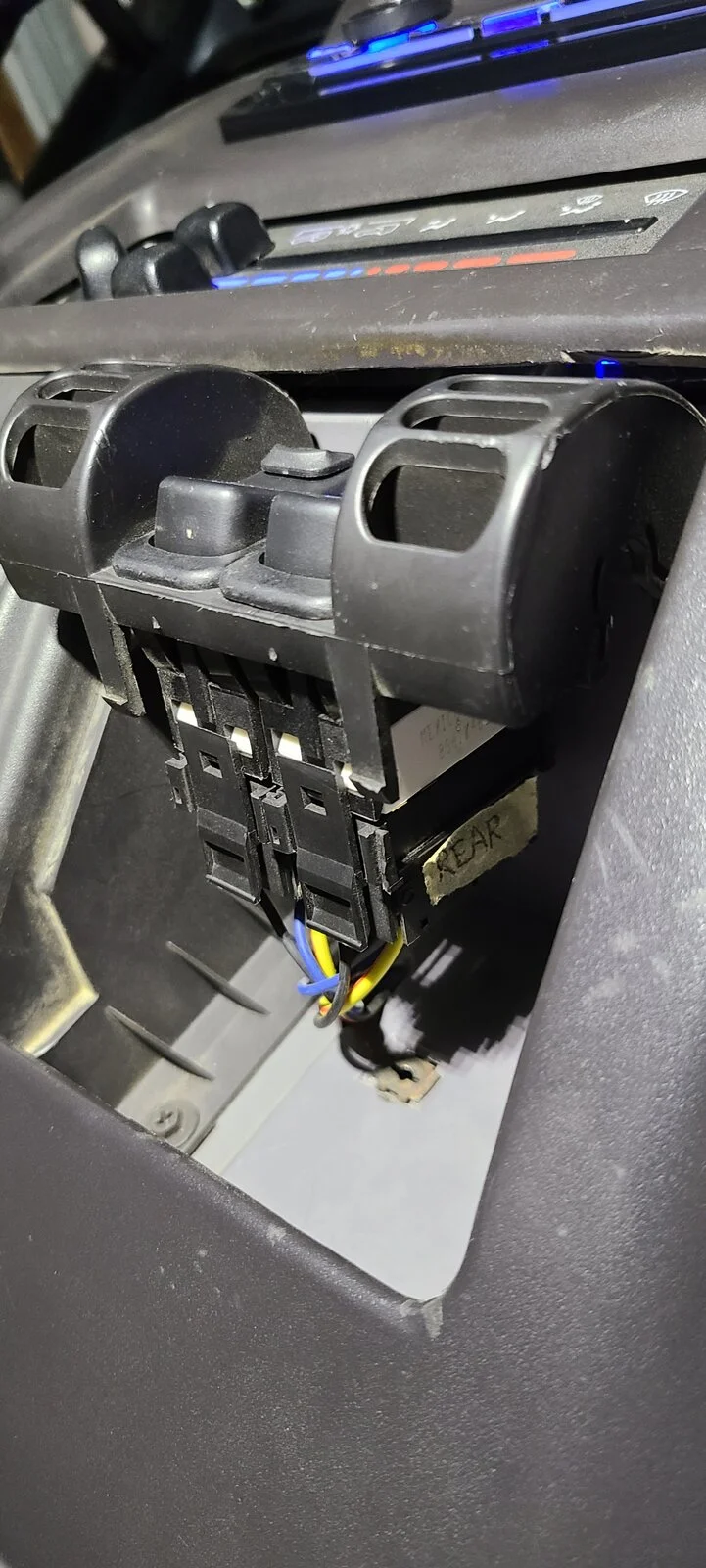

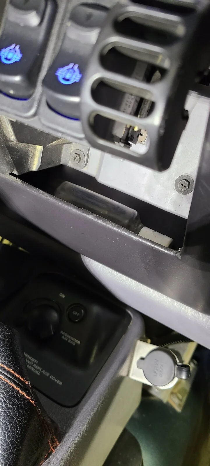

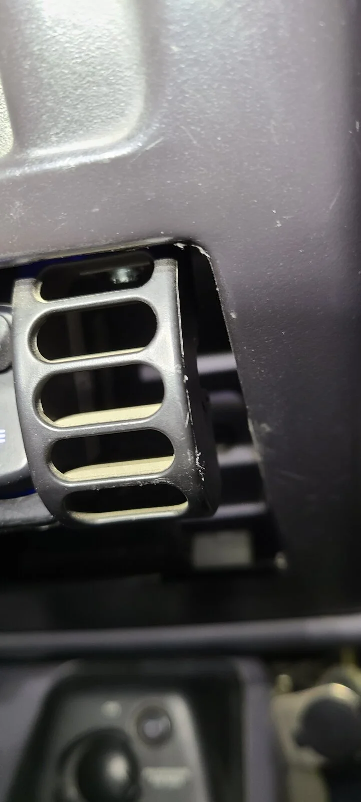

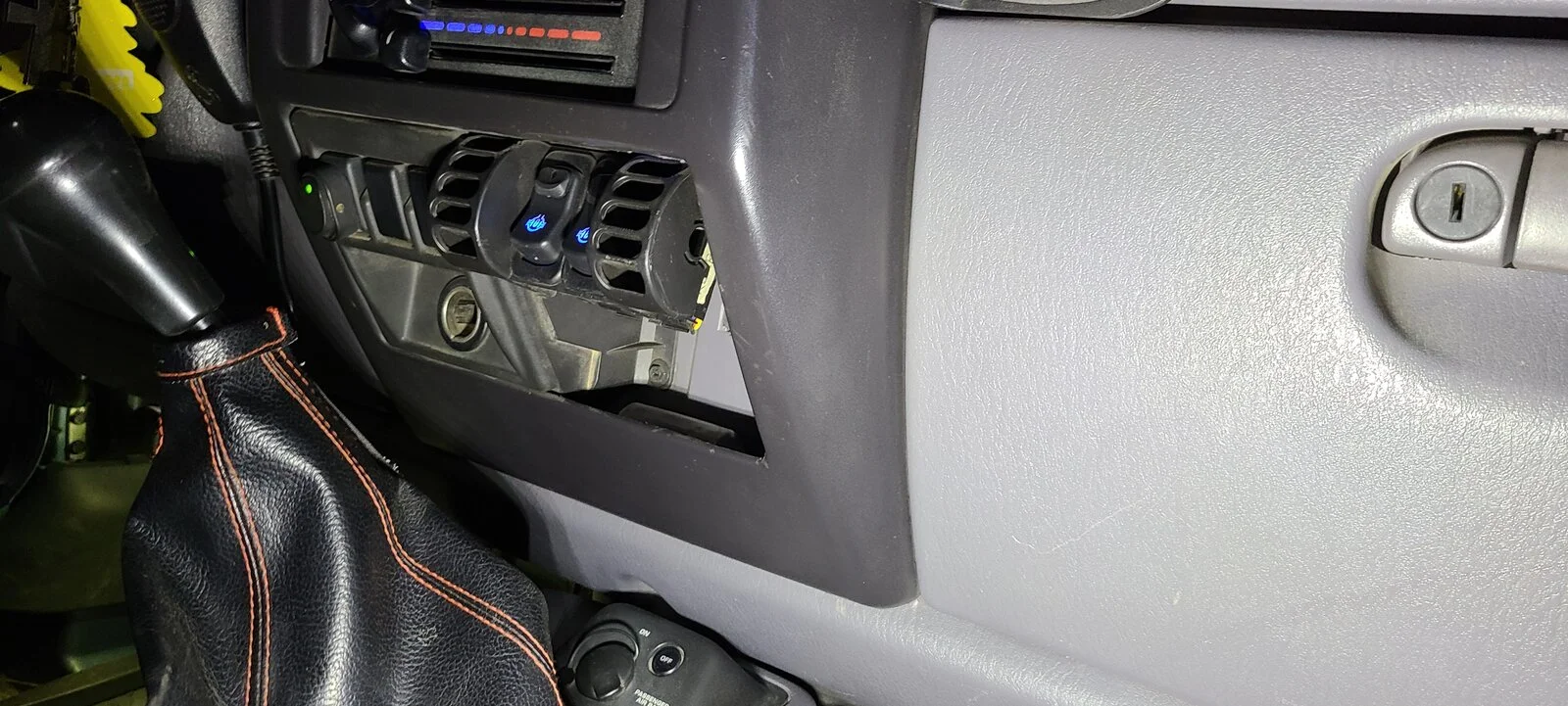

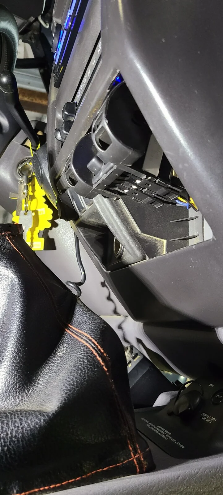

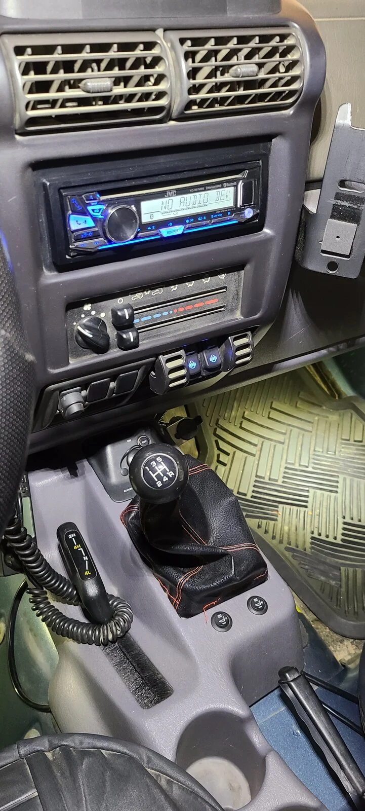

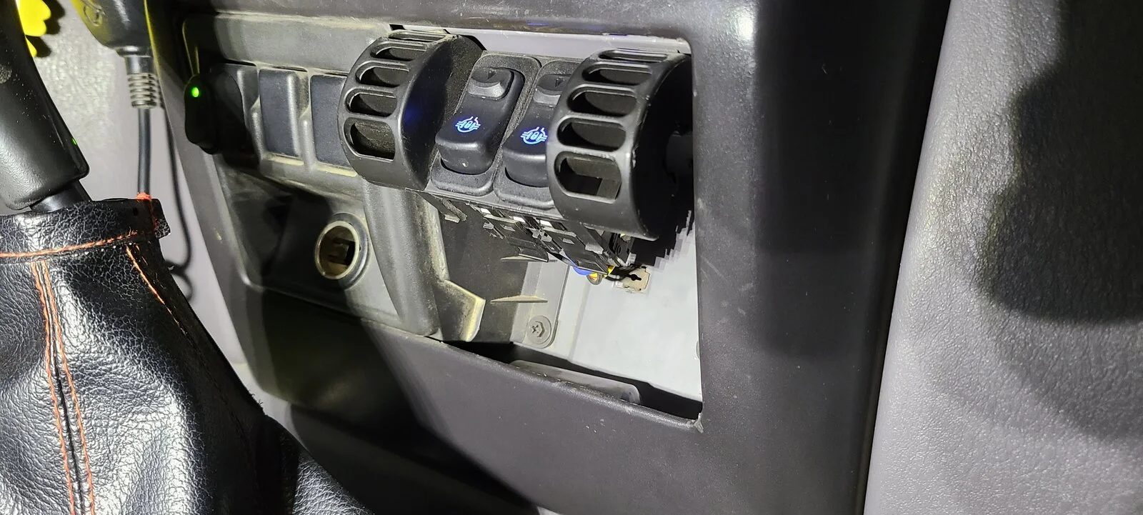

Here's my solution using the daystar switch panel. I considered following the write up by Stu Olson (linked above) but the Eaton switches were too large to fit in the factory blanks. I basically removed all of the plastic made for mounting the ash tray. Then hung the daystar panel with 2 screws running vertically into the inner plastic dash. The black center stack (outer panel) can be removed without removing the switch panel which is kinda handy.
It does leave you with a dead space below the panel, which obviously doesn't look "factory stock". My plans to build a custom center stack panel are still evolving... You don't really see this unless you put your head below the dash. This option works for now.
You can see one of the mounting screws in this picture. I've found a good use for cubby space left below. The wife's bottle of purel fits nicely. 👍
