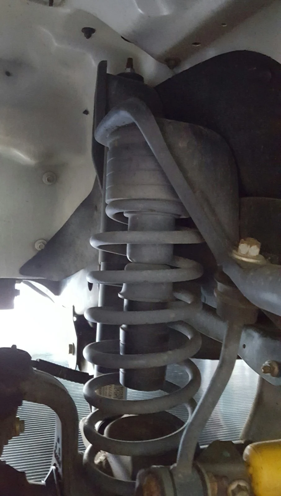

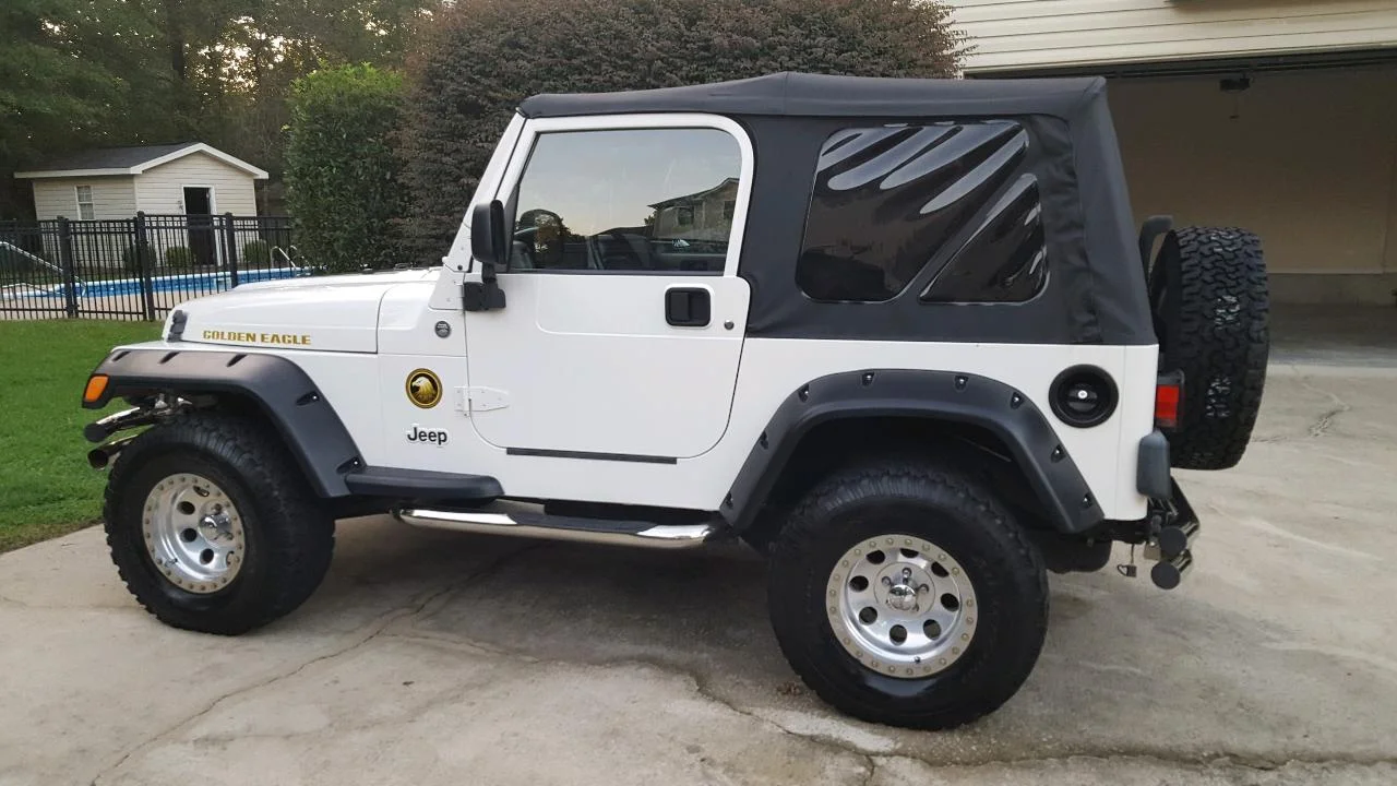

So today I brought home my first Jeep! Woot-woot! I'm a newbie so go a little easy on me. It looks to me that the front was lifted using spacers, see pic below. Can't know what the past owner did since he had passed away 4 years ago so the Jeep has only been driven 5k miles in those 4 years with a total of 49k miles on the clock.
Not going to be doing any real off roading so the upgrades will be mainly for looks. She has 32" tires that I think I like them ok. Don't really like the rims and the tires are in need of replacement so I can go down to 31" if need be. My plan was to do the 2" OME springs and shock lift. Was hoping that would give me a better ride than how it is now.

Wow, that is clean, even underneath. Great find! There are options galore, wallet dependent of course. I'd look around online for Jeep pics and see if something catches your eye. I would definitely ditch those 3" spacers and install a proper lift or go back to stock, nothing wrong with that. I can't get over how clean the chassis is. You really scored:clap:
Awesome! You guys are making me feel "Really" good about her!
She has a clean Carfax and I don't think it has ever been off road. Been garaged the last 10 years. A new top was put on 2 years ago.
So a 1" body lift is necessary for the 32"? I am going to ditch those Flair's and go with the flat ones. Something like these.

Your shocks are what control ride quality.
For your intended use, you could go two ways:
1) The OME Lift mentioned by @Chris. If you don't add heavy mods like bumpers, winches, et al., you'll get 2.75" of Lift. 32's would clear. A 1" BL wouldn't be a bad idea. This would allow you to upgrade and wheel easily if you got the bug
2) Stay with the spacers and just get OME Nitro shocks or Rancho 5000x. That will improve your ride quality. A 1"BL wouldn't be a bad idea here either. 32's would clear. This would be more for looks.
Edit: with flat flares you probably would not need a BL
Thanks again for the suggestions. I've been reading thread after thread and pretty much have fried my brain with all the info that is on this forum. So I'm sure more questions will follow!
Ok,first off, great score, and you have a great start there. Take my opinion as what it is, an opinion. 3" of spacer lift is not ideal, but I get why the PO installed them to fit 32's. I too am not a fan of the wheels, but they are not horrible. You will not be disappointed going with a OME 2" lift. Since you are needing new tires anyway, I'd jump back down to 31's and don't worry about a body lift. The OME lift will give you plenty of clearance for 31's, plus your new flat flares will give you even more clearance, however, some Rubi flares would look better IMO. Next, see if you can find some used Golden Eagle Ravines. It would complete the GE looks. Smart getting rid of those Bushwhacker flairs. Put them on CL and recoop some cost. The bumpers and tube steps need to go. Welcome aboard, and have fun with it. My 2 cents.

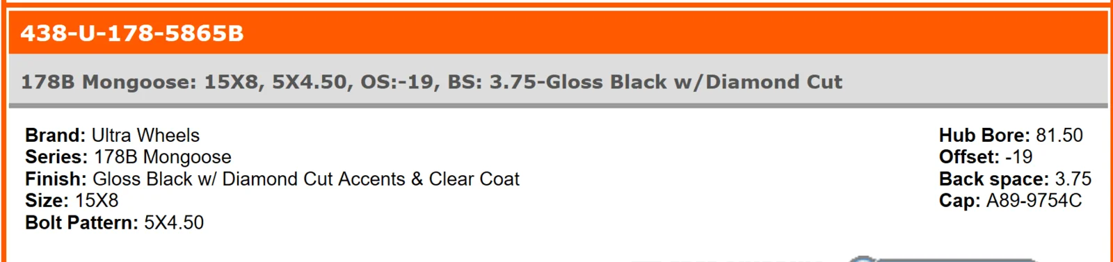

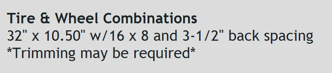

Now a question about wheels! I currently have MT 15x8 wheels that have about 3 & 3/8 of backspacing. I'm looking at the Ultra 178 Mongoose wheel. 15x8 but with 3.75 backspace. Called 4wheelonline and the guy said it wouldn't work because of the backspace. I thought I had read that 3 3/4 to 4 1/4 was the optimal backspace? BDS (2" lift) recommends 32"x10.5 on 16x8 with 3 & 1/2 back spacing.
Dang!!! Trying to figure out this wheel stuff is making me crazy!
3.75" back spacing will work fine. I'm running Ultra Nomads with that exact BS and I'm on 33X1050's.

X2. That will work. Don't know why in the world they would say it wouldn't. You are on the money
