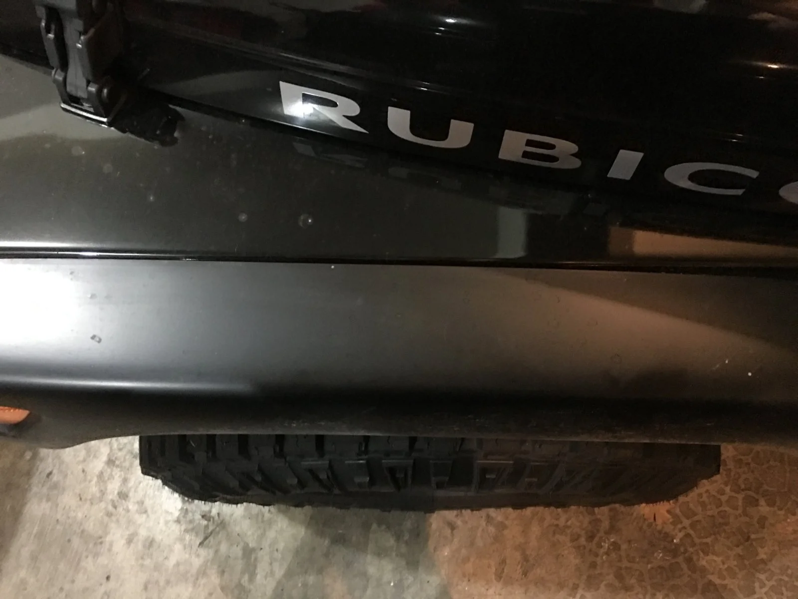

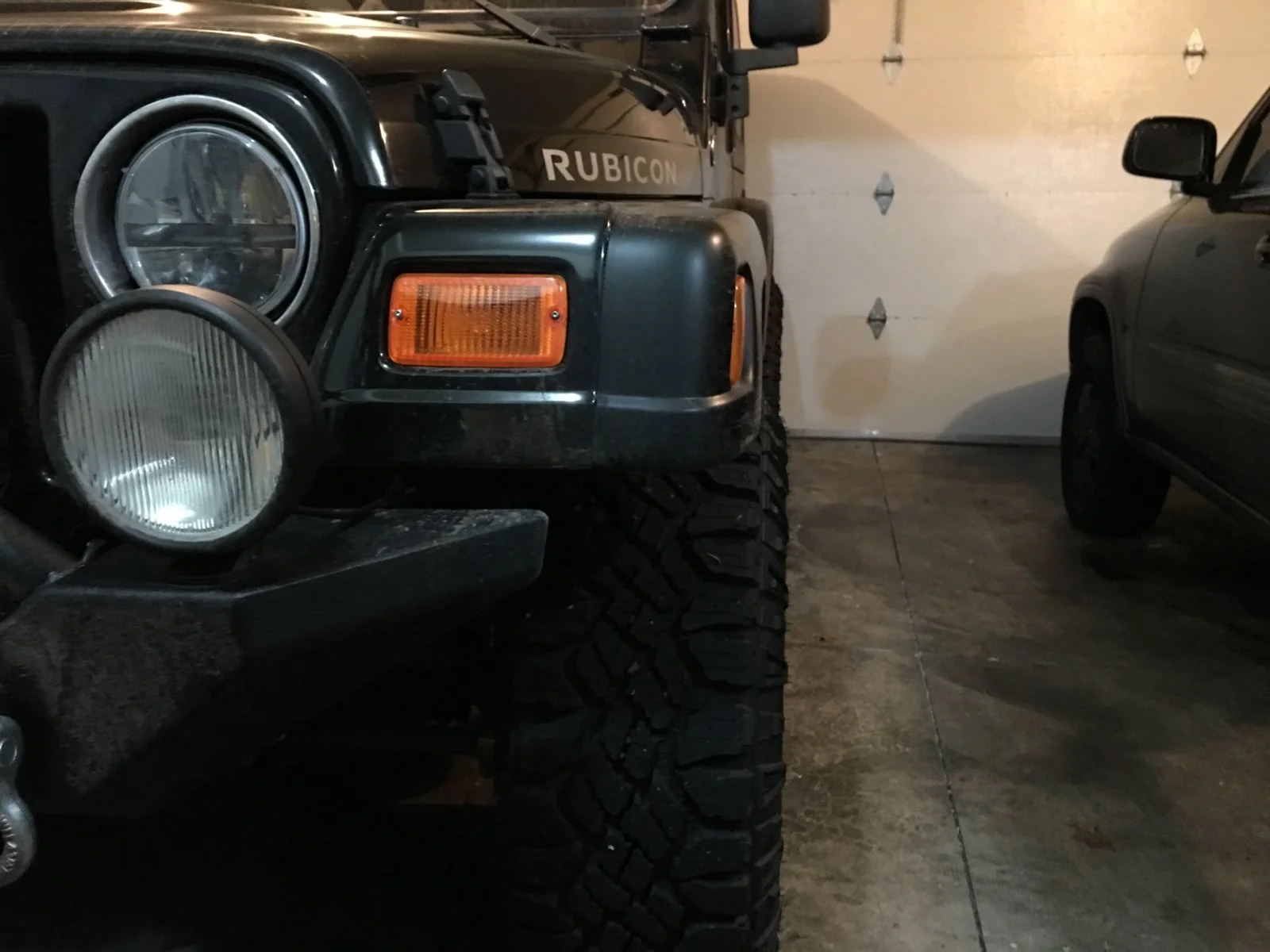

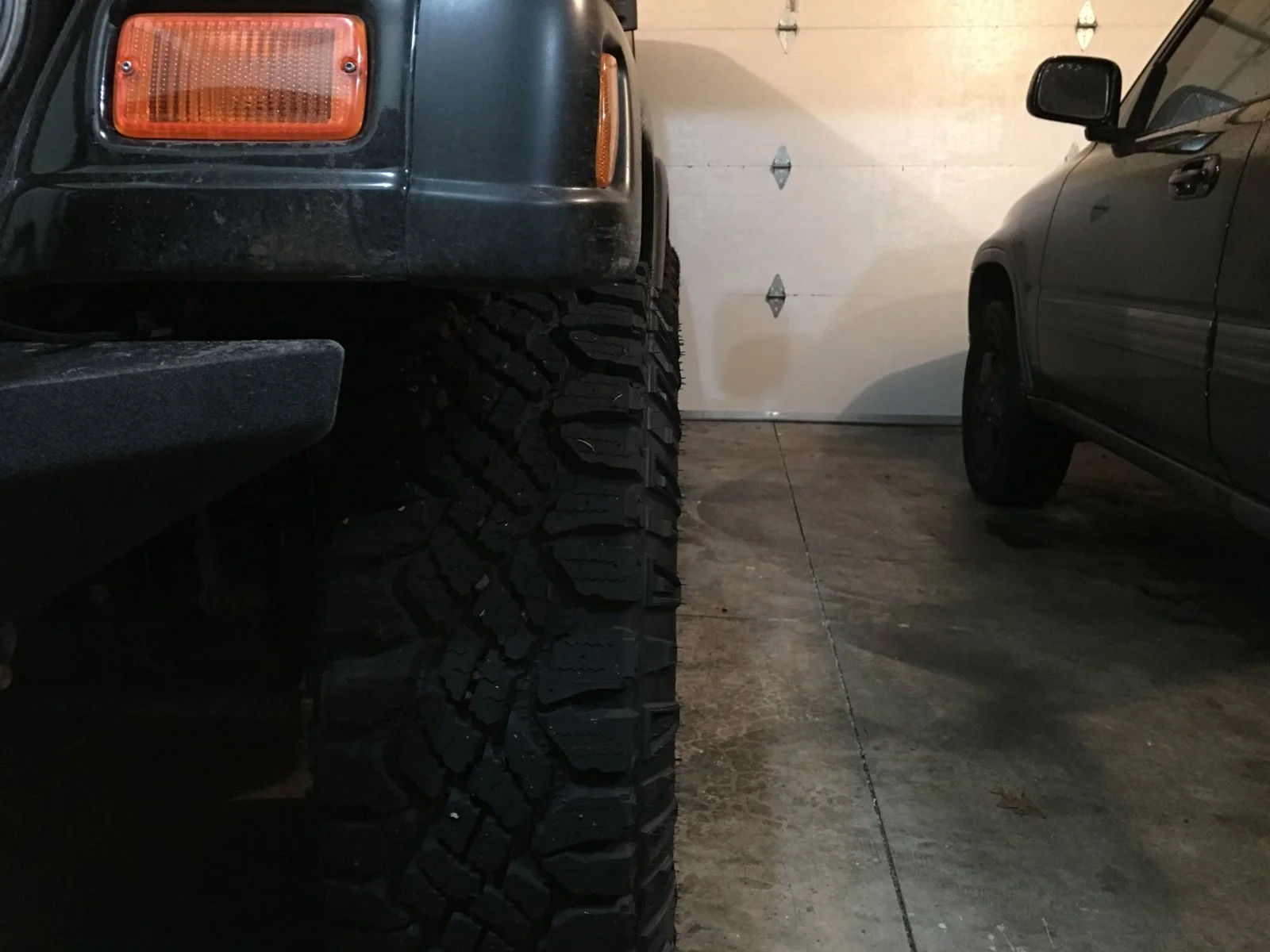

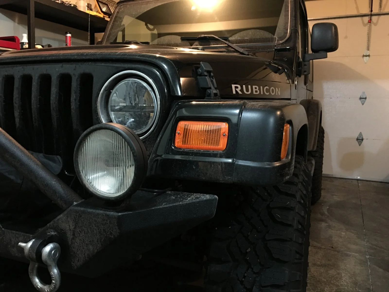

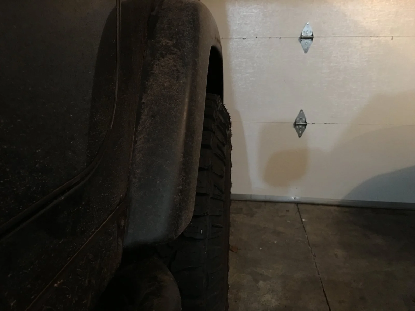

lol..So back on topic,. I take it your not a big fan of the tires sticking out past the flares? Just flinging rocks/mud up more? I didn't really think about that. I'm torn if I should do this. I had to do a good bit of driving today and the KO2s in E load ride alright. Smooth rolling. I'm a creature of habit and my driving routine is pretty standard for years. I can already tell seems I'm getting better mpg with these bigger tires than the smaller MTRs. I kinda could tell just by how it rolls easier. I don't know if I need to move to the C load, but sure would be fun to dress it up with some new wheels. tire shop says I still can (they want to sell me some rims).
Oh no, I actually like that look a lot (the wheels sticking out). The issue is (and you very well may run into this) it's illegal in most (if not all) states, and to top that off it's annoying as hell if you plan on going in dirt, mud, gravel, etc. as it kicks stuff up all over the vehicle like no other.
Even with my wires sticking out maybe an inch paster the fenders it kicks up stuff like crazy. I don't get hassled for it though because it's only 1-1.5" so it's not enough for a cop to actually notice in my opinion (unless you were up close to the vehicle).
I plan on keeping mine the way it is now, but yes, I do prefer the look of wheels out past the fenders for sure.

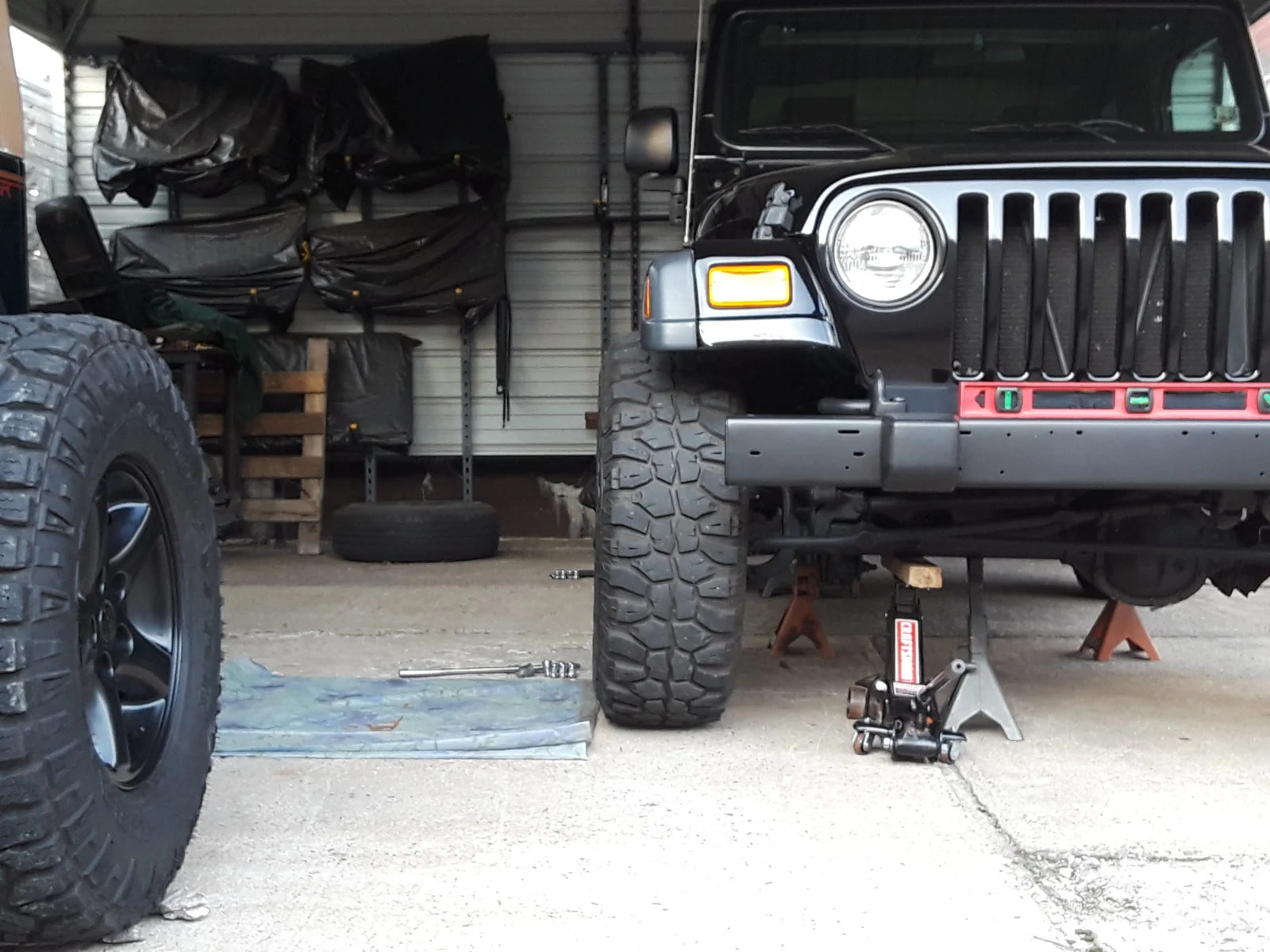

I realize this is an old thread but Im searching for a few days now and found exactly the thread I was seeking for info and knowledge. This is the set up that I have previously run on my YJ and JK. I now own a TJ and wanted to get this exact look. Chris what size tire and wheel are you running here in this photo? Is it the 16" Moab wheel with the stock Rubi flare?
I was hoping to do get a 285.75.16 size tire with the mr1x wheels but keep it under the flare or just have the sidewall stick out like this photo. But after trying a JK wheel and said tire size I saw it wasnt going to happen after I did the math. I think it would stick out 2" or so.
I cant seem to find any OEM 16" moab wheels for a decent price on craigslist so I was thinking on just buying new MR1X's.
Will I have to regear with a 6 cly. Auto trans? I think I have 3.73's in a dana 35(rear).
That's a factory Moab wheel with the stock Rubicon flares and 285/75r16 Goodyear Duratracs.
With that setup, it just barely sticks out from the factory flares. Enough to look good, but not enough to kick rocks and such up.
Would you happen to know if the factory moab is the same bs as the mr1x wheel? I think the factory moab is 5" and the mr1x is 4.75. Im not exactly sure though. I tried this with a JK 16" mr1x and the tire stuck out plenty with a regular factory flare on my X package TJ. Im worried that if I chose this Mud Claw tire in 285.75.16, which is very close in specs with the Duratrac and the factory rubicon flare isnt going to cover it. After seeing your photo it gives me hope again but Im still worried about pulling the trigger as I can return tires(that I know of). Do you know the exact width of the factory rubicon flare? Just looking for some reassurance that this will work for me with the mr1x wheel. What gears are you running in your rear?
Jeep flares are all different. The SE is a 2", the Sport, X 3" and the Rubi 4". That might be part of the difference. And I think all the TJ rims have a 5.5" BS.
Thanks billiebob. I wasnt aware of the differences on flare measurements between all TJ's.
Edit. I got in touch with Mamba and the bs of their wheels are 5". Getting somewhere now. :)
