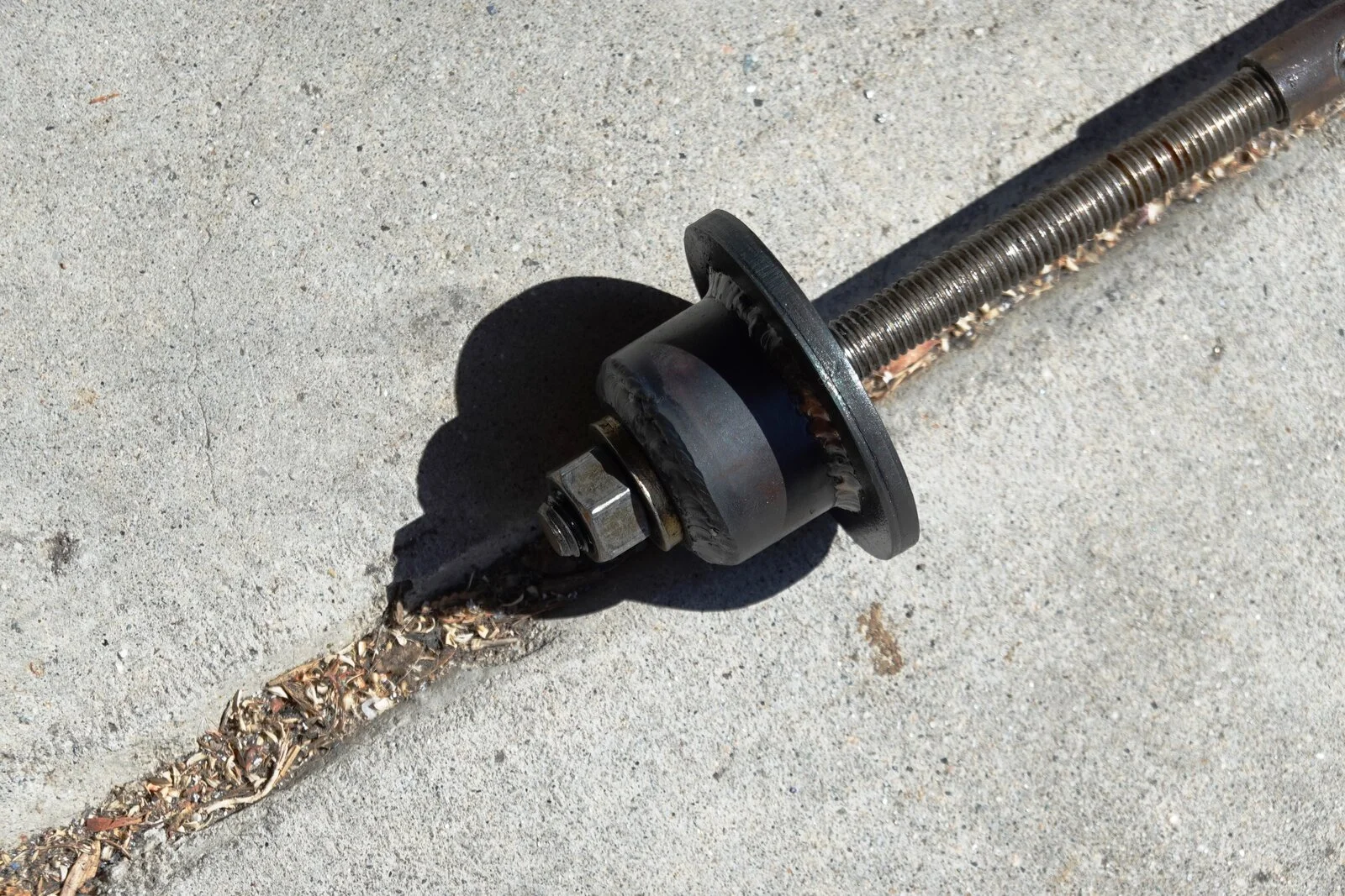

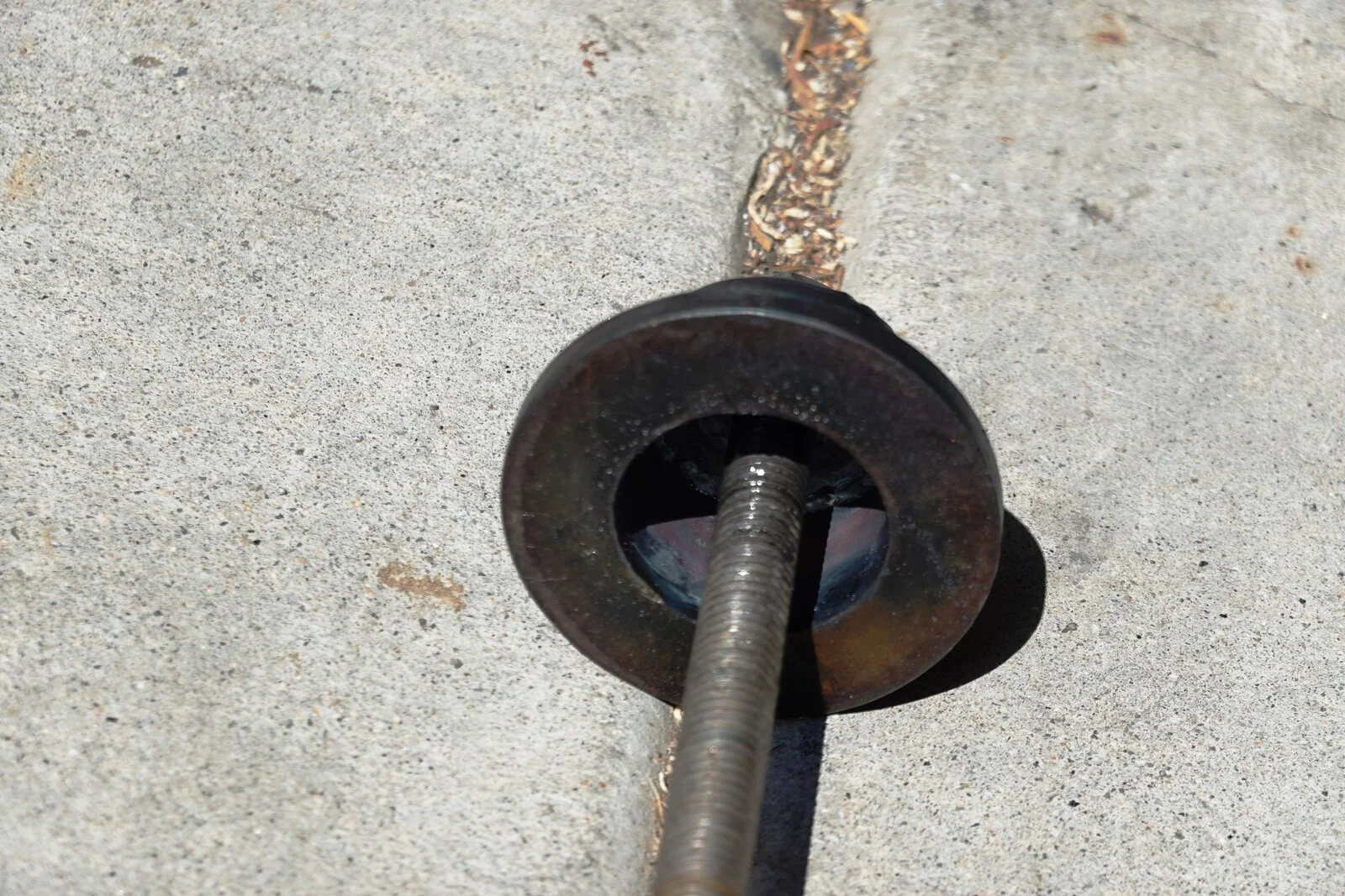

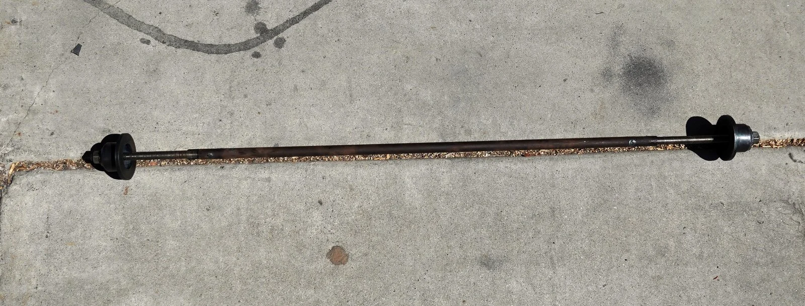

The best method we have found is to start a bushing on one end of the big bar after putting the lube in it. Stick that through the crossmember and get the bushing put on for the other end. Stick the tool through the bar, center the top hats, start cranking it in.
The bushings try to squish out around any flange that is smaller. The ID of the top hat is big enough to fit over the large bar. Depth is 1" total. Move and it doesn't work as well, less and it will bottom out on the bar before the bushing is seated.

I suspect you fully understand that if we found they went right in, we would not have spent the time to make a tool to install them. We got tired of trying to beat the bushings in, move the bar, beat it from the other side, beat the bar to center it and then have that push the bushing out.
MrBlaine, have gone back 4 pages and don't see a parts list for your 'tool'. Everything but the top hat washer/bushings looks easily sourced. Are you selling the top hats or are they a common part that everyone but me has in their tool box?? If I don't have a source for the top hats, which look beefy, will fender and successively smaller washers work as a substitute.

No parts list. The all thread rod is 1/2-13. We made the top hats.
