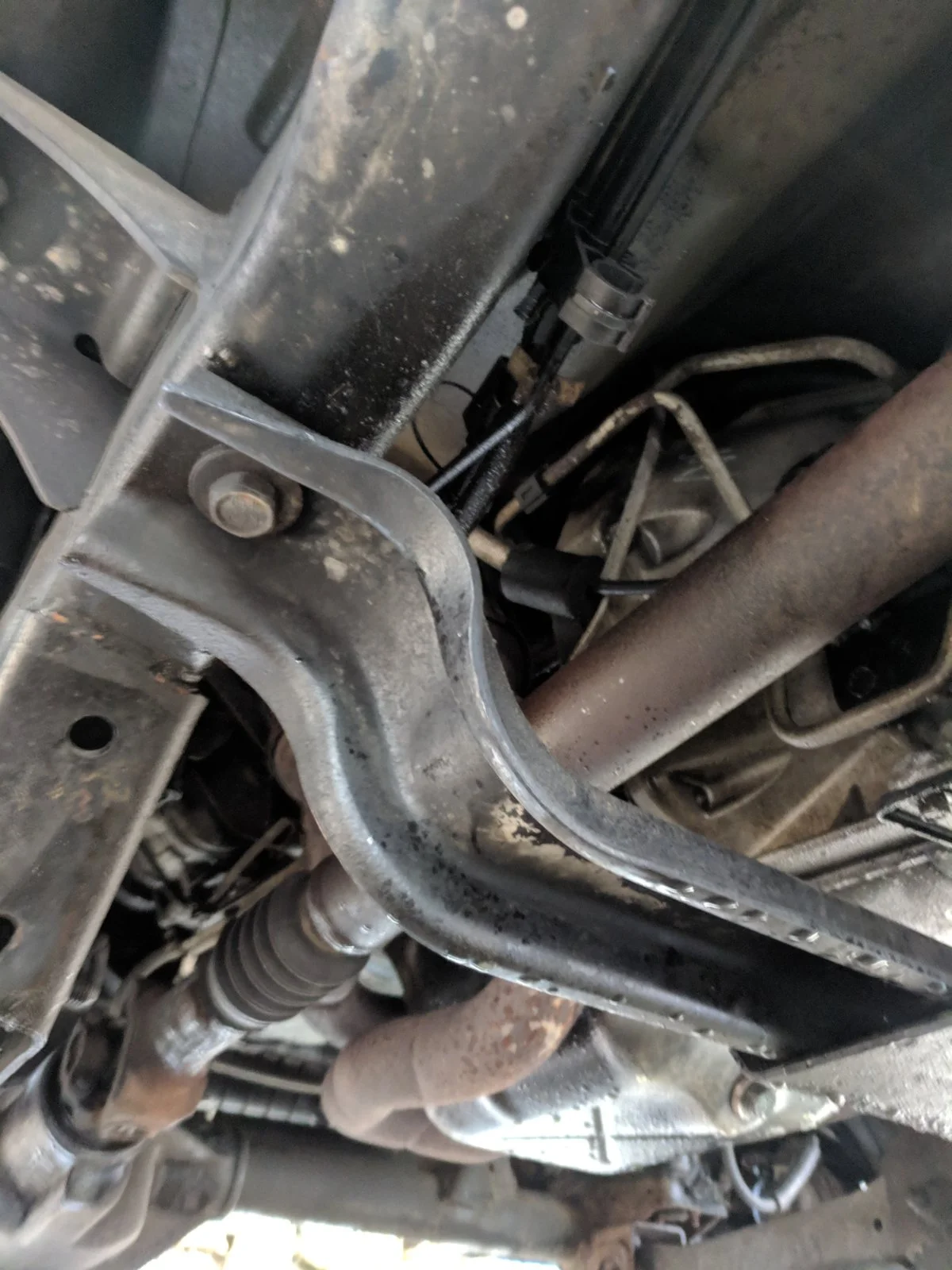

Can anyone comment on where they'd drill the front drain holes? I've got the rear finished near the lower control arm mounts but I'm not sure where to put the front ones in (auto transmission)

At the two low points of the frame on each side (so 4) drill drain holes. These are right by the control arm attach points.
I have some fairly superficial internal rust and what there is is right at those 2 low points and where the ski plate attached.

Yeah I've got all that, I think I have an additional bracket tho in front of the tranny skid because of the auto transmission. That bracket is bolted right behind the front lower control arms, the area you described. I'm wondering if it's safe to drill right between the two (where the frame dips and where that backet is bolted.
Adding a photo - I'm trying to confirm the recommended spot to drill the front drain holes. Can I go between this bracket and the front LCA mount? Or am I better off behind the bracket (between it and the tranny skid plate)?
Any comments appreciated....
