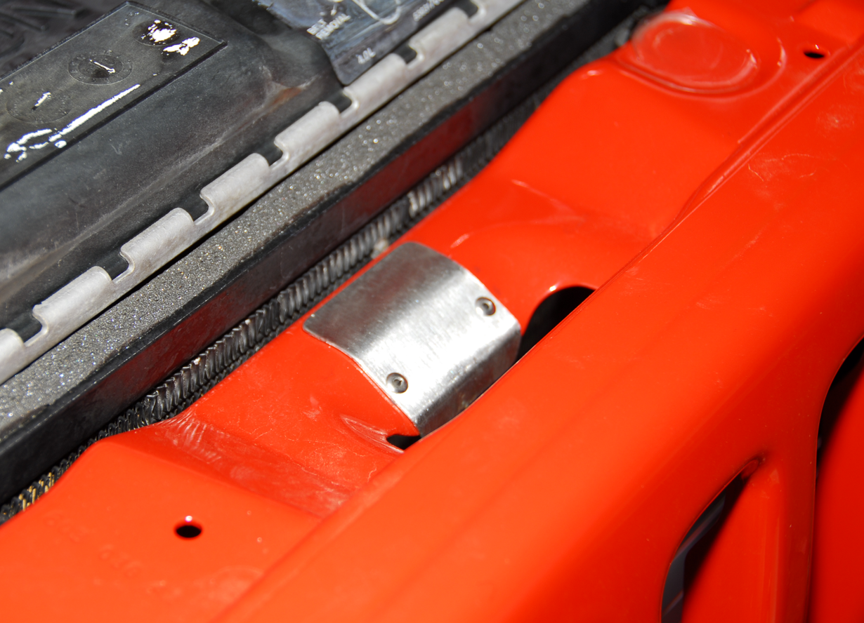

I am looking for a hood catch skid plate for my 1998 Jeep Wrangler TJ. Mine did not come with one, but most later models did.
The part number is:
55032768
SKID PLATE Secondary Hood Catch
6500787
RIVET M5x11.30
And this is what it looks like:
Does anyone know where I can get one of these, and the rivet?

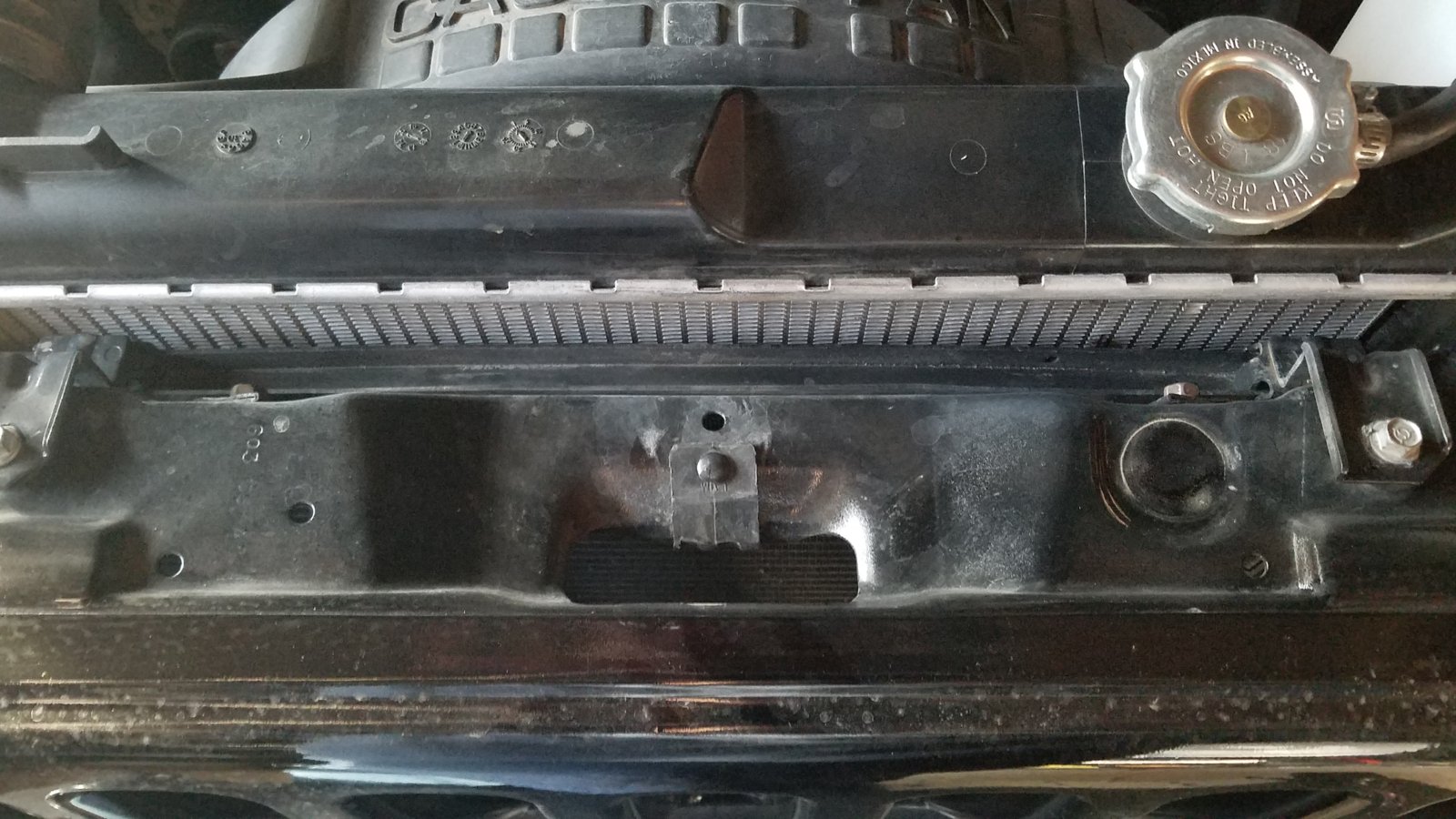

My ‘01 was missing this piece; I searched thru the Vehicle Parts Catalog and found the part number, but never did located one.
I fabricated the part using a piece of 1/16” recycled plastic container. thoroughly cleaned the metal surface, cut a piece of plastic and attached the plastic with some double sticky back HD 3M outdoor tape.
The piece has been installed for >3 years with no signs of loosening.
I 3d printed mine, but if it wears out I will laser cut and bend the new one.
