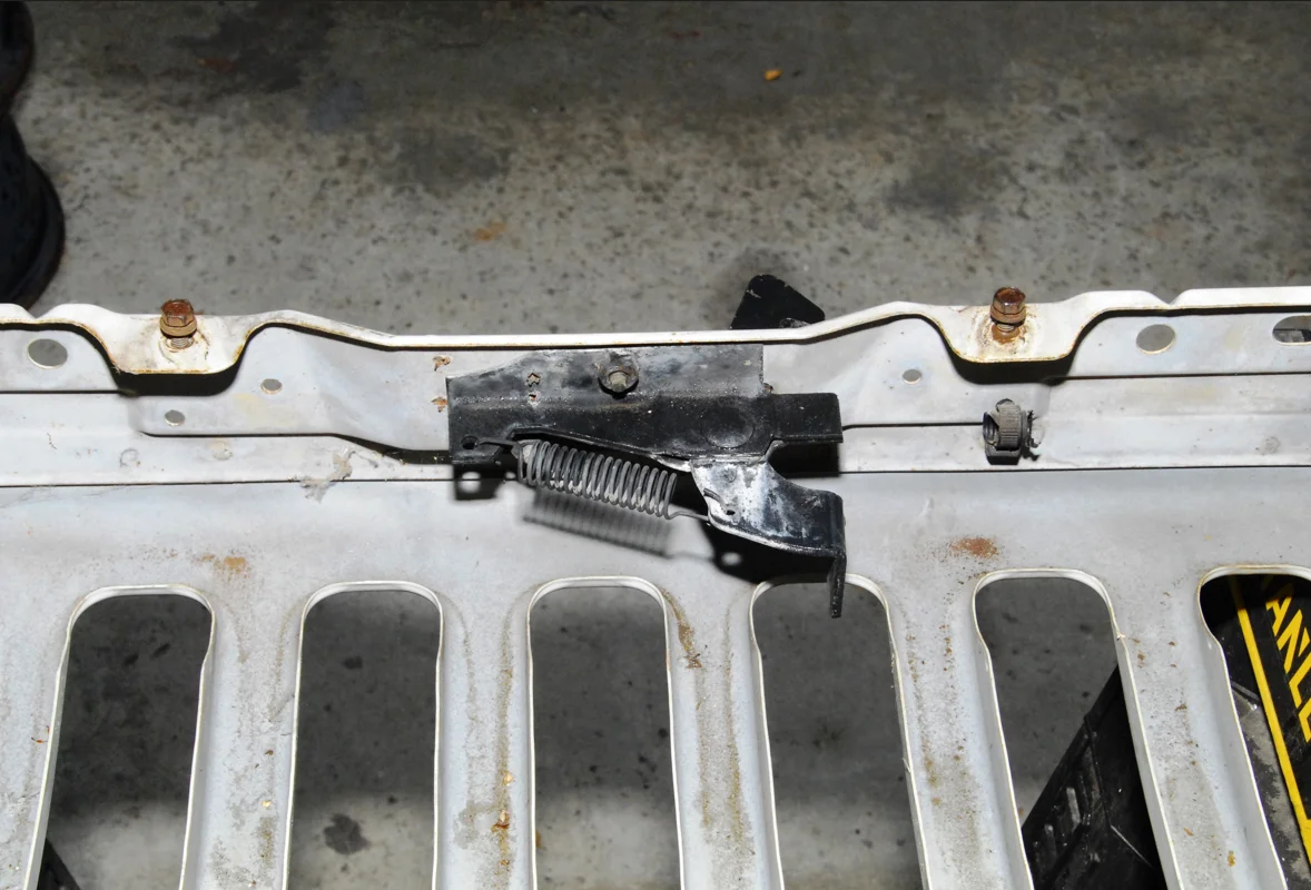

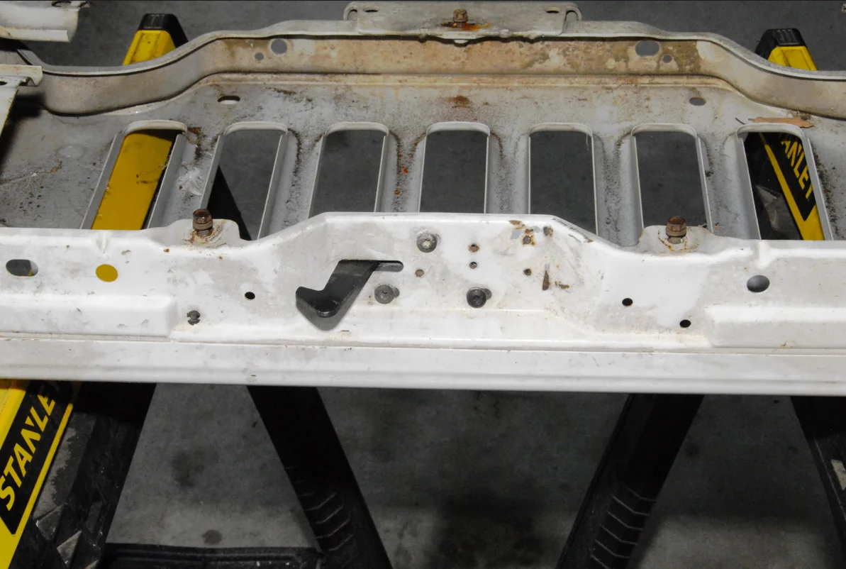

Yes and no. The early 97 grill has the safety hood latch in the grill and it hooks into the hood exactly the opposite of all the later ones. Someone may have swapped in a 97 grill and there is nothing for it to latch to in the hood. I don't recall if the later hood mounted safety hook will even close on that grill though so a pic or two is in order.
