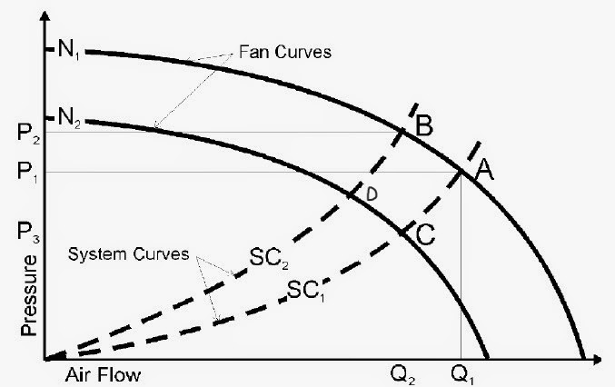

However - all things aren't equal. If you double the core thickness and keep the fin spacing the same, you'll double the airside pressure drop required to pull the same volume of air through it. The fan however has a performance curve and will provide less airflow at increasing pressure. You end up with a line that slopes down to the right for the fan and down to the left for the radiator, and they operate at the point where the lines cross.
This image illustrates it where the "system" curves are the radiator. You could think of SC1 as the stock radiator and SC2 as the hypothetical thicker core, and think of one of the N curves as the stock fan at a given speed. Intersection point C is where the stock setup operates, and with the thicker core you move to intersection point D.
Note the pitch of that fan curve and how it flattens out to the left. That means as you approach the maximum pressure capabilities of the fan, very small changes in pressure can have huge changes to air flow. Since I didn't select the cooling fan for the TJ, I have no idea where we even are to start with on that fan curve....if we're out farther to the right we might not be too sensitive and not lose a whole lot, but if we're already in the flatter section, we could lose a LOT. The impact of reducing the airflow means that you're trying to distribute the heat into a smaller mass of air, which means it heats up more as it passes through the radiator and that affects the dTlm I described in the first post. You lose some of that while you gain surface area, and the result may be that you gain nothing, you gain a small amount (but less than proportional to the gain in area), or you could actually lose some cooling system performance.

The N1 vs N2 curves as shown above would be analogous to increasing the speed of the same fan or scaling it up in a way that maintains the geometry. It will generate more flow and more pressure as you speed it up, or less flow and less pressure as you slow it down. Different fan designs change the shape of the curve entirely, which could make it flow more or less than the stock fan at different pressures.
This begins to go off on a tangent but this plot actually compares the different curve shapes for different types of fans. You can see an axial fan, which is what an automotive cooling fan always is because of it's form factor, is the worst at dealing with higher pressures. This is why you see the hamster wheel looking fans (mostly "forward curve centrifugal") in pretty much any application that involves more than just a heat exchanger...if there's any ductwork at all, that drives the system curve steeper and you need a better fan to push/pull through it.
