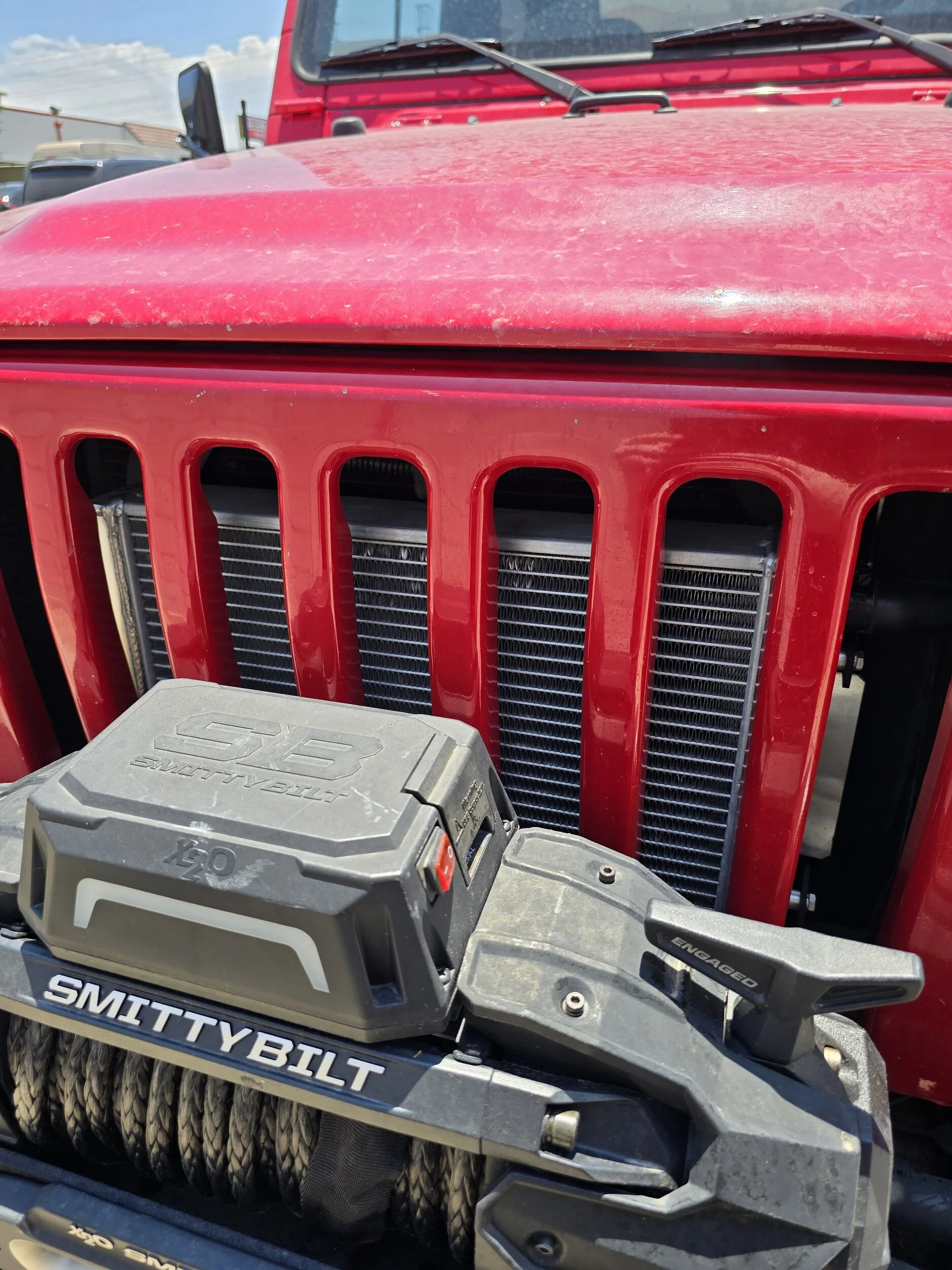

Update: I got the fan installed and everything wired up. Seems to work great after going through the code with AI and working out the bugs. Its currently pid controlled with P:5 I:0.2 D:0.2 target temp is set to 185. The fan seems to be proactive with the temp increase from revving it up. It currently likes to sit at 205 with the outlet a little above 185. I'll have to do more testing before i'm comfortable with it.
