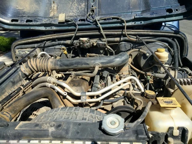

Hi guys I am just looking for a bit of help! I’ve let Jeep sit for a few years and now I’m finally able to drive it but the engine bay is caked up with dirt and oil! I need the safest way to clean such a mess! Anything will help !

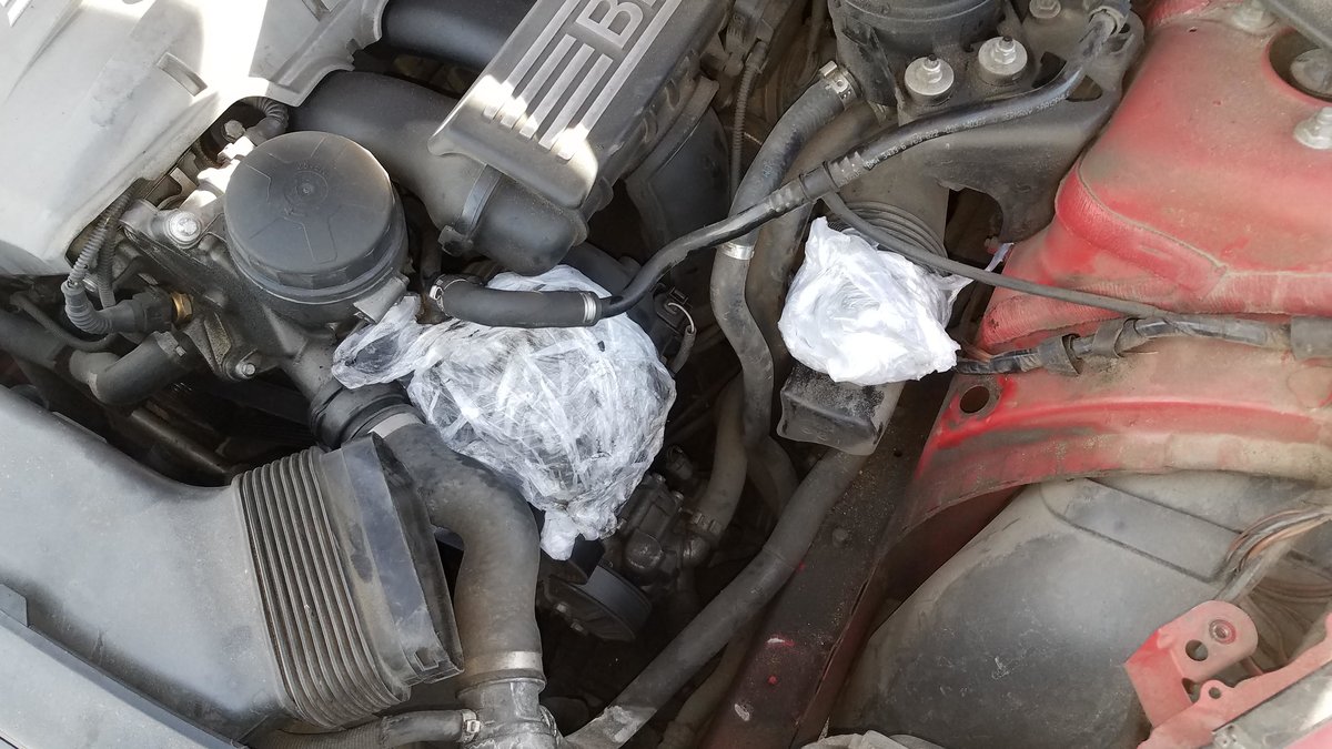

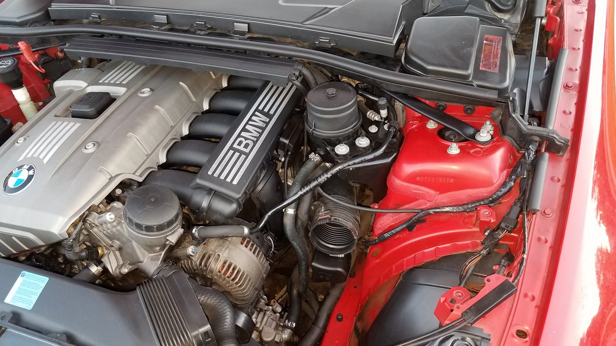

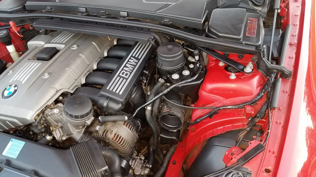

Here is what I do:
1. Cover the alternator and PCU with cling wrap.
2. Spray entire engine with degreaser (either simple green, or Meguires Super Degreaser diluted 3:1) and let soak.
3. Starting in small sections, agitate using a variety of brushes and rinse with the garden hose. No pressure. Continually spraying more degreaser, agitation and rinsing until clean.
4. After final rinse, I blow dry with a AirForce Blaster Sidekick Car and Motorcycle Dryer (leaf blower works well).
5. Spray a dressing (Sonus Motor Kote or CarPro Pearl). Our Jeeps don't really need a dressing, looks better on other vehicles.
Here is an old BMW I bought last summer. The gunkiest one I have cleaned. Took about 2 hours following what I described above.

Here is what I do:
View attachment 145047View attachment 145050
wow that looks great 👍 I am impressed!!
