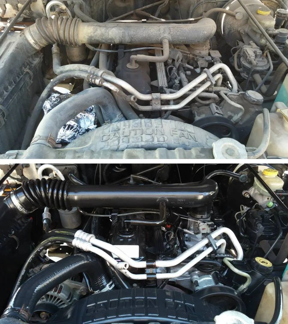

I did zero scrubbing on this job.
And covered in shiny shit that will attract dust and dirt again. If you need to get black finish back, use a water based product like carpro pearl. It should be matte black, not Tire Wet tire shine
Agreed. I use Carpro Pearl diluted 3:1 or Sonus Motor Kote. I prefer the Sonus but Carpro is also good. Spray it on a don't touch it.
