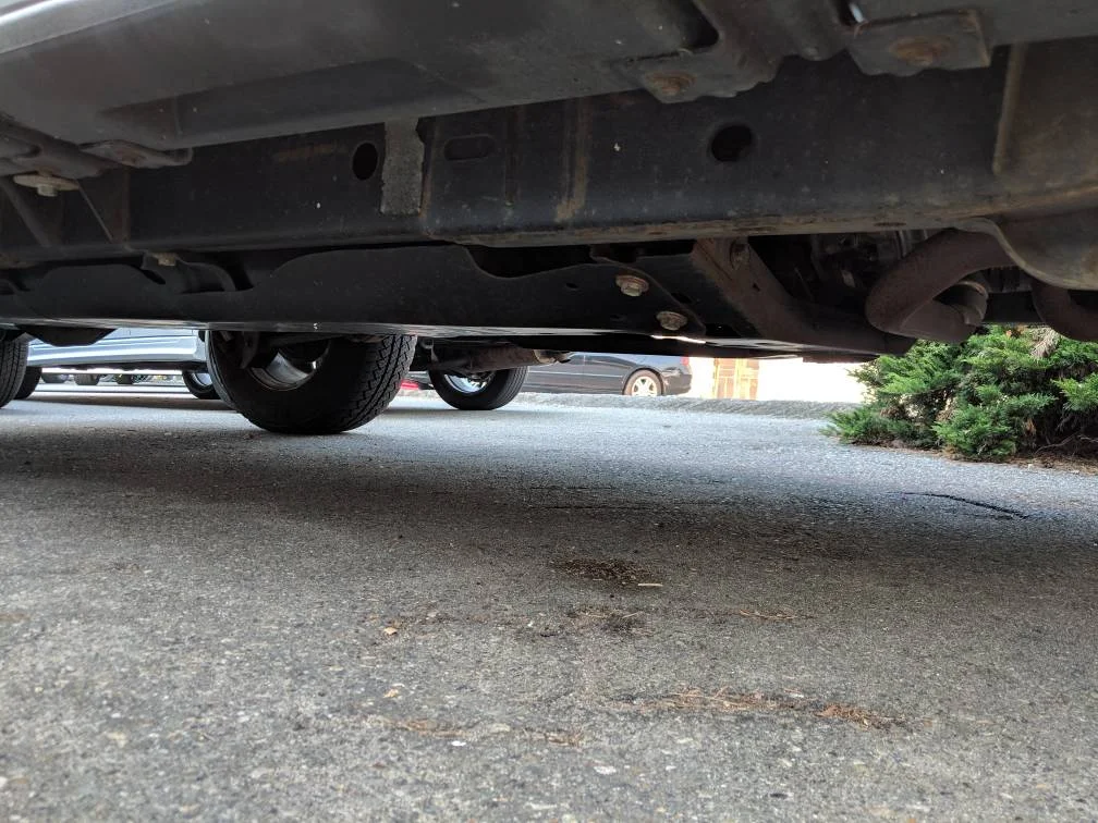

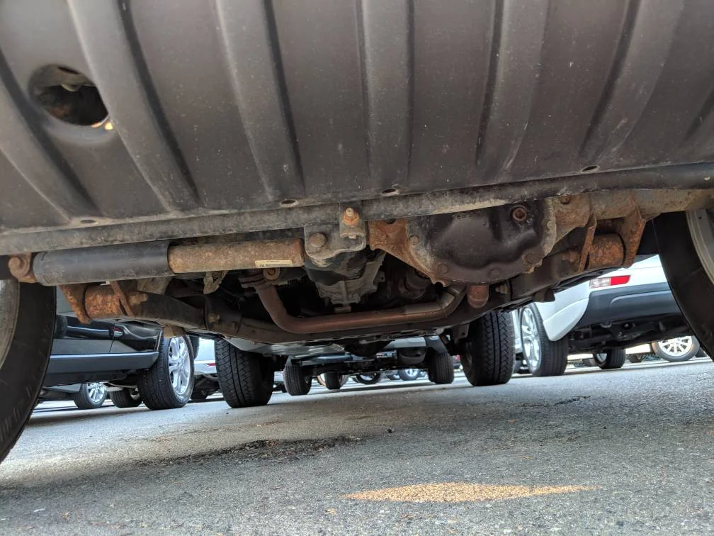

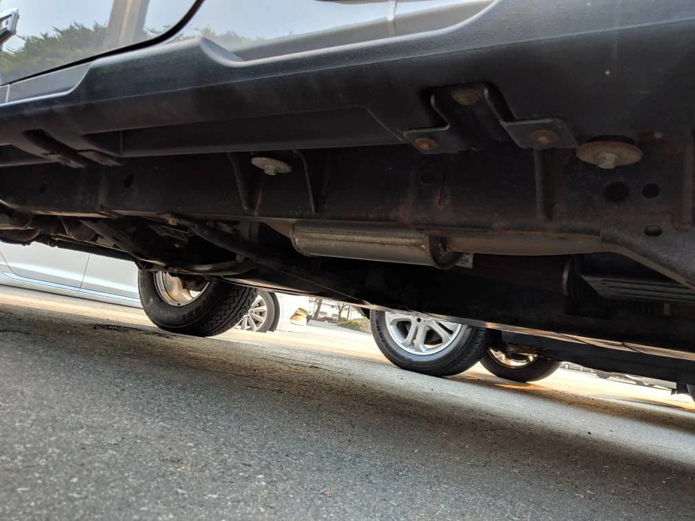

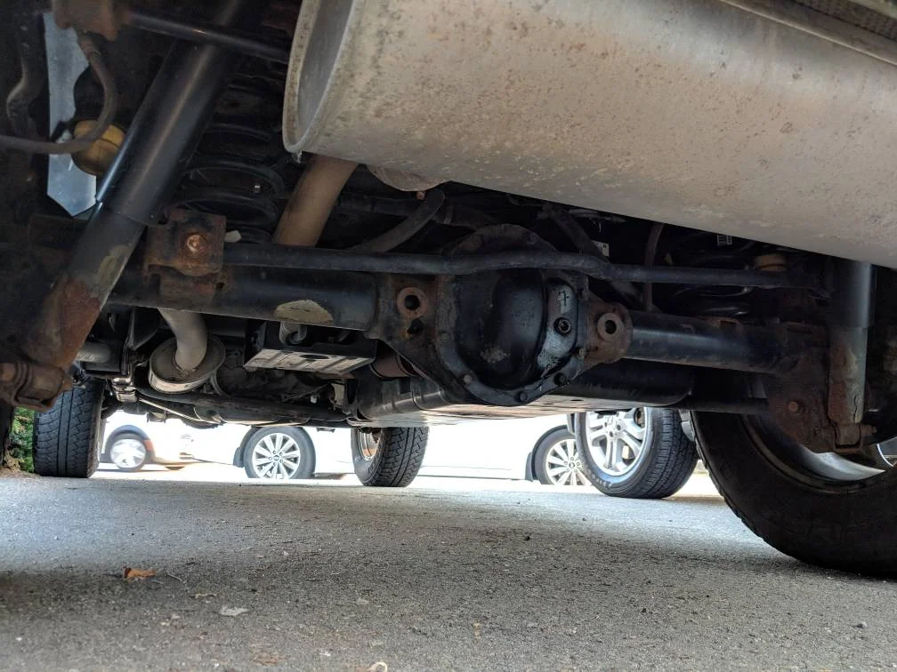

I used Eastwood internal frame coating back on the inside of the frame and just last week fluid filmed just about everything underneath I could see, minus the brakes.
Hopefully it will hold up. My plan for next year is to put a drain hole in before the rear frame arch.

Ya the later model TJ' s had additional holes drilled in the arches. The earlier frames did not. I drilled 5/8" holes in my frame which is what the hole size is on the later frames. They are 5" behind the lower control arm mount on the front, and 5" in front of lower control arm mount on rear. When i drilled mine the front drivers side hole leaked water out instantly.
