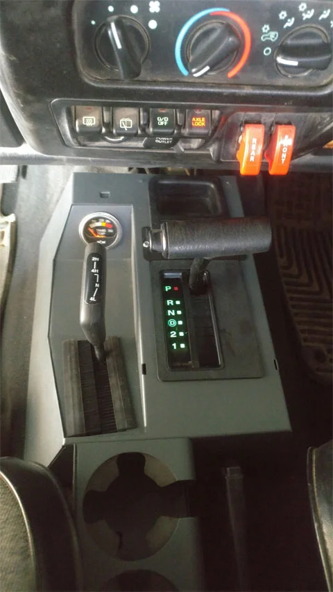

By the way, I am not afraid to install aftermarket gauges when warranted. Like my automatic transmission temperature gauge below in front of the shifter. I have installed tachometers, oil pressure, and charging system gauges but the standard TJ temperature gauge is plenty accurate for me. :)
