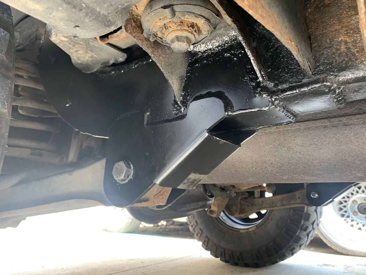

The actual cost for the two caps is around $900 I think, from Auto Rust Technicians. (https://www.autorust.com/product-category/jeep/jeep-tj/) You'll want the full-length caps almost certainly as you likely have rot near the rear control arms. You can also get caps from Pocono Metal Craft, and they're a bit cheaper, but I can't speak if the quality is comparable. If installed right (i.e. cutting out ALL of the existing rust), they will outlive the rest of the Jeep. The reason the frame rotted out is because the factory did not include drain holes, so water and salt pooled inside over years and years. The caps do come with a drain hole, so you should be set.

If you don’t mind my asking, were the caps about two grand like was mentioned above? I would be willing to drop two grand if I were fairly certain those would hold for several years. It would be cool to work on this jeep with my son, so like I said, almost anything that isn’t the frame I don’t mind messing with and replacing myself. I just need the frame to be safe. I have an arc welder, but I guess since I haven’t used it in two years, I’m not going to be using it.
I wouldn’t recommend doing it at home. Each patch was $550 in the center, he CNC cuts his own and welds in. Each rear control arm was $400 with the SafeTCap provided. Axle was $500 for both lower control arms and $450 for the spring perch.
