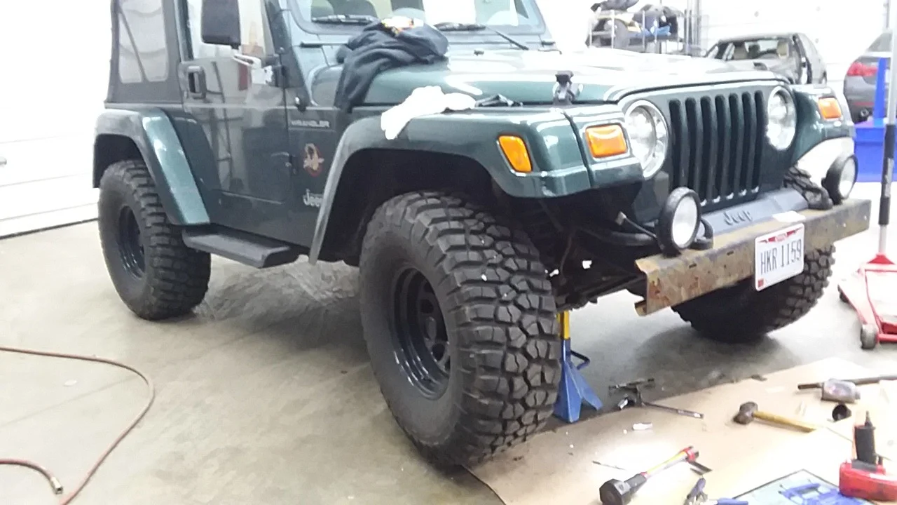

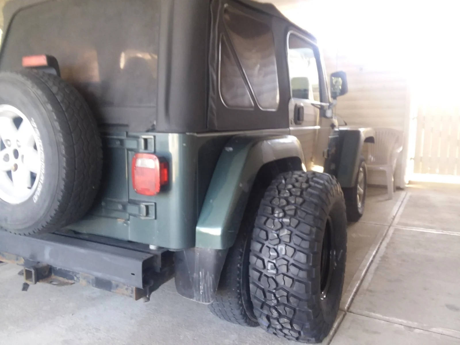

Just as the title says. I've seen I can measure my coils. 12" front 8" rear. I'm on 33s with no rubbing at all.
How much lift (if any) do I have?

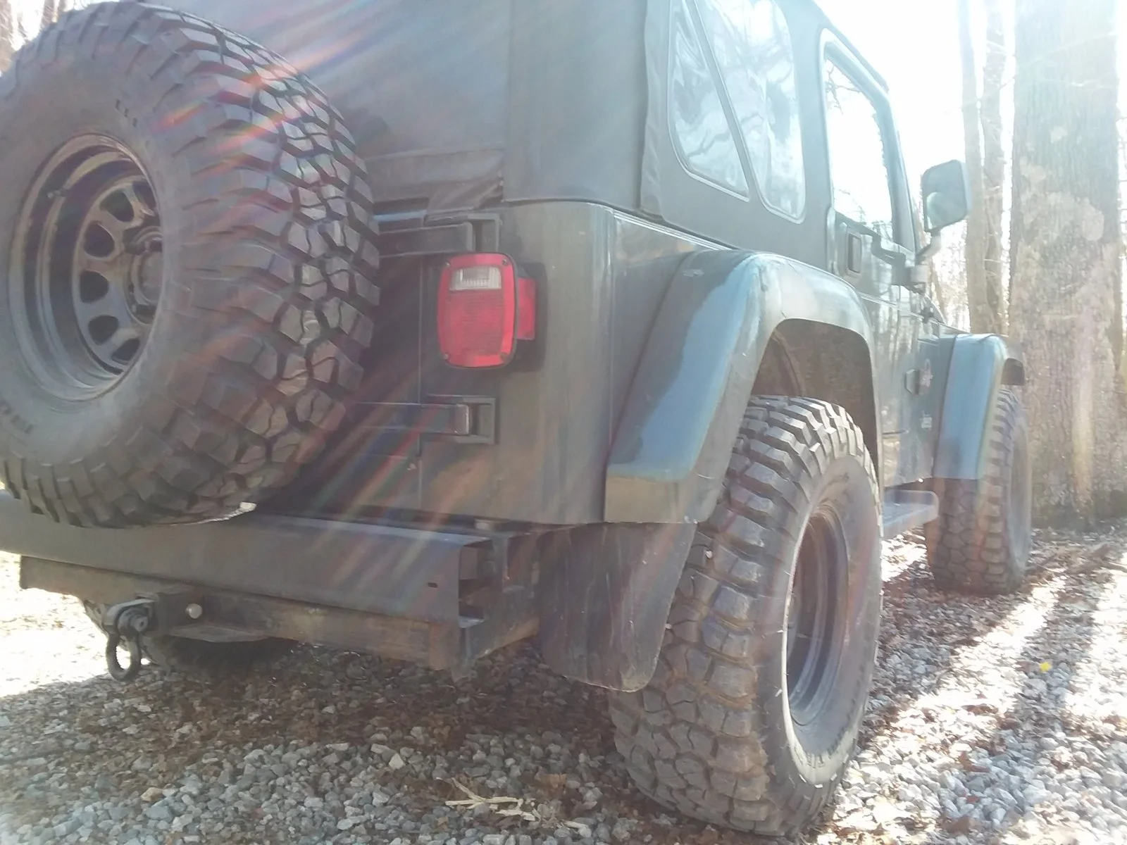

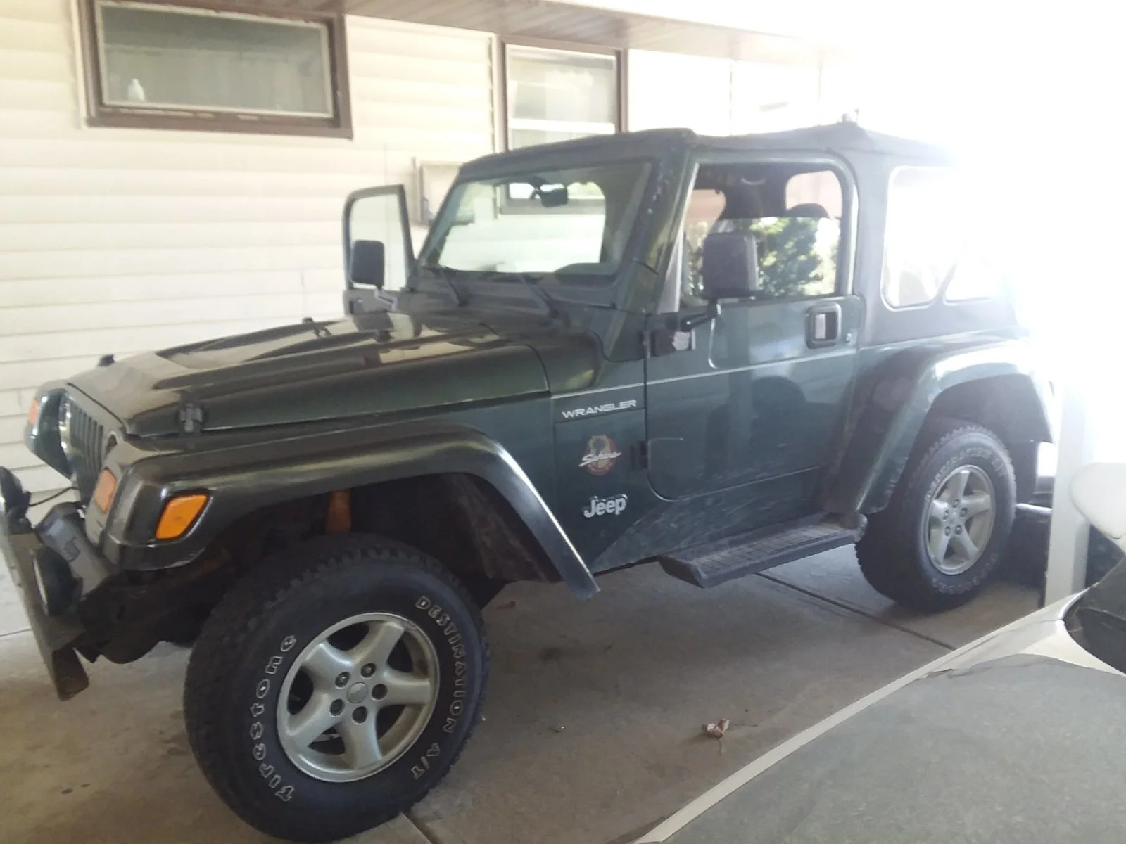

You have some sort of highline fender kit. Might even be an AEV, which is extremely rare and extremely valuable. Makes sense considering you are able to fit 33's with no lift.

Yea. It's a Sahara. It has 4.10. The Dana 44 rear. Tires are 33x12.5x15. No rubbing. It rides great. No driveshaft vibes either. But I swear it looks like I've got 2" on it
Guy said someone replaces the whole front end aftermarket due to rust. Frame is straight. My dads a body man for 30 years. Says no wreck damage. The different front end is for sure look
You have highline fenders which allow for bigger tires without any lift. That looks about right for an unlifted Jeep with 33's and highlines. If the whole front end was replaced due to rust, how is the frame? Have you stuck your fingers in the holes near the rear control arm mounts?
