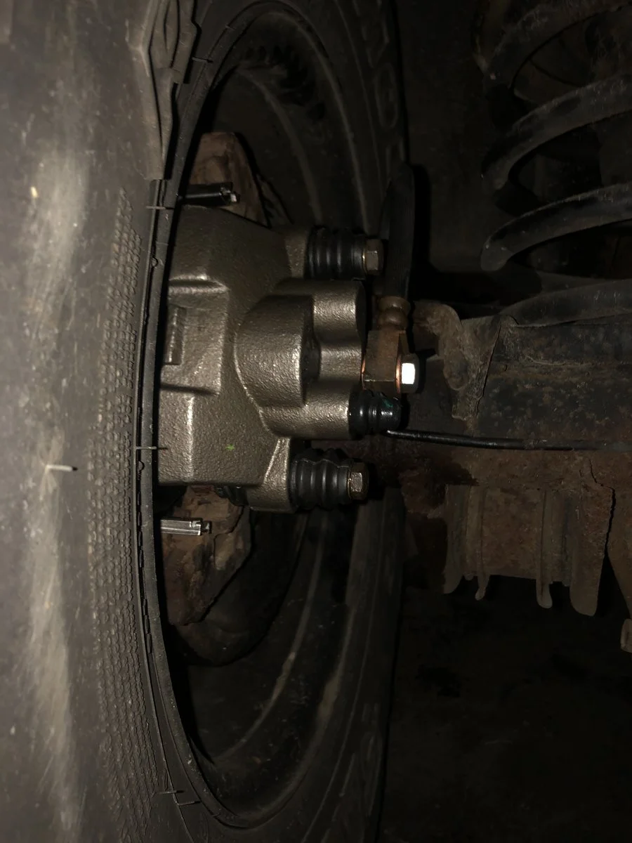

So I have just replaced my rear calipers pads and rotors and I also just replaced my master cylinder and I made sure to bench bleed. But I have bled the brakes all around with the two person method but my brakes still go to the floor? Do I need to use this vacuum bleeder because I’ve heard it’s hard to get the air out of the abs lines. But when I’m bleeding the brakes there is no air coming out of the lines just fresh fluid. Also my brakes have always been really squishy and went to the floor and I wanted to fix that so I but a new master cylinder in but now they are worse. Please help lol. Thanks
Start with making sure the bleed screws are on top and report back.
Not on the bottom.
So do I have the calipers on the wrong side? And why would the matter?
