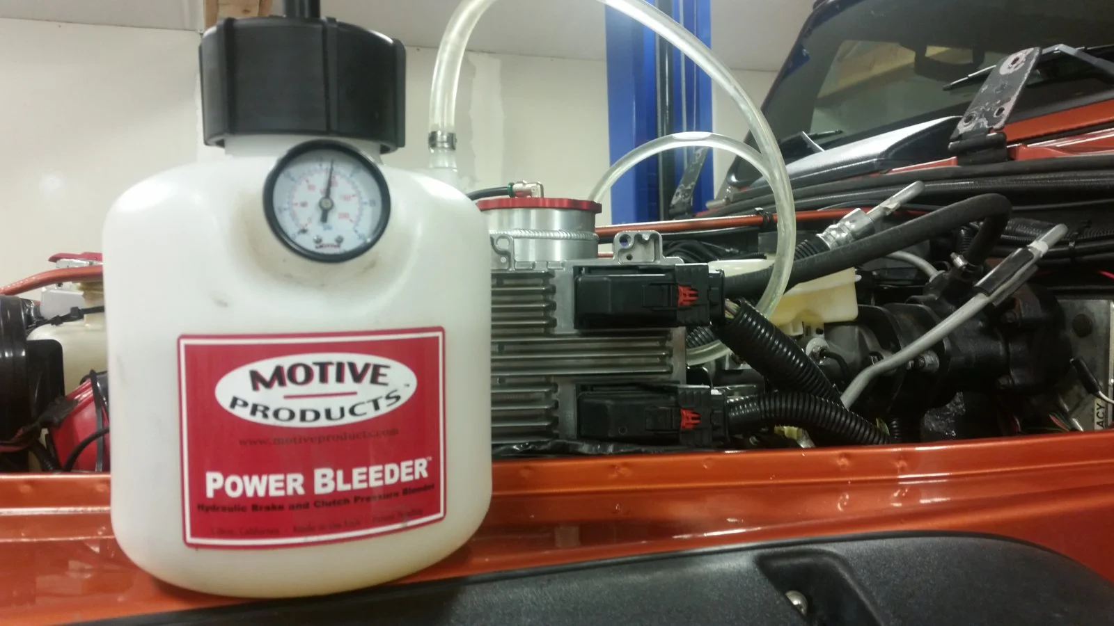

I've thought about getting one of those Motive power bleeders, mostly because allegedly it would make bleeding one man possible. Holding me back is they say right on there website about air bubbles in the line going to reservoir, I'm afraid I'd introduce air from the start.
If I go old school, I guess I'll have to wait until I have a helper who won't complain the whole time, that could be some time.
Reactions: Kenneth G Zinis
Mine works well.
Did you get the model with the plastic cap or aluminum?
I got plastic. You also need to get a model specific master cylinder cover of each different type of cylinder. I maintain 7 vehicles and rarely can find a helper when the time comes. This thing was a God send for me.
