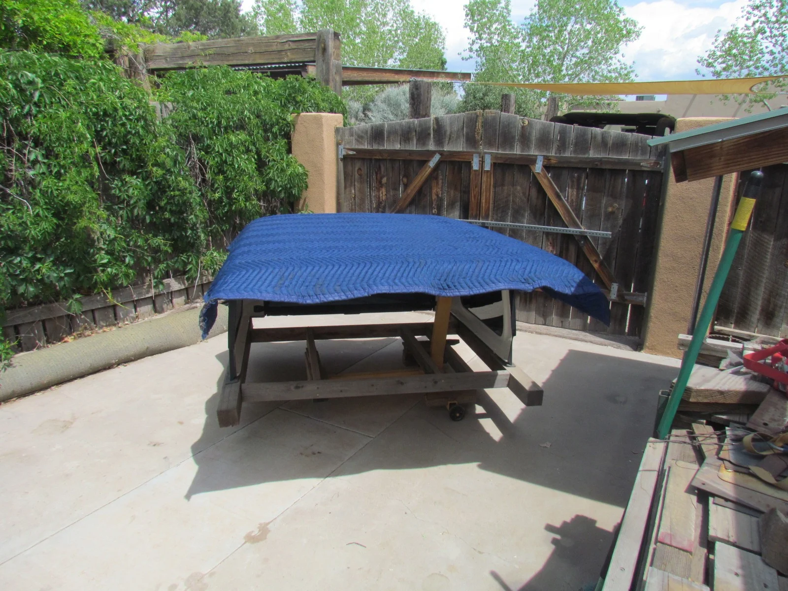

Built this cart and cover, basically just a roof overhang off the side of a Tuff Shed finished into a separate room:

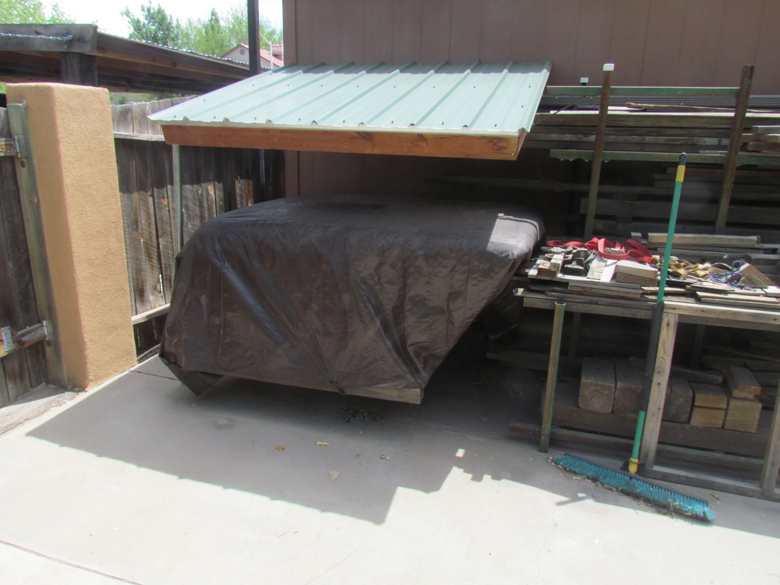

Hard top covered with a blanket and tarp, stored under the roof for the summer:
