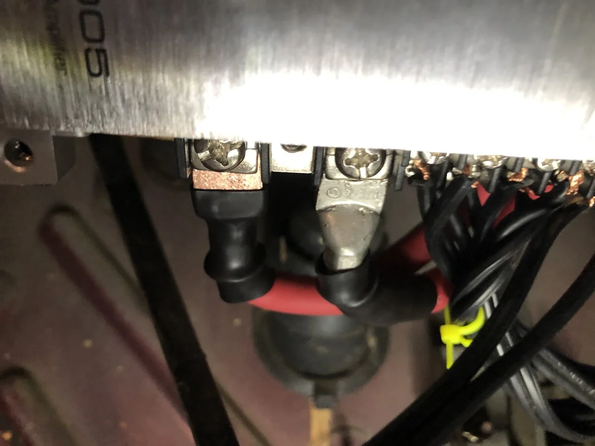

I had to bend the L brackets in half and put it in place and then bend the brackets back up to get it on the bolts. It was super annoying but eventually i got it. I heated up the tubes and it seemed good, then I came back and i'm not sure it even did anything. I did keep the brackets bent at like a 75% angle rather than 90 so it gave me more room in the front. I did end up losing a little bit of tilt function, i can still put it all the way down but i noticed the board that i put the amp on was starting to bend. I generally like my wheel on full tilt down but i think i'm going to get seat risers so it should be fine. Either way, super happy with the turn out. Now i just need to finish upgrading by battery cables and installing my speakers and i'll be bumpin down the road!!
Reactions: Akitadog
That looks good!
Thanks! went through the grommet behind the block, thought it came out pretty nice. Wires were a little close to eh break linkage but i think it'll be ok. Also said screw the fuses, and went with a breaker instead! only every blew out 2 amp fuses in like 12 years but can't hurt right? gonna put one more below it for my inverter.
