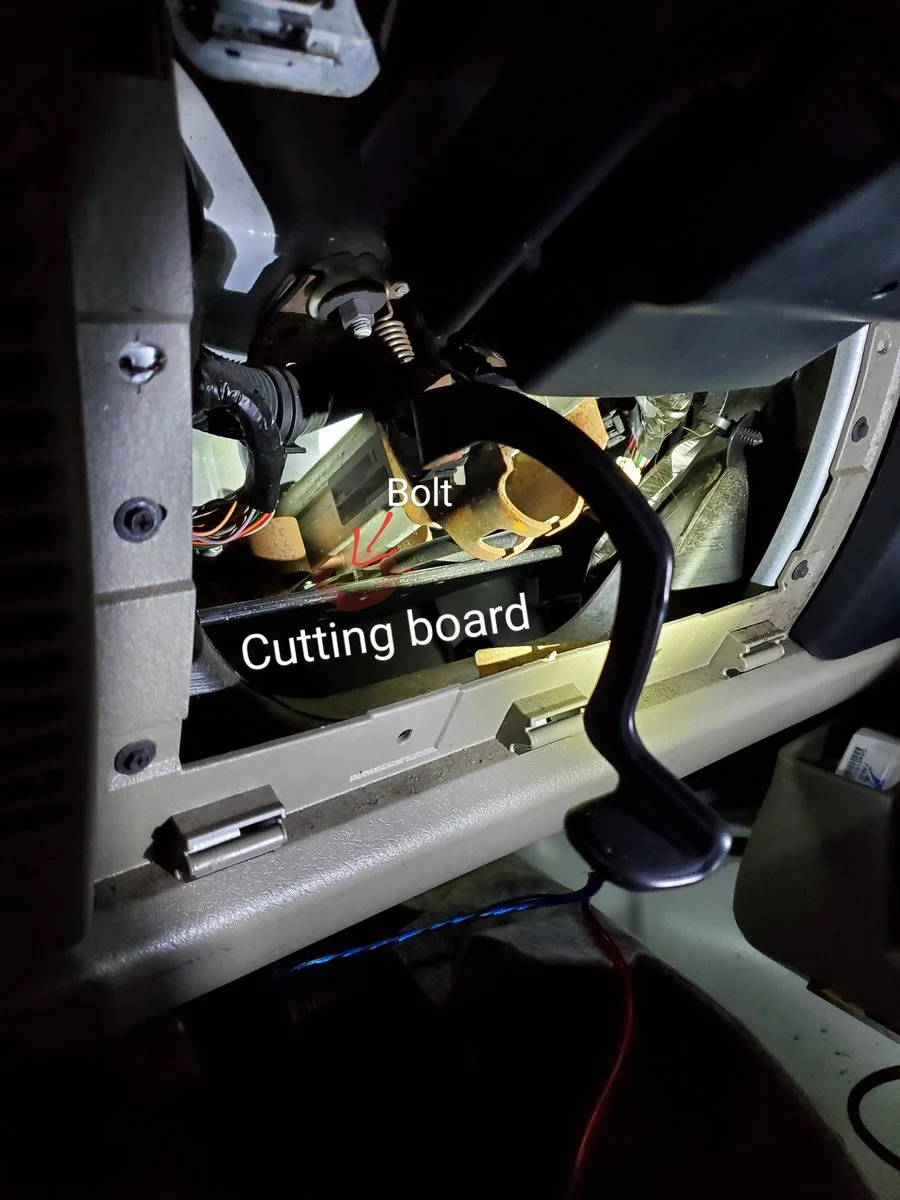

I created a mount using a cutting board. I trimmed it to size and drilled the mounting holes for the amp. I also drilled a hole in the center of the cutting board to mount it to an existing hole in the steering column.

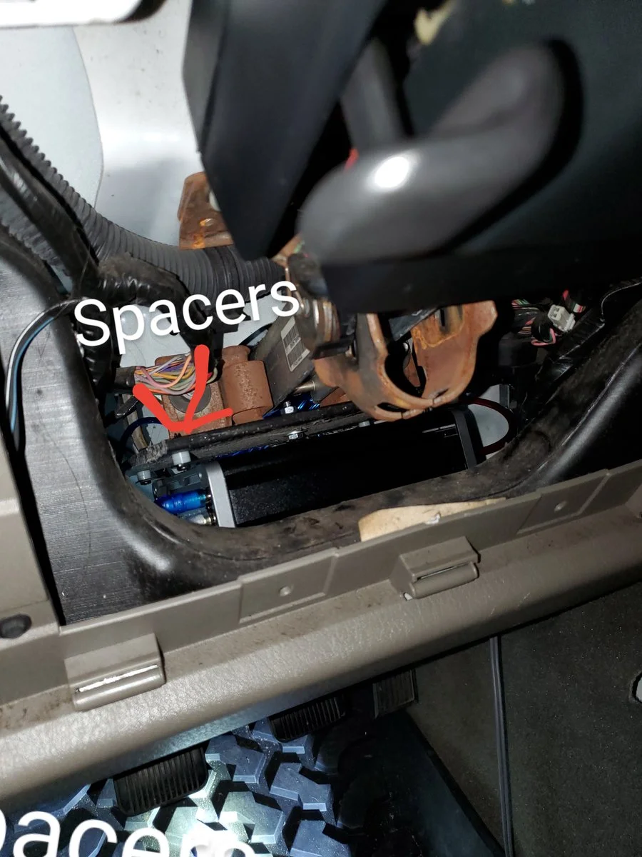

I then screwed in the amp onto the cutting board using little nylon spacers so it would clear the bolt.

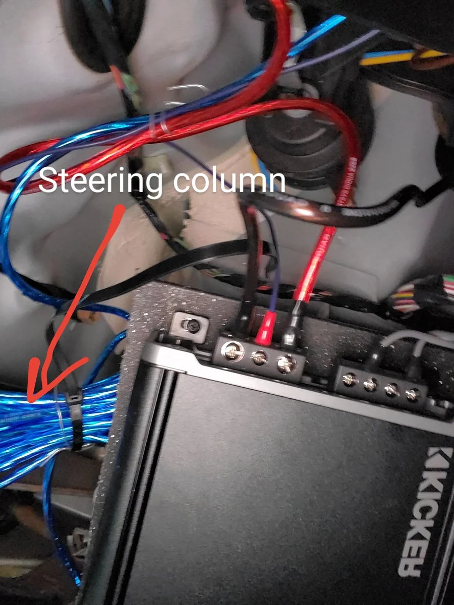

I zip-tied the long RCA cables, which I couldn't cut directly to length, to the steering column.

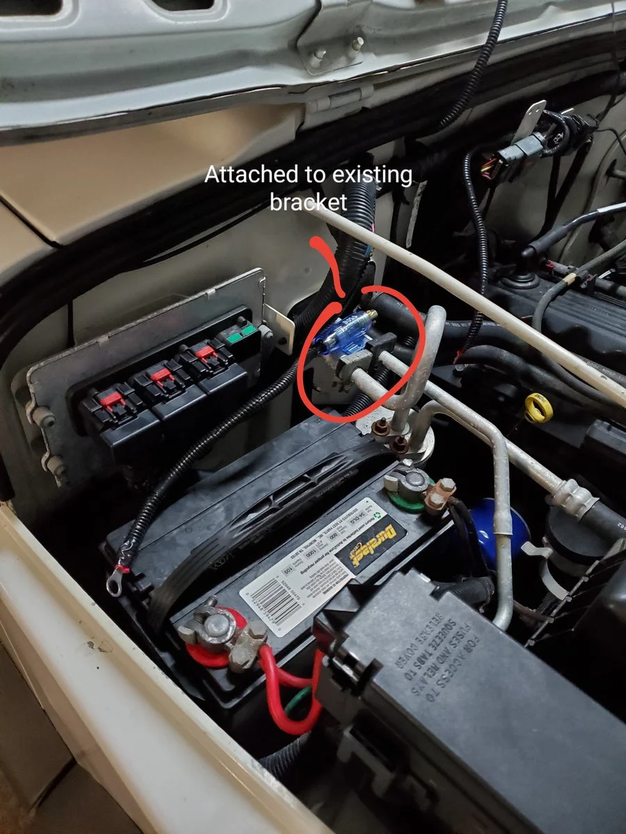

I mounted the fuse onto an existing bracket right next to the battery. I found a #8 bolt fits perfectly into the existing bracket.

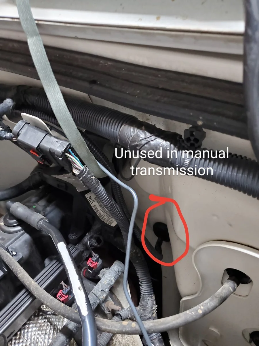

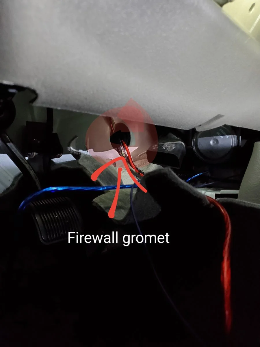

To go through the firewall I used an existing hole normally used for the automatic transmission. I have a manual so it is just a plugged up hole in the firewall. I drilled a hole in the plug for the cable. A replacement part can be bought for about $8; part #2424864.
Here is the same plug (now a grommet) from the inside.
