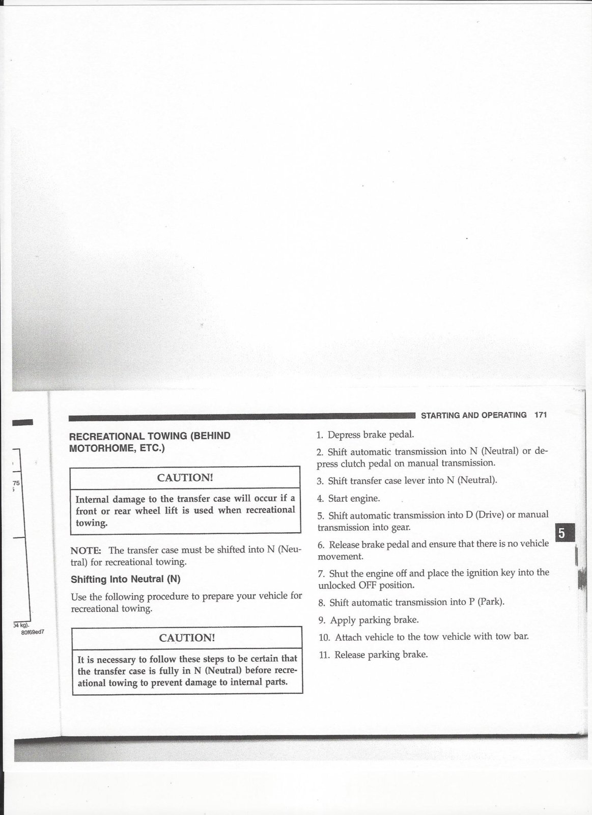

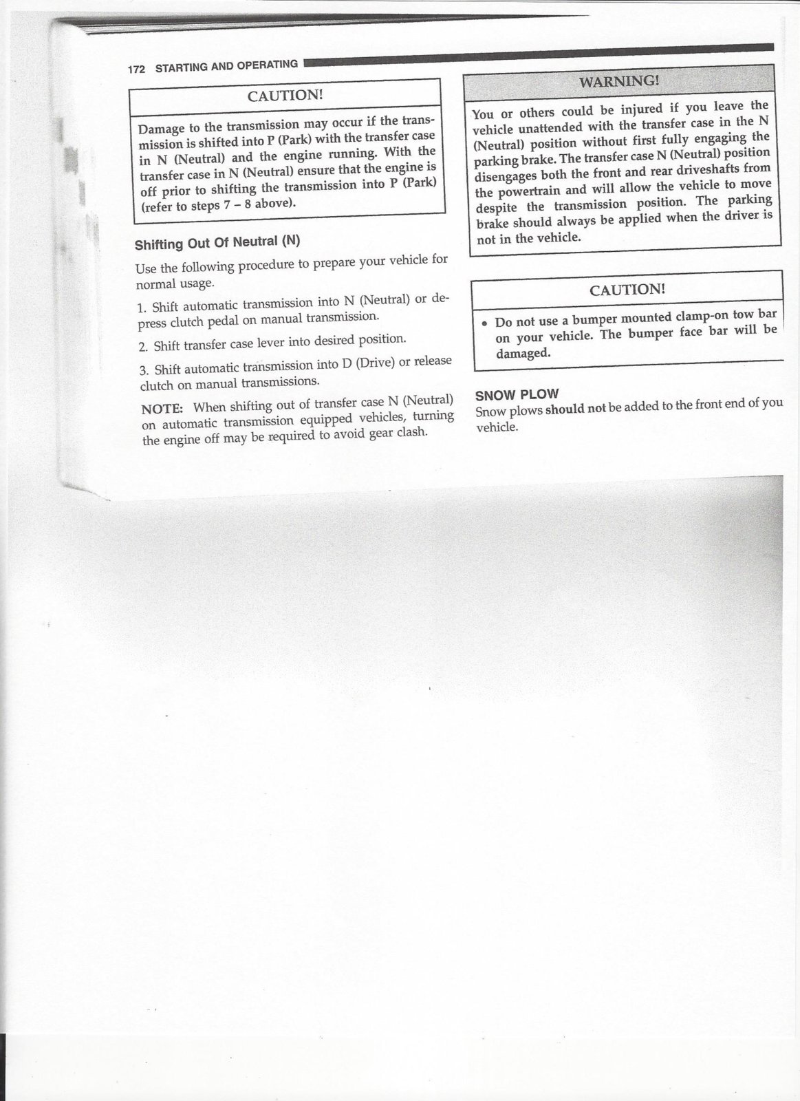

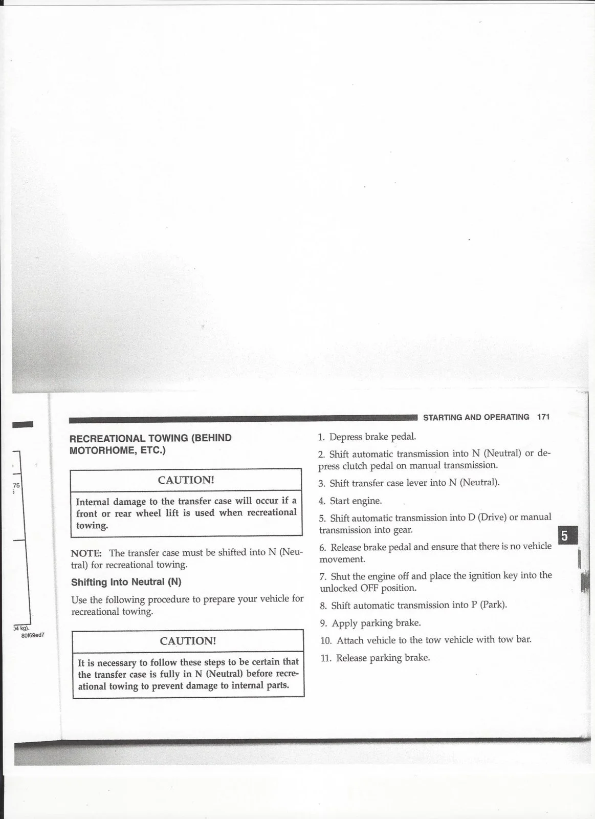

Transfer case is in neutral, so the parking pawl (what keeps the thing from moving in part normally) won't actually stop the wheels.
Interesting. I just assumed if it was in park the transmission wouldn't be lubricated.
So is the OP wrong for stating that an automatic should be in Drive? It should be in Park instead?
