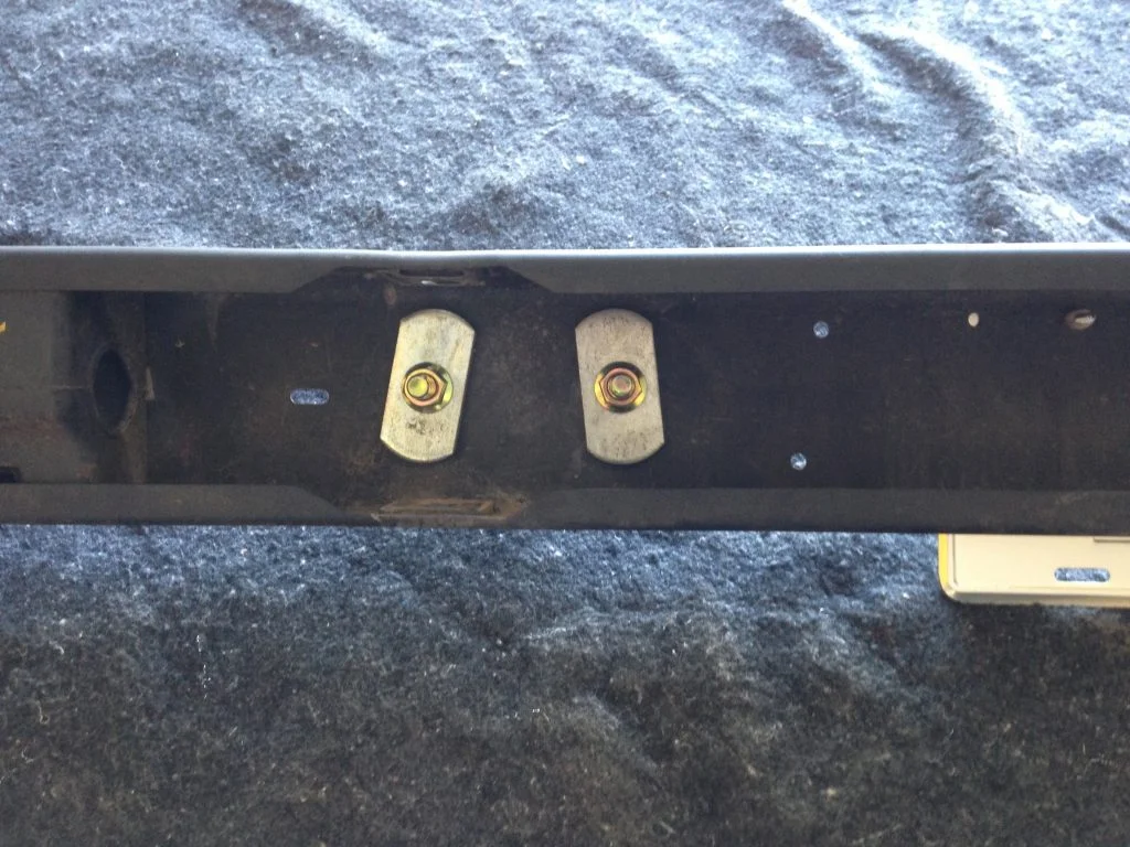

Installing the tow bar brackets on my Jeep’s OEM bumper was pretty simple. First, the bumper had to be unbolted from the Jeep using a T-55 torx fitting. Before installing the brackets you’ll first need to remove the two bumper pads from the bumper (if you’re lucky, like me, you’ll be able to use the existing bumper pad holes for the tow bar brackets). The installation instructions state that the tow bar brackets should be mounted between 24 and 41 inches apart on the bumper and mine are centered about 35 inches apart–perfect! Some TJ owners question the strength of the 1/8 inch thick bumper and its ability to support bolted tow brackets and withstand the forces that will be exerted against them. That’s a valid question and one I had, too. No, the bumper metal isn’t very stout, but if you reinforce the backside of the bumper with support plates, such as the ones that were included in my tow bar kit, you’ll be fine. Many TJ owners who have gone this route over the years have towed for thousands of miles with zero problems.
Backside of bumper showing the backing plates.

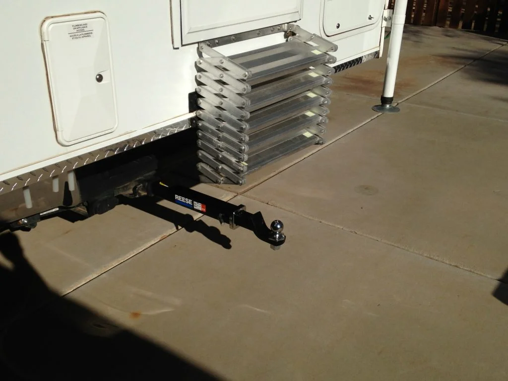

Hitch Box Extension
This piece of towing hardware isn’t needed in all cases, but it was for me as I usually tow with a truck camper which extends two feet beyond the rear bumper. I decided on an Reese 18 inch long hitch box extensionView attachment 7117. With both the hitch and extension installed, the total length from the rear bumper to the hitch ball is 26 inches. Along with the tow bar’s length of 41 inches, this provides me with the required amount of clearance between the Jeep and camper even on sharp turns. Here are a couple tips when choosing your hitch box extension and hitch. First, if you need an extension with a length greater than 40 inches, you’ll want to make sure that the extension has support chains to prevent side-to-side movement (this may require that a special plate be welded to the extension to accomplish this). For the hitch itself, you’ll want to make sure that the hitch ball is the correct size and that the shank is large enough to support the weight of your Jeep. You’ll also want to ensure that your tow bar is fairly level when hitched up, especially if a supplemental braking system isn’t being used. Doing so will improve handling and stopping.
The Reese Hitch Box Extension and Hitch.
