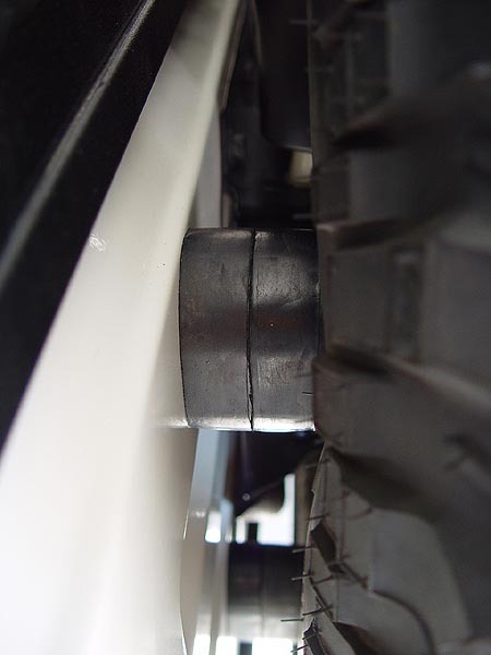

Okay, so you just got a set of bigger tires and new wheels with less backspacing to match. You go to mount your spare tire back on the tailgate carrier and what do you see? The tire no longer touches any of the rubber isolators. Well that no big deal right? Wrong! It may not be such a big deal if your Jeep is a pavement princess but if you just threw on a set of bigger meats, I'm gonna guess you take your rig out on the trails. Without your new and bigger spare making contact with the rubber isolators on the tailgate, the entire thing will jiggle hard with every bump you encounter. Eventually, this will cause metal fatigue in the tire carrier and it will break.... believe me, I have seen it happen.
My solution? Re-establish contact between the spare tire and rubber isolators by extending them.
Does it work? It has worked for many of us, myself included. Your stock tailgate should typically be able to handle up to a 33" A/T tire (M/Ts are heavier) before you need an aftermarket bumper with built in tire carrier, or an Exogate (the latter being my preferred choice).

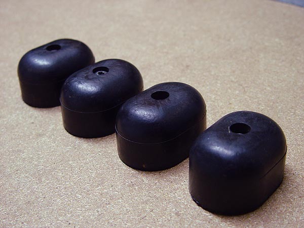

  1. Before you can do anything, you will need to track down a used set of tailgate spare tire carrier rubber isolators. I suppose you could buy them new from the dealer but I would be willing to bet they ain't cheap. I bought mine off Amazon here.

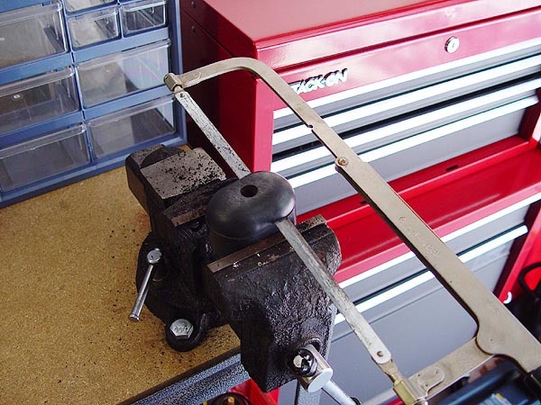

  3. Once you got all your pieces together, clamp down a rubber isolator in a bench vice and cut it in half along the seam using a hacksaw as shown in the pic to the left. To get a clean cut, I found that it helps to make a light cut all the way around the entire isolator first and then hacking straight through it. Repeat process on all the rest.

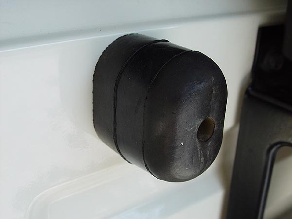

  5. Remove and replace the screw with a new and longer one and then, stack your OEM isolator on top of one of the ones you just cut down.
  6. Screw the whole thing together onto your tailgate and repeat process.
  7. Re-attach your spare tire onto your carrier. You should now have a tight fit again and much less jiggling.
