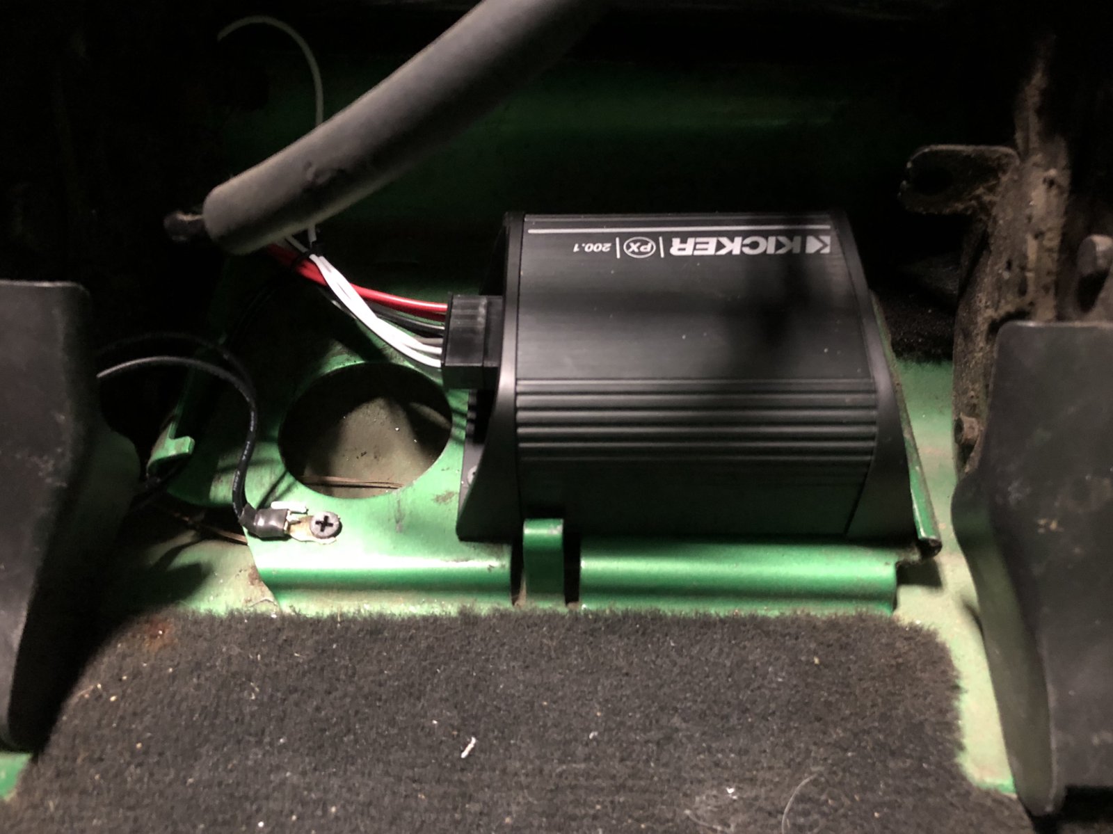

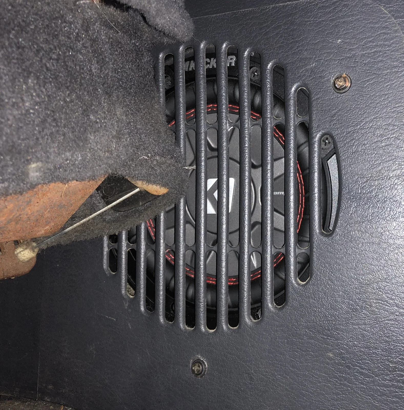

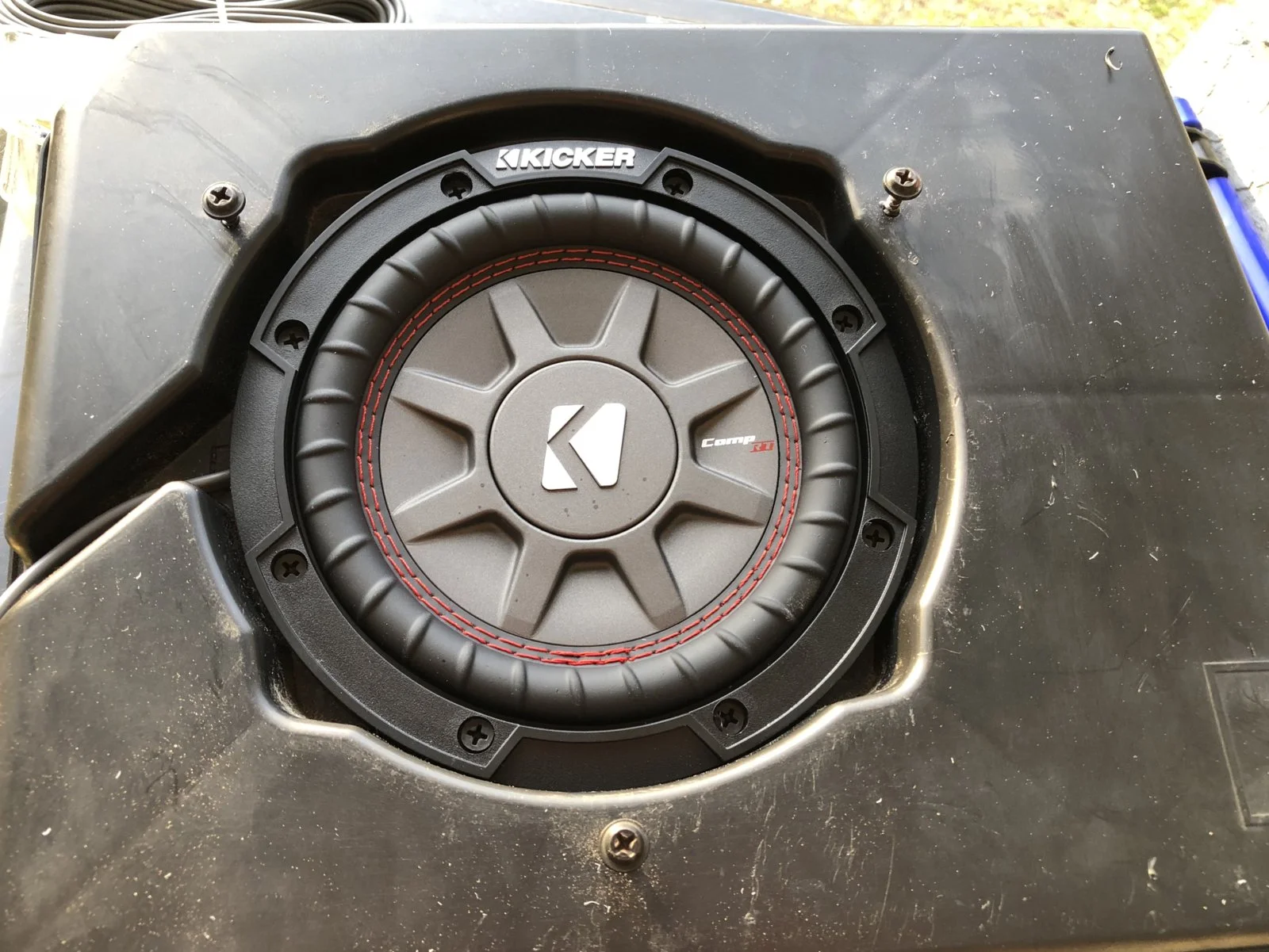

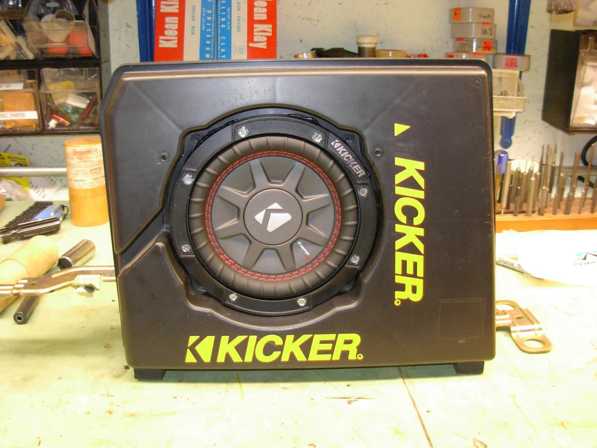

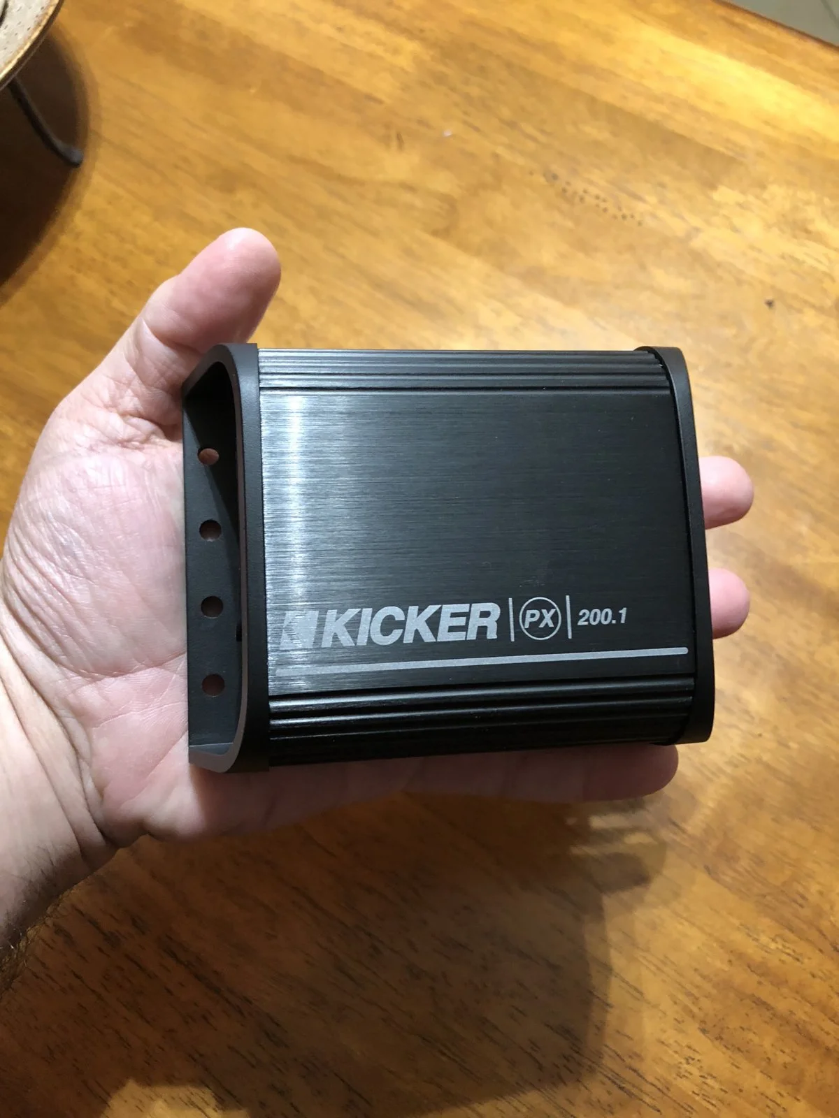

HA!!! It's funny that I found this thread this morning...I ordered a Kicker CompRT 6.75" DVC 2 ohm sub and a Kicker PX 200.1 mono amp and they arrived yesterday. I spent a couple of hours doing this exact thing last night!! I never would've thought that you'd get a decent sound from such a small sub! It isn't ground pounding but it is exactly what I needed to balance everything out in the TJ!!!
A 6.75" fits perfectly in the factory sub enclosure and the amp fits perfectly underneath the passenger seat, where the jack would normally mount. Both the sub and amp are weatherproof and are designed for ATVs, motorcycles, etc so no danger in the rain damaging them (I am usually topless/doorless (even in cold weather)!
The sub is a dual voice coil so I used a Kicker wiring diagram to wire both coils to the mono amp (I have attached it for reference.
The amp was $49.95 (Amazon) and the sub was $79.95 (Amazon). I also purchased a BOSS Audio 8 gauge amp install kit and it was $18. A local stereo shop wanted, (are you sitting down?), $935 plus tax to what I did in two hours!!!

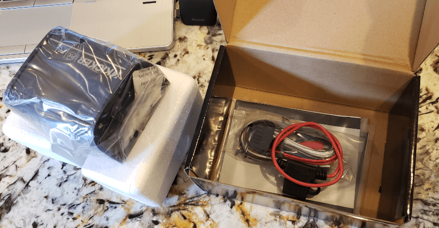

The amp has been SOLD. Thank you Ron!!If anyone is interested, i have a Kicker 200W PX200.1 amp. I bought it when i was troubleshooting my factory sub-woofer. I wound up finding a loose ground wire to the sub-woofer wiring harness. So, i never used it or returned it. I bought it on Amazon for $100. I'd be willing to sell it for $75 + however you want it shipped. I literally opened the box and made sure the contents were all there. I never even unwrapped it from the internal packaging. It's just sitting on a shelf in my office collecting dust. Email me if you want it ([email protected])
