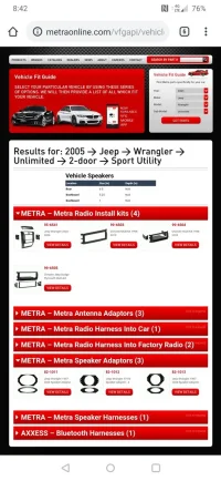

What is the part number for those adapters that connect the speakers directly into the OEM speaker connections? Looking for a quick and easy speaker trade out.
If you order speakers through Crutchfield, the adapters/mounts come for free.
You can find part numbers here, select your Jeep year and type.
http://metraonline.com/vfgapi/vehicle/76678?

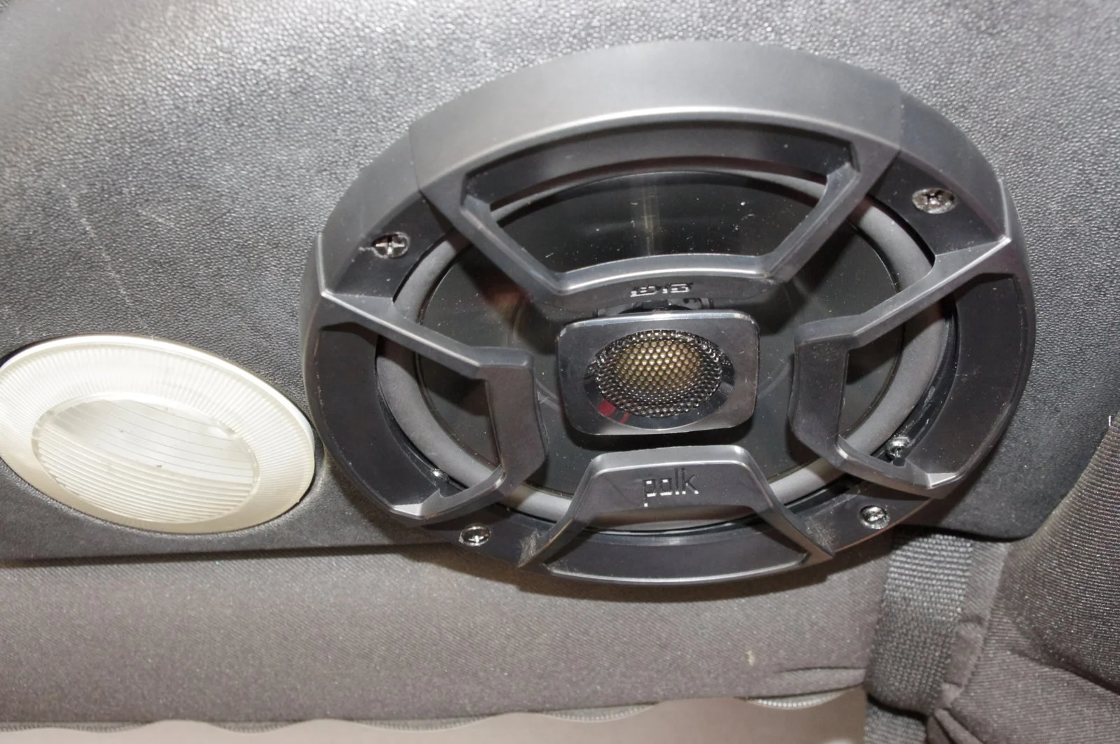

Simply connect the harness and mount the new speaker in the factory opening. The 6 1/2" does NOT sit completely in the opening. It actually mounts on the outer edge of the OEM opening, but the Polk Audio speaker cover, covers all of the mounting screws.
How did you get the speaker mounted to the sound bar? The 4 holes for the old 5.25" don't exactly line up with the 6.5", nor does it quite fit in, even after the dremel.
I'm guessing you just used the new 6.5" cover, and screwed that straight into the plastic of the sound bar? I'm trying to do that, but it's going in kinda crooked, and not all of the screws are taking to the plastic.
This is how mine came out - similar Polks - I have the 6.5" component speakers instead of the 6.5" coaxial, but same difference...

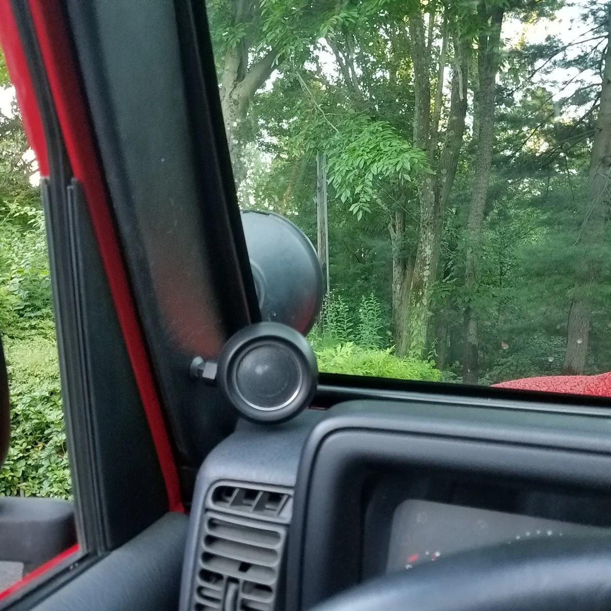

The best upgrade I have made is relocating tweeters to the a-pillar trim, and using name brand tweeters. A 5.25" 2-way set with crossover is ideal for this set-up, and a relatively easy install.
I could not fit a 6.5" speaker into the opening in the pod, and the screws didn't line up with the factory holes. Maybe the Polks are different? Dunno.
It's quite possible as speakers come in different sizes. What 6.5" speakers do you have?
The screws may not line up with the factory holes, and you can choose to screw them in, and use the screw as the "drill", or drill some holes and use a mini nut/bolt combo.
I got Polks. I tried using the screws to drill into the pod; just made a few holes and a lopsided speaker. But, that was with the pod installed. I'll see what I can do when I remove them.
Yeah, definitely remove the pods as you are fighting with gravity when installing the speakers.
I got the pods out. Still doesn't give me much to work with. I can't get all of the screws in the same parts of the pods; some screws are going in the outside of the pod, some on the lower lip where the old screw holes were, so they don't really catch well either. And it's sitting kinda lopsided. I'm thinking I might just give up and go back to 5.25" speakers. Which, is kinda a bummer.
