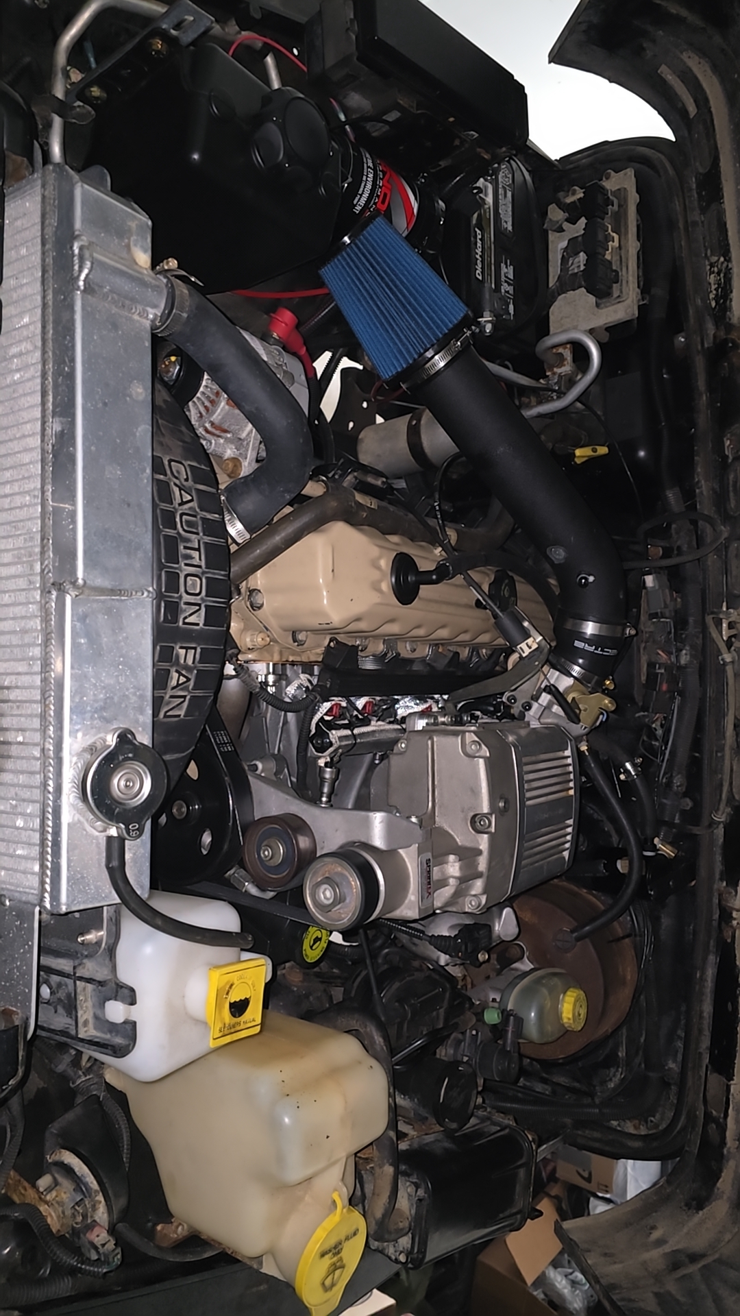

Good evening everyone, I currently have a 4.0 with a sprintex supercharger kit and a 2.5 bar tmap sensor. I'm looking for the map multiplier info , the barometric pressure info and the min 5v count and max on the engine diagnostic airflow page. I've checked all of hp tuners forums and on here as well, I've gotten varied answers from 190 - 488 mine is currently set to 244. Can anyone explain what setting need to be changed when doing a map sensor upgrade via hp tuners please and thank you
05-06 sprintex bosch map sensor
looking for pre 04 data this might not be much help
max air flow 7,937
MAP Sensor Offset 53.98 kpa
MAP Sensor Offset 20.00 kpa
MAP Sensor Offset .4106 v
baro min 1.00
baro max 4.61
