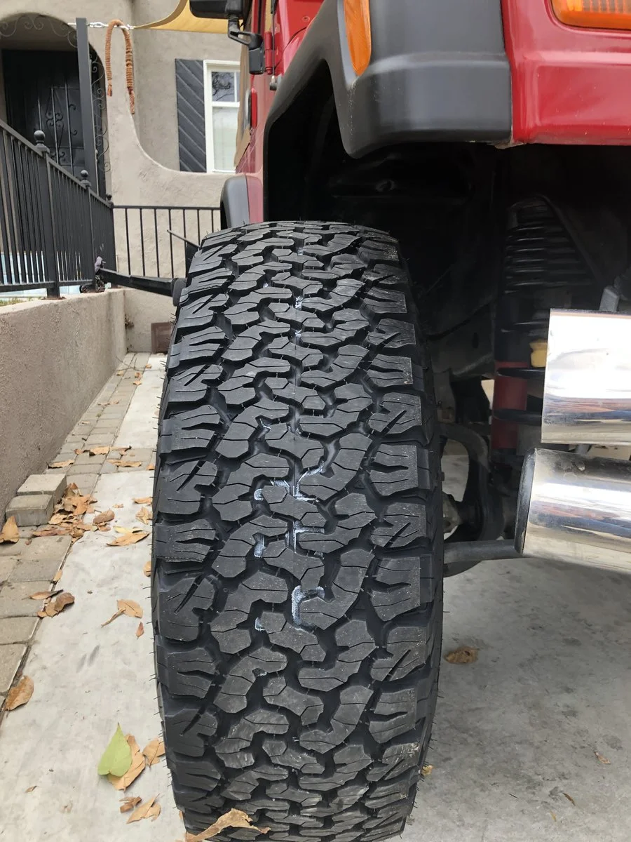

BFG all terrains 35x12.5x15 on 15x10 rims . You can see at 26psi they are still round

All that matters is where they hit the road ...air em down and see...they will relax some too.

First, not many tire treads are designed to be totally in contact with the ground and that one doesn't appear to be.
So far as getting the inappropriate Load Range E tire for your TJ, I'd go back to the dealer and complain that they let you install the wrong load range without any counsel that it was incorrect and that a Load Range C should have been what you received. That may not work but it's the only thing I can think of. Some tire dealers have a guarantee that you'll be happy with your purchase, it's worth checking out.

Just because the top of the tire looks not flat. Doesn't mean it's not flat at where it contacts the ground. Your tire under load is going to flatten out on the bottom. Best to use the chalk trick.
Air down to 20psi and see how the ride is. I have not heard you complain about the ride yet. If the ride is to harsh even at 20 psi. I'd consider taking them off now and selling them as near new. And get yourself a set of C range tires. The hundred bucks you'll lose will be put towards "I don't have to learn this lesson again!".

Let more air out. Not sure why 20psi has become the magic number. But the answer is very likely to be less than your current 26psi. We are also assuming that your gauge is accurate.
If less psi helps, also know that tires soften up as they get used.

You can’t judge a radial tire by anything but the contact patch (the part of the tire touching the ground). You’re thinking about it too much. At 24psi you probably have the correct contact pattern. I’m guessing the BFG engineers have done their homework and have it right.
@Nimbley yeah but a load range e tire belongs on a f350 not on a Tj . I’m sure the contact patch is designed with the weight of the vehicle in mind . Hoping for the best outcome
