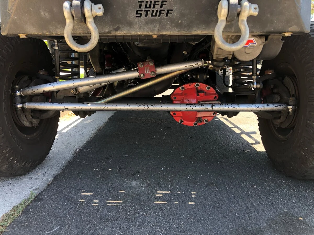

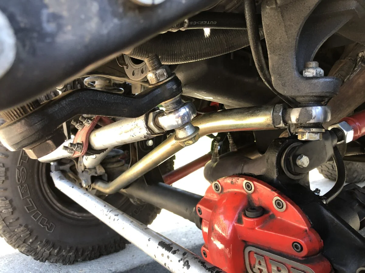

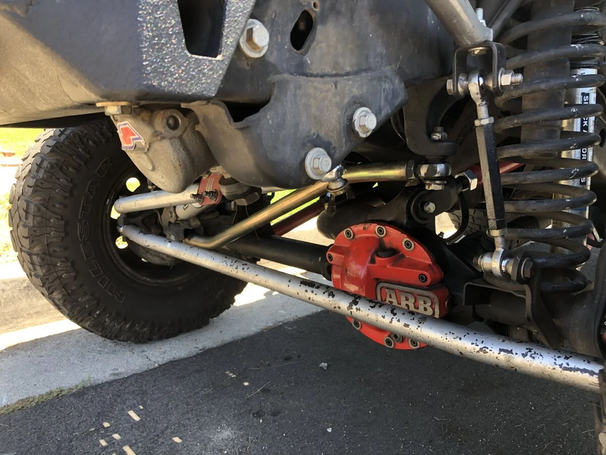

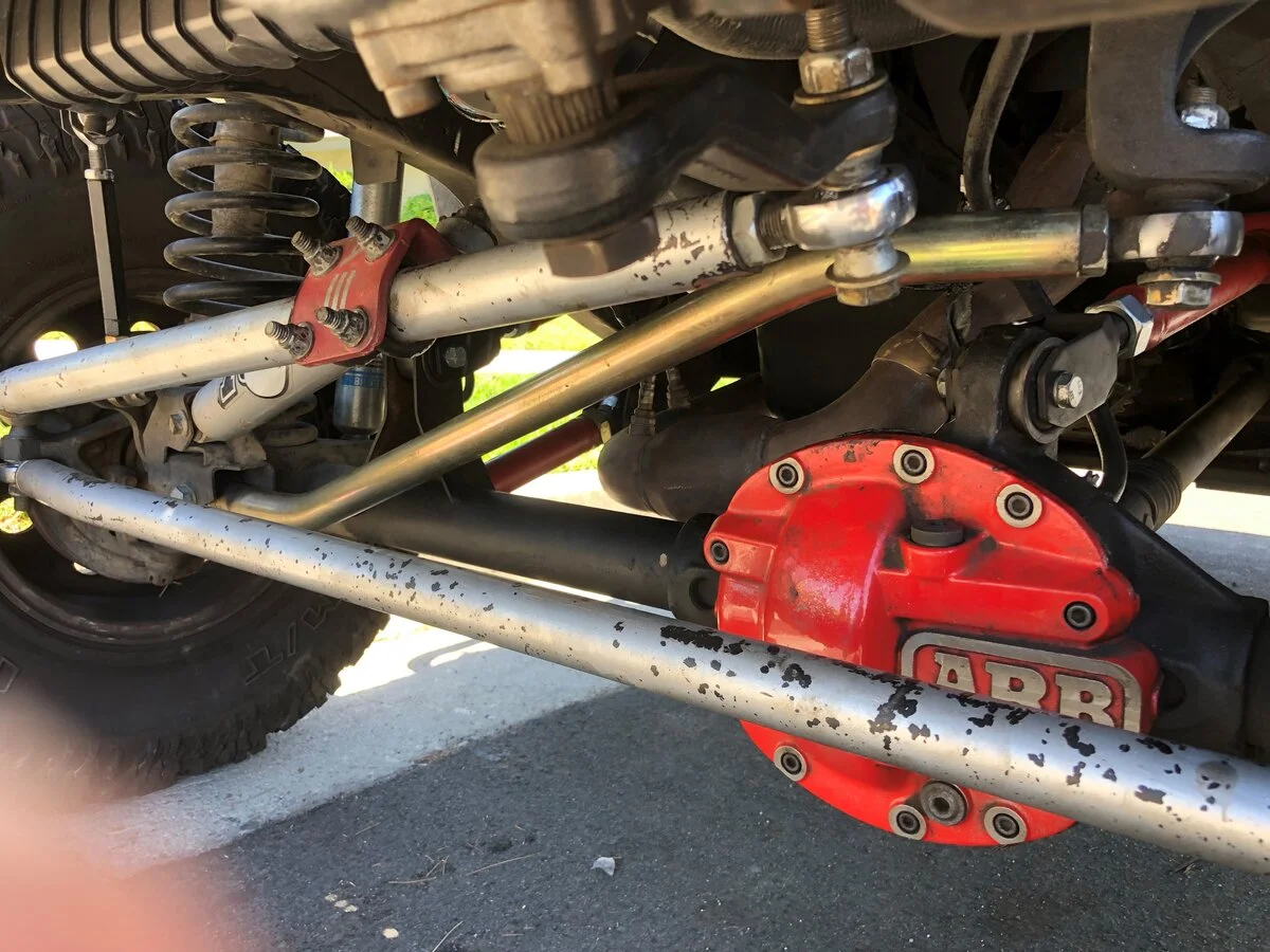

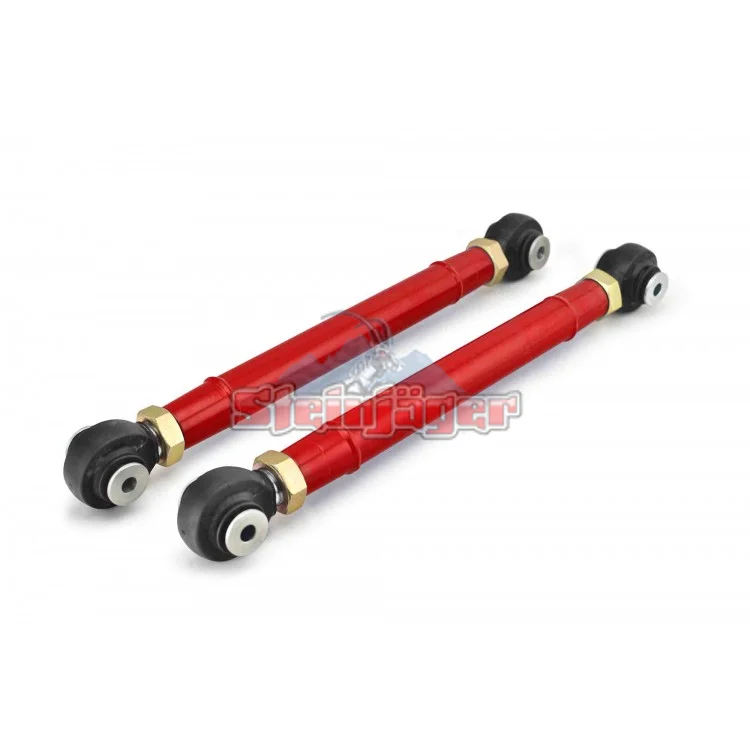

LONGJP2 TJ Expert Lifetime Supporting Member Joined Aug 11, 2019 Messages 5,852 Location S. Illinois Jan 5, 2024 #61 Lsewell972 said: Your lower hiem joints are missing the “misalignment spacers” which can cause death wobble. Your upper heims have them installed, but if your lowers don’t (3/4” hole), then the 5/8” bolt will have slop in the lowers. Click to expand... That's 3.
