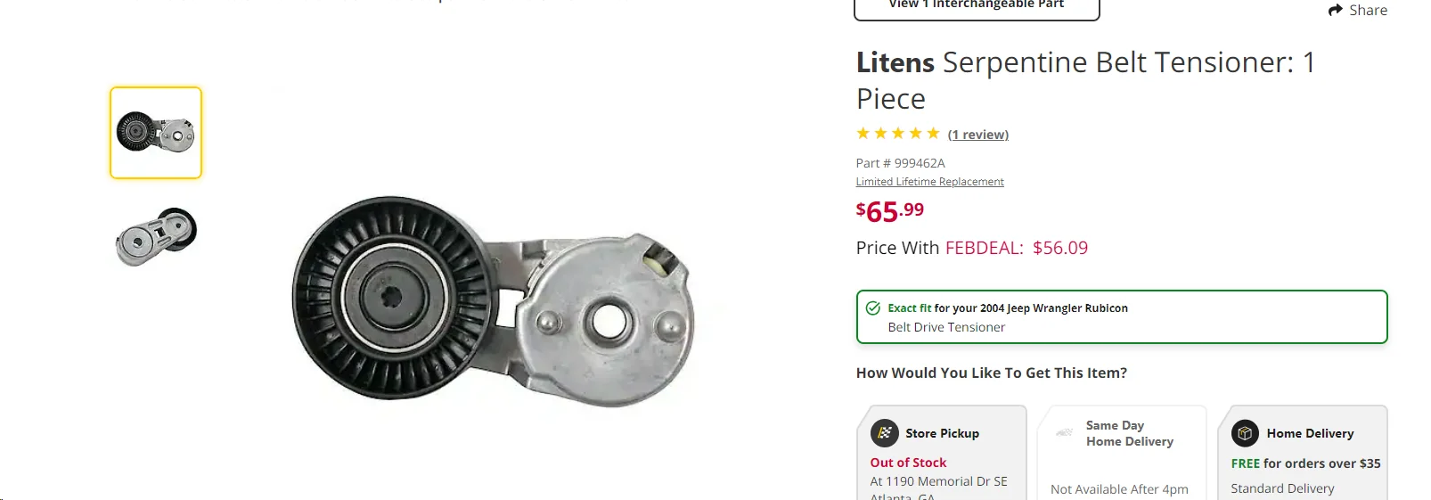

This is the OEM tensioner, the OEM is stamped LItens:
