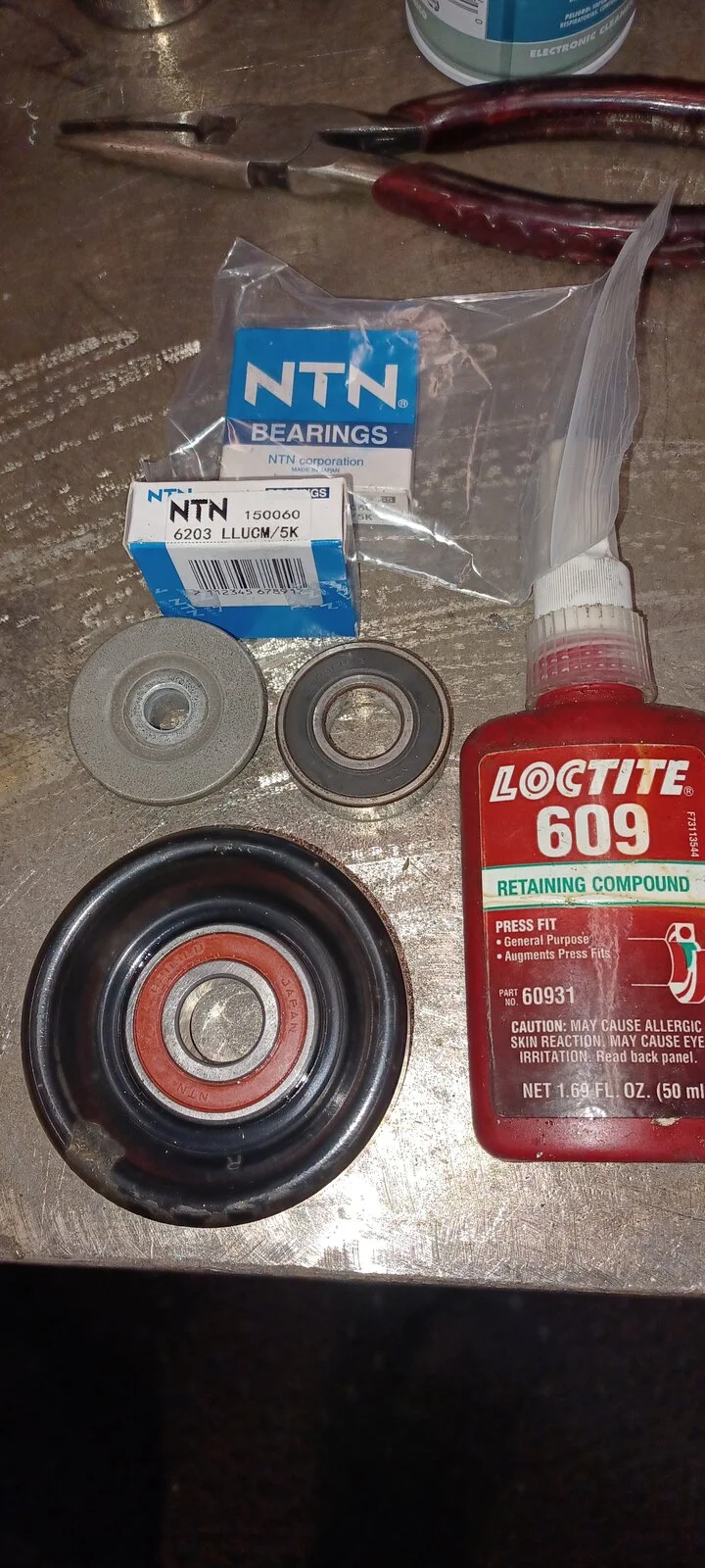

There is a bushing that goes into the bearing. Two styles are available. The OEM OD is larger than the bearing OD and the aftermarket bushing that is smaller than the bearing OD. I just rebuilt my idler using a an NTN bearing. The new bearing seals are red, the bushing is above the pulley. The bearing is $6, it fits the tensioner pulley also.
Hey this is good stuff. The idler I replaced that was out of round was for a 2005, 4.0, but I have a 97 that uses the same pulleys you have pictured here.
Rather than purchasing new Mopar pulleys, especially when quality is suspect, it makes sense to me to press in a new bearing and keep the old one that is fine otherwise.
What was your process for pressing in the new bearing?
