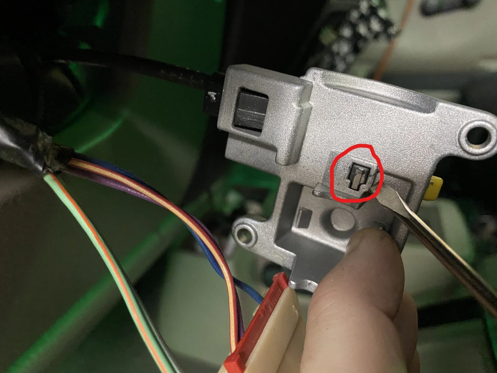

I agree, get another actuator. I’ve almost bought one as a spare just because if it breaks it will leave you stranded. There’s some kind of screwdriver trick, but do you have one and do you know the trick. Yours sounds like it’s not the actuator because they won’t even start if broke.

If you take the ignition switch off the column you should be able to rotate it to start the vehicle then just remove the metal lock part from the actuator and drive it home.
Yes, get 2 actuators. Mine broke the day after an off road trip. I keep a spare in my Jeep now, along with a couple of those security torx bits.
I don’t know what the little piece is called, but there is a tiny little metal piece under a cover on the actuator. Don’t lose it.
