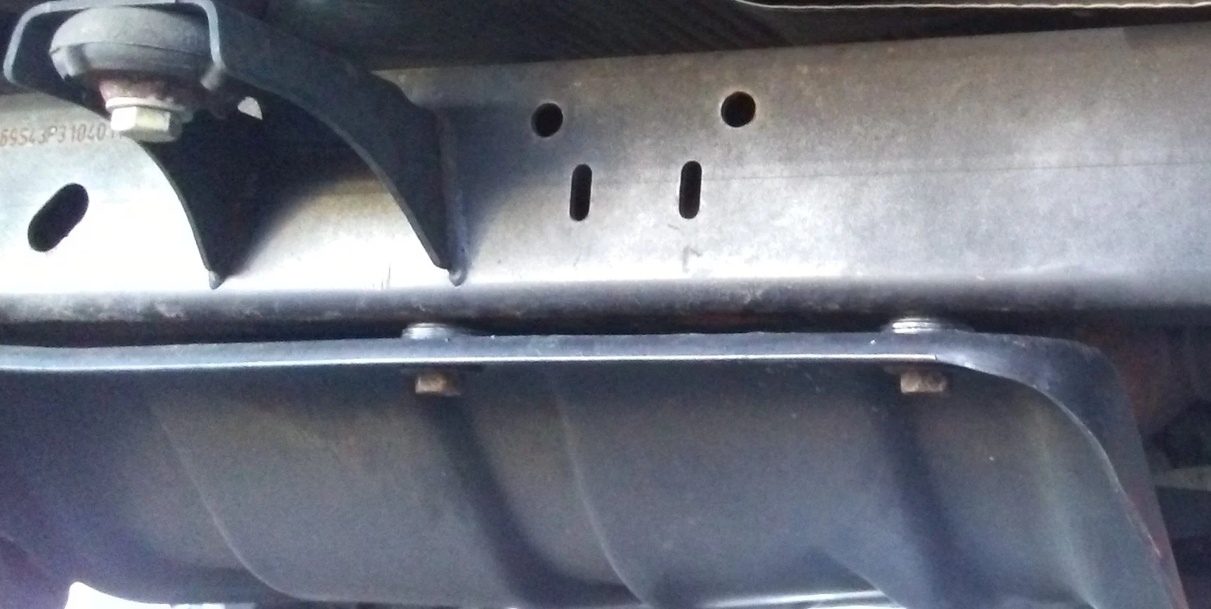

I would install the kit and drive it to see if you have vibrations. If you don't then you are good to go. If you do then the cheapest/easiest route is a transmission skid plate drop. This not only looks awful but kills ground clearance.
Not too much. :unsure:

I have about 2" of spring lift, I also have a 1" motor mount lift which may have helped me avoid any vibration issues. But with my current 33" tyres I still tend to find that more often than not it is that skid that causes me problems. Personally i am planning on installing an SYE so I can look to get the skid up higher, rather than drop it.
But if you do not plan to go off road much or will just be going on gravel traps break over will be less of an issue, so you could lower the skid a little as stated above.
