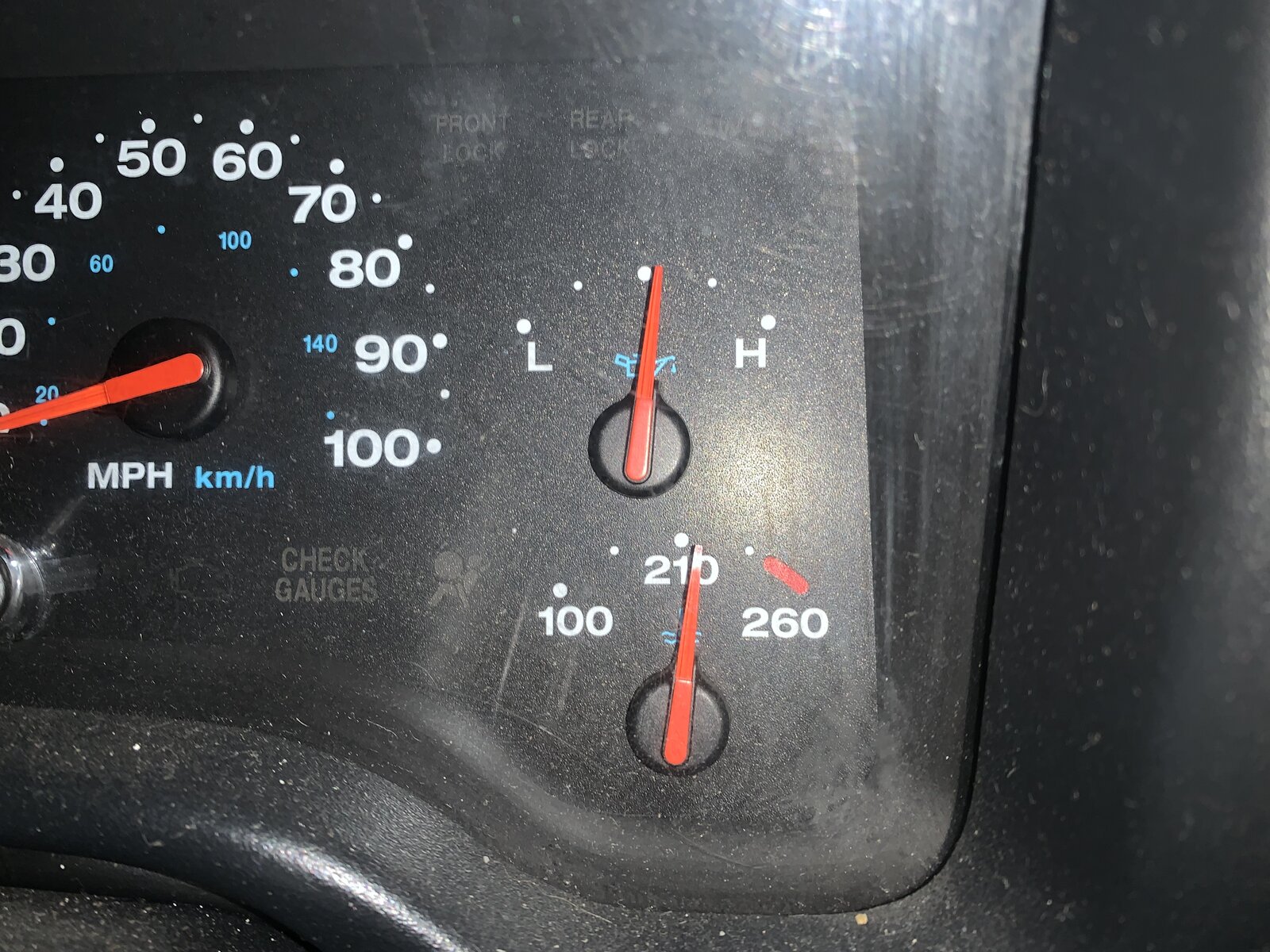

No, I am talking about idling for 50 minutes outside of a place where I take the kid for activities. This with AC and automatic transmission. Before I started idling, the engine temperature was 205F, manifold temperature was around 150F, and transmission was around 160F. Then idle, and temperature starts to climb slowly.
After ~40 minutes manifold reaches 237F (based on IAT sensor, which is in the manifold, old reading), engine 231F (based on old reading) and the transmission to 188F (I have sensor in the pan, routed to glowshift gauge).
In any form of traffic, as long as I move once in a while, it will be fine.
