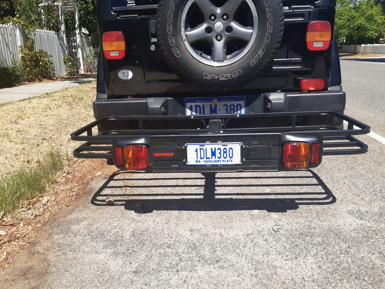

I was thinking about trying to mount a rear rack on my MorRyde tailgate setup. It would give me a little extra room for some light stuff with overloading the tailgate hopefully.

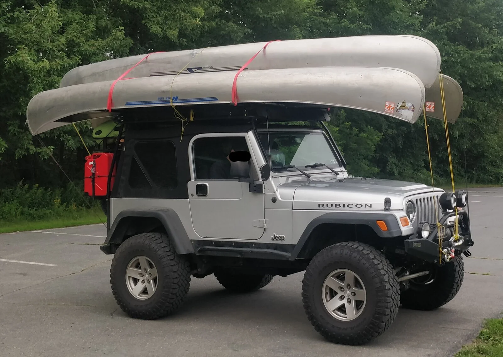

I ended up choosing the Garvin rack for its versatility. In particular, I needed a rack that could support at least 300 lbs, mount crossbars 72" in length, and simultaneously carry long and bulky cargo.
The Garvin mounts to the body front and rear, though in the rear the mounts sit on top of the body mount/body lift puck. The Gobi mounts to the body in the front and the frame in the rear.
As for the soft top, I found if I pulled the quick disconnect for the folding sunroof feature, I could easily slide the entire top rearward off the roll cage without disturbing the rack. Alternatively, you can tilt the rack, but if the rack is loaded that can be a lot more work.

Thanks for this. I like the look of the Garvin rack on your rig. The tilting is perfect for being able to put the top up and down also, and it looks like you put it to the test with those canoes!

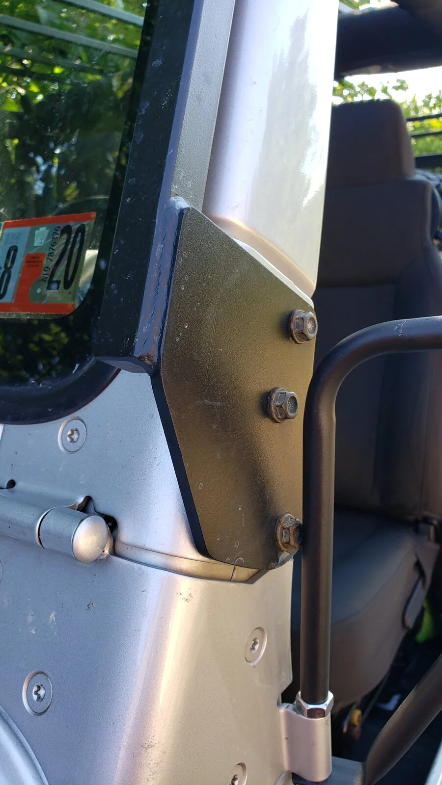

Personally I didn't have any issues drilling the holes. When I remove the rack, I simply leave the upper and lower brackets installed. They really don't look out of place unless you're specifically comparing it to another jeep.
The upper holes go into the lip of the tub, and the nuts/washers are partially hidden by the carpet, and are fully recessed anyways.
The lower hole goes into the void where the fuel venting equipment is, and doesn't affect anything.

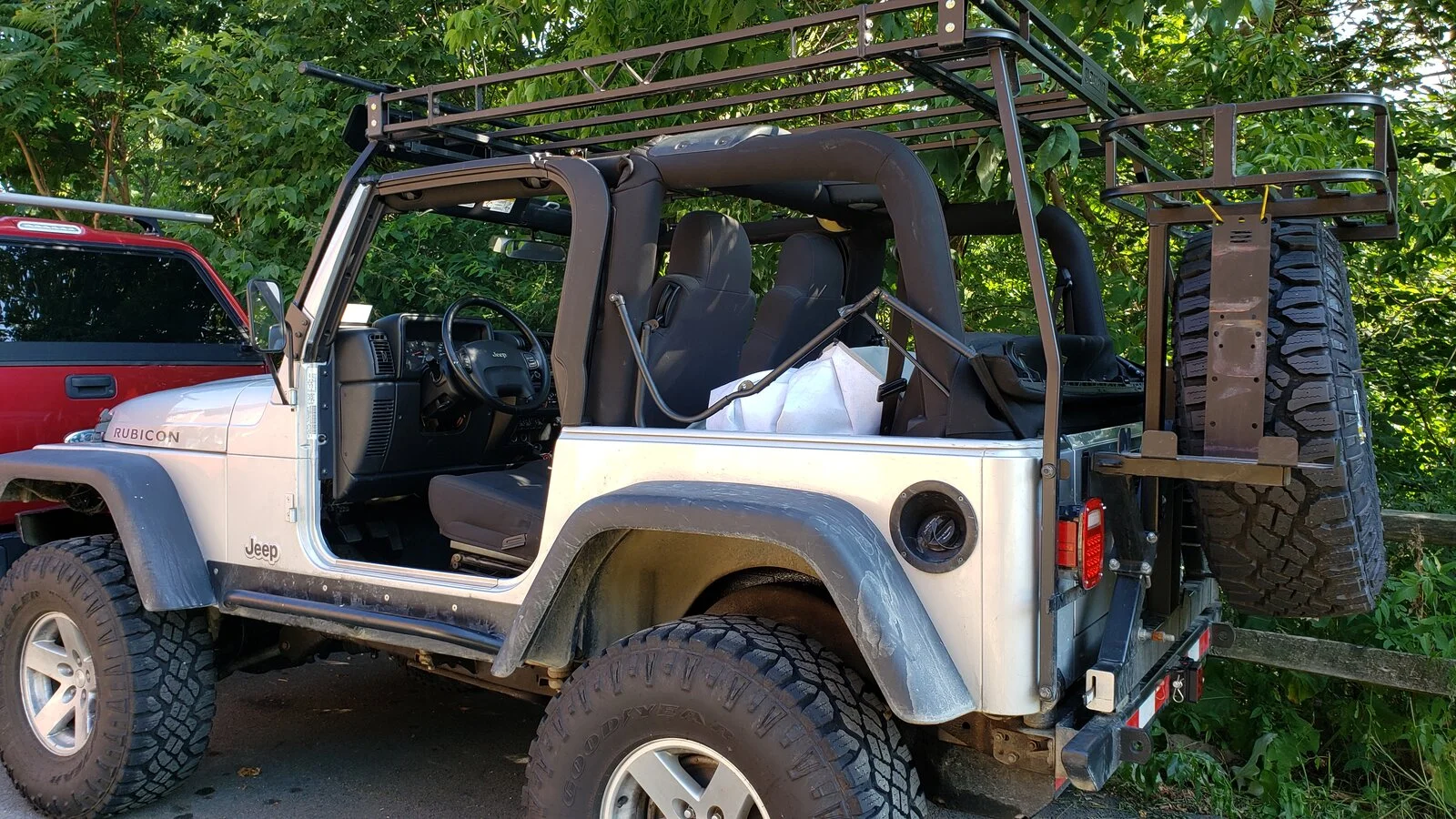

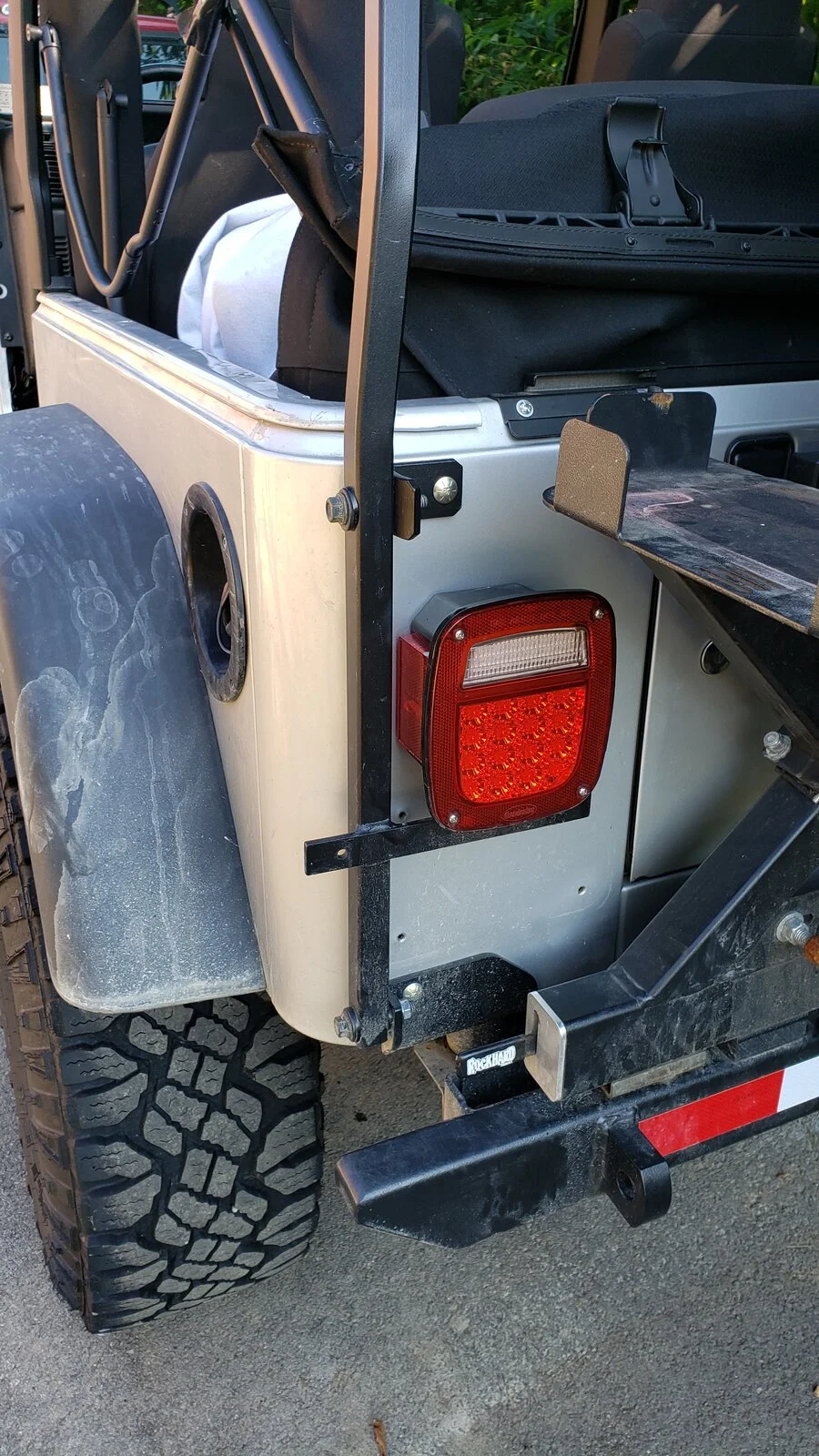

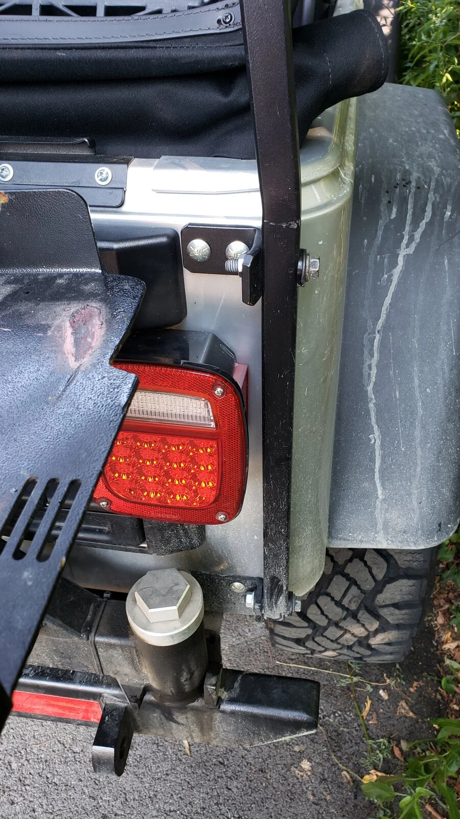

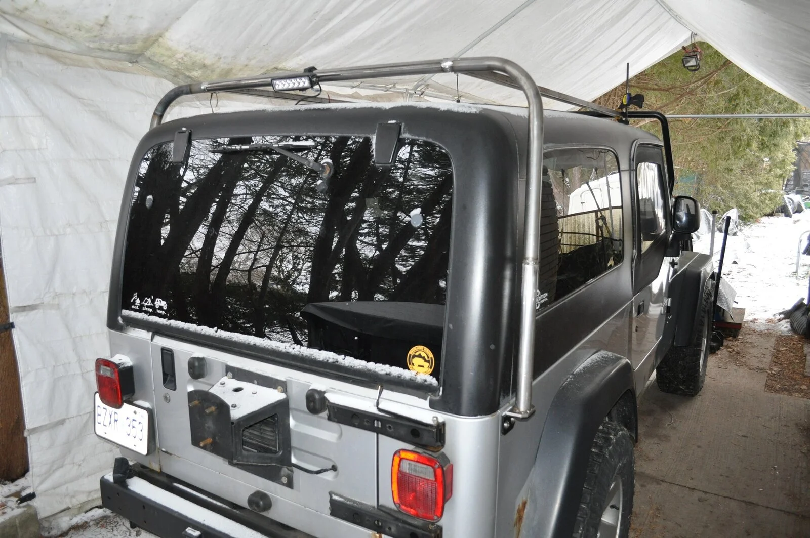

I'm building my own rack. I went through the body at the rear - 2 bolts per side. The angle bracket shown below has a corresponding bracket on the inside that bears most of the weight. I can remove the whole rack in about 15 minutes but I won't be doing that. My hard top stays on because I find it to be much more convenient for camping a bit better for protecting your gear.

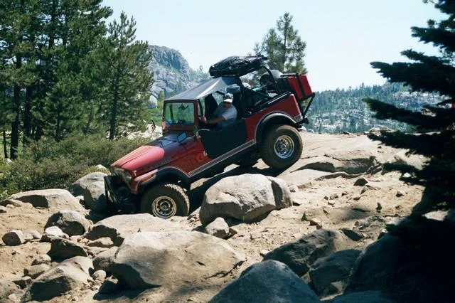

An arrangement that worked well for me on my CJ-7 was to mount a small Con-Ferr roof rack to the roll cage over the rear seat area for longer trips. It was easily removable when not in use. Here is a shot of it on the Rubicon Trail:

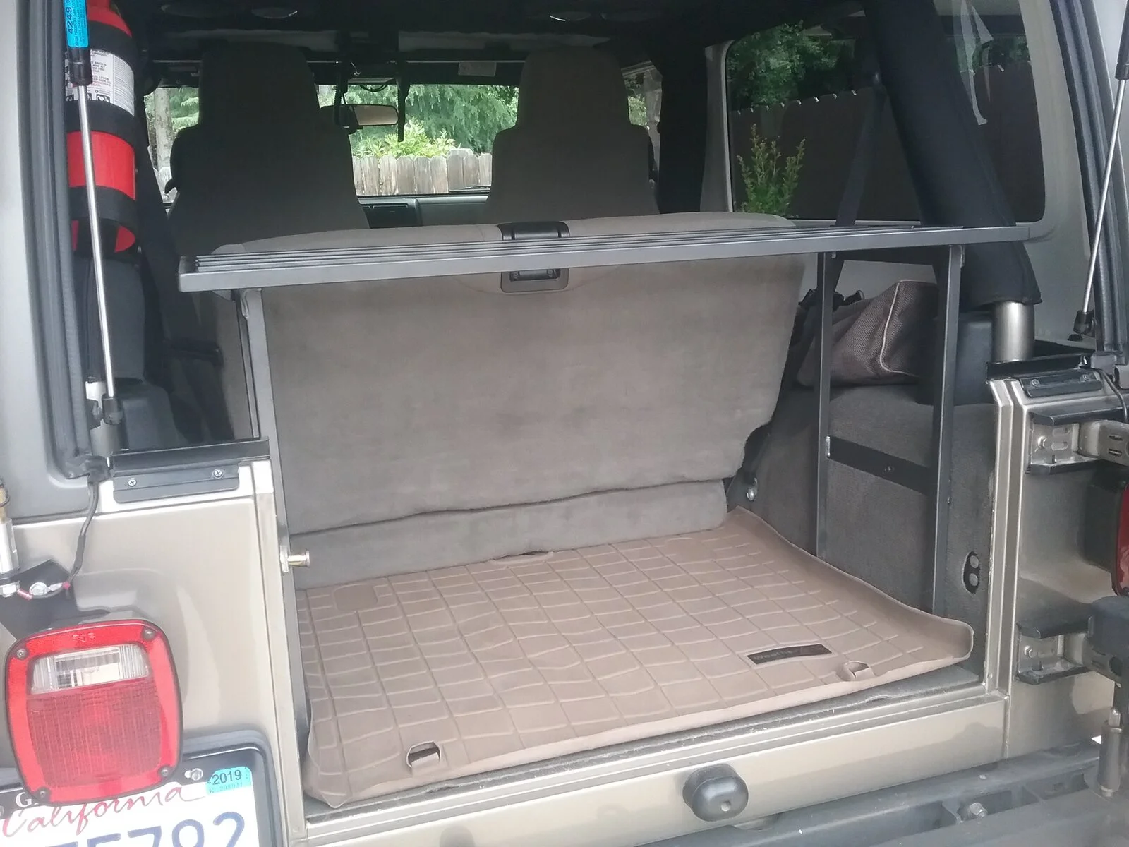

My current arrangement is an interior cargo shelf behind the rear seat of my LJ. The shelf doubles the available packing space behind the seat and allows me to leave the rear seat in place even on extended backcountry trips.

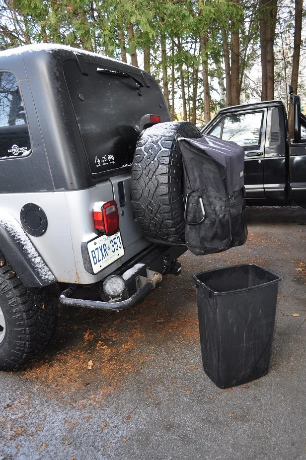

. . . and a spare tire bag.
I forgot to mention a spare tire bag.
A Trasharoo is great for trash, but I've never liked the saggy diaper look and they don't stand up to UV light. Also, they are no longer made in the U.S.A. and are now sourced from China.
I use a Blue Ridge Overland Gear "XL Tire Bag." It is made from the same tough stuff as truck covers and has many features Trasharoos don't have such as exterior mesh pockets and the ability to cinch the bag tight so the stuff inside doesn't shift or settle. In addition to a trash bag, I keep a small shovel, canvas bucket and related items inside. A bit pricey, but worth the cost in my estimation.

I have Thrasheroo and you're right about the UV problem. Mine's black, or was black, and it looks "well used". Maybe lighter colours show less fading.
Re the "soggy diaper" look, I put a Rubbermaid plastic garbage bin (20 litres?) inside mine. It always looks full and it's easier to load/unload.
