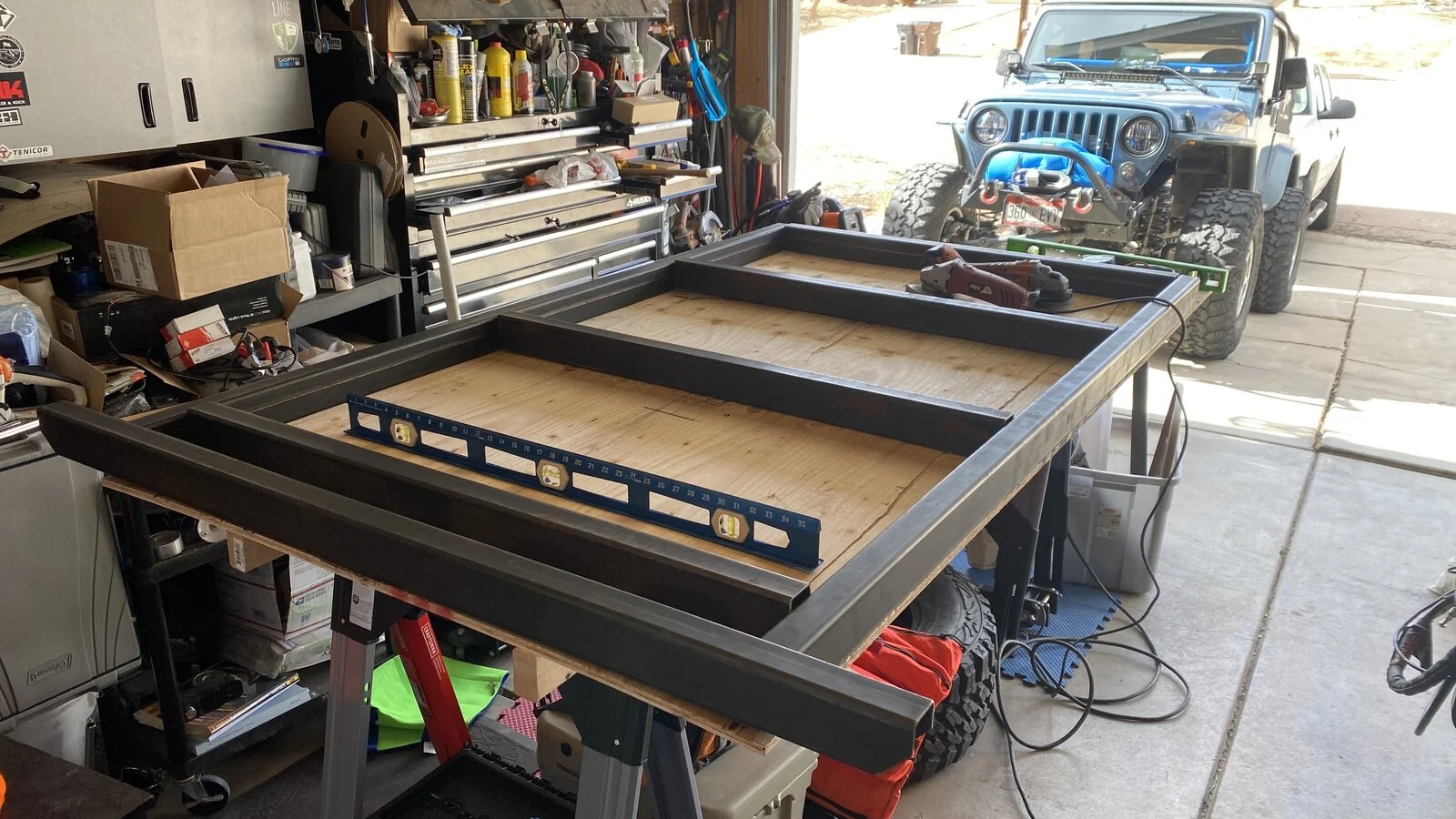

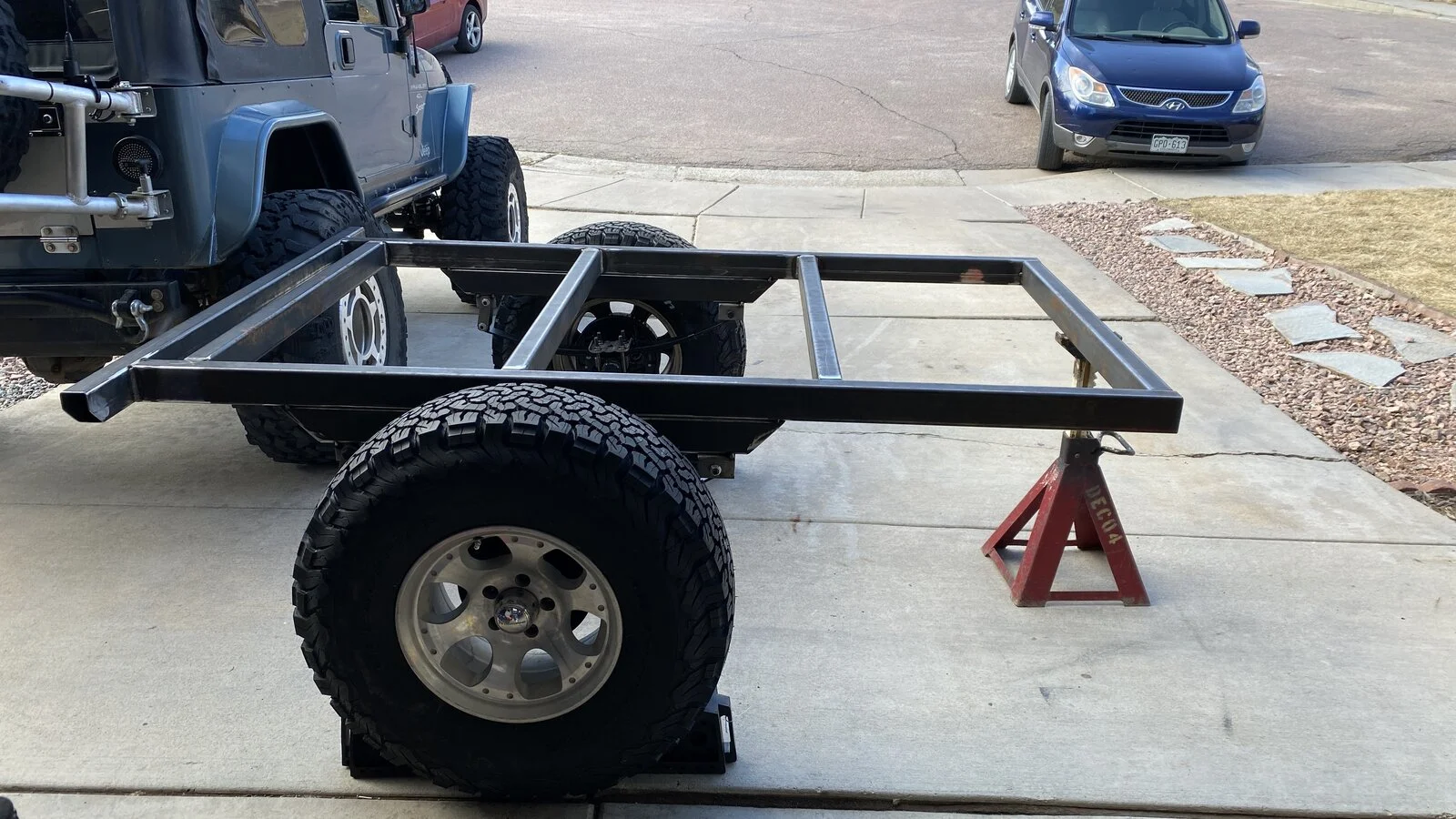

Just started my overlanding trailer build for this very reason. Not enough space in the Jeep for me my wife, all of her “necessities “ and the dog. I had an old military M-100 trailer but sold it so I could custom build a fully Enclosed trailer with a roof to tent mounted to it.

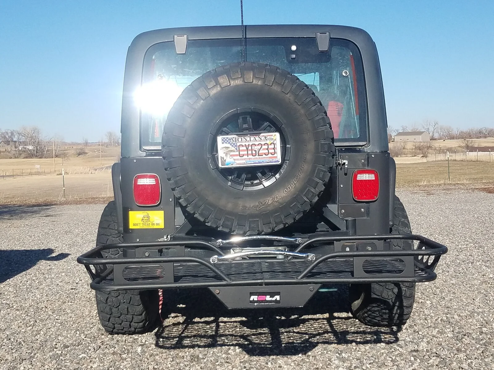

Same as @Fishtaco I've got a hitch mounted cargo carrier. Would prefer a roof rack for difficult terrain leading to camp-site as the hitch cargo carrier reduces your departure angle, but have never really struggled. I will get to the camp-site, ditch the cargo carrier and then on to more difficult terrain.
Here it is helping me move houses lol.
Wouldn't put too much weight on it, I just load it with bulky items (swag, gazebo), bad angle but you get the idea.

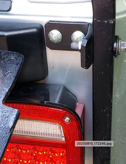

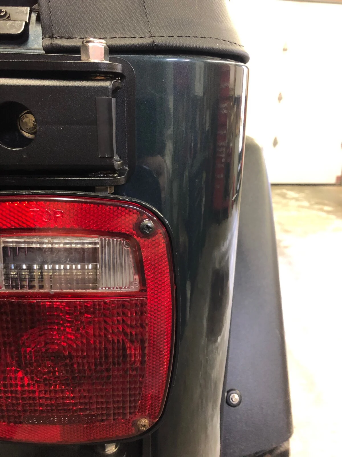

I had finally decided on ordering the Garvin expedition rack. I was looking through the install instructions and @Steel City 06 pictures when I realized I am going to have some interference issues with my MorRyde tailgate reinforcement kit.
Looks like the Garvin Adventure rack has the same mounting point right above the tail light. I guess this brings me back to the Gobi. My only concern about the Gobi rack is that the basket is much smaller from what I have read, so less storage space up top. That and lead times are 14 weeks out.

I wonder if you could jury rig a substitute bracket there. That bracket doesn't carry weight; it's there to provide rigidity to the rack. Without it the rack could rack forward or sideways under braking or high turning forces. So it would have to resist pulling forces in four directions, but not downward force from weight.
Too bad you can't just extend the MoRyde C channel already bolted to the tub to connect to the rack. How hard would it be to uninstall and weld on an extension?

I was thinking that, and trying to picture, but I would also hate to have to rig something to a brand new $1500 rack

I had the same problem with my tire carrier...just omitted that attachment point...plenty strong with no movement with all other points attached..

That looks awesome! Do you have a thread going on that one?
