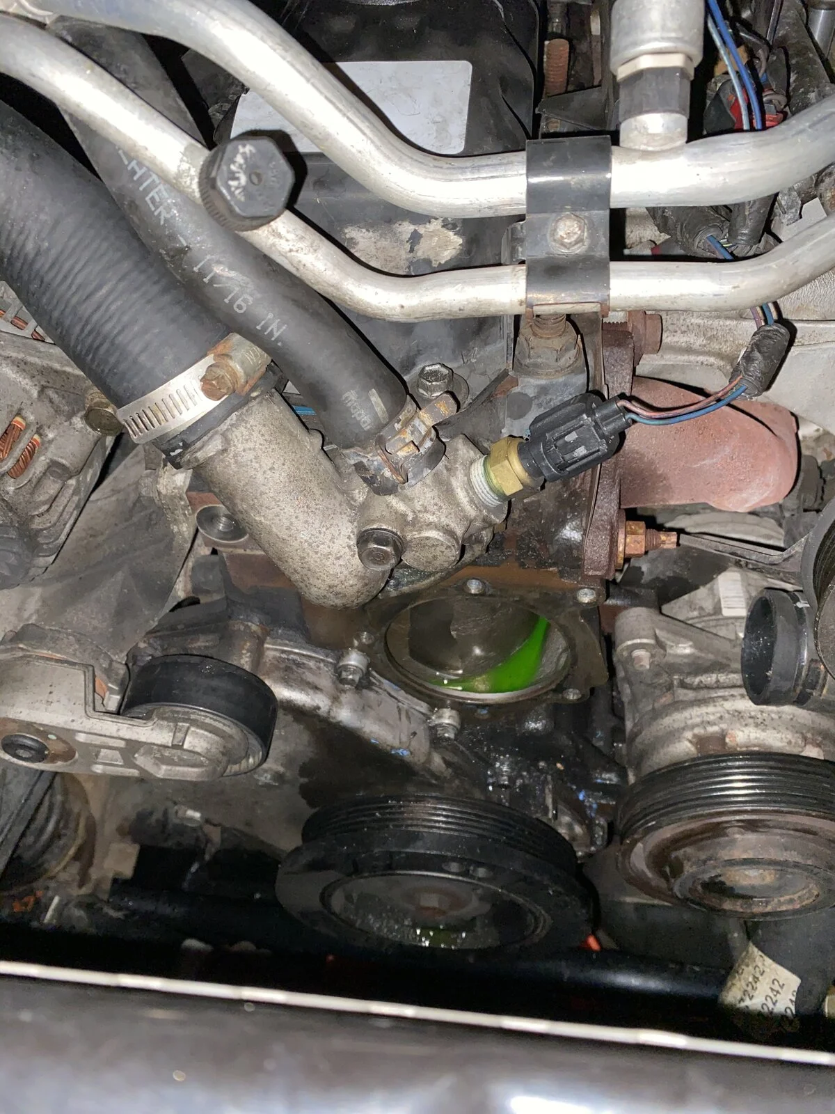

Through much research on here I know my 06 needs HOAT. Yesterday I started swapping some items out on the coolant system and I have green coolant (see below). I’m pretty sure this is standard coolant, I’ve never had any issues with my cooling system-until my water pump weeped. Question is this, can I put green back in there for now, as it is what I purchased, and then just do a coolant flush a bit down the road?
I know HOAT is the recommendation on my Jeep. I just don’t believe I have the energy or drive to flush this bad thing out today.
Yes. The problem comes when you start mixing different coolant types in the system. If you currently are running the green stuff you can either keep with it, or do an extensive flushing to get it ALL out and switch to whatever color matches your eyes.😎
Yes, you can. "Standard green" and HOAT coolant are both ethylene glycol coolants. You won't get the same additive package, but it won't hurt a thing. However, one must flush standard green ethylene glycol coolant more frequently than a "long life" HOAT coolant, typically no longer than three years.

The sky hasn’t not fallen, I should have flushed it out and it’ll be a lesson learned. Hopefully it doesn’t cost me any more than some more time and energy in a few weeks.
I got everything reassembled, thermostat is working, system is burped, and it seems to be running well. No leaks that I see but time will tell!
