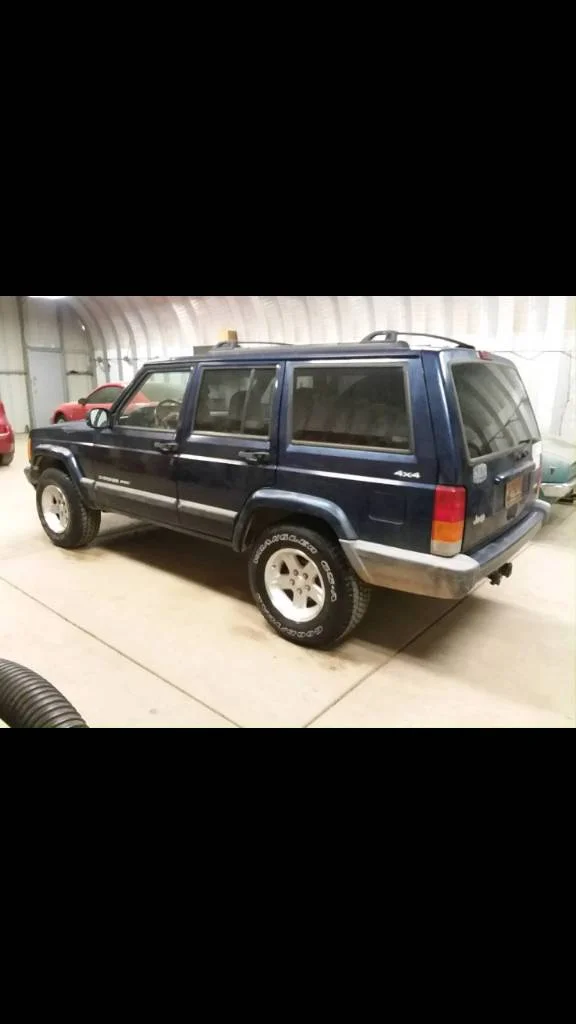

My son really wants an xj. I have found a 2000 sport in rather good condition. I know that some years with head casting 0331 I think have issues.. please guys any a all input I can get from you would be a tremendous help! Pros/Cons.. experiences.. anything will be a huge help.
It's a 2000 4dr sport 4.0 auto. 149000 Mile.. stock..

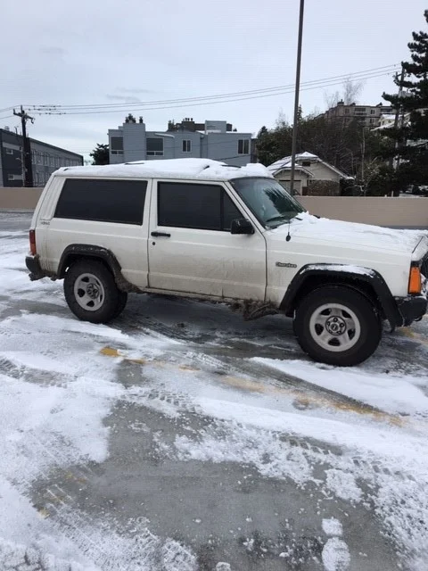

Check out this thread for some dialog on XJs..."Question for current & former XJ owners..."
Not sure if it'll have anything that will help you, but it's a fun read. Btw, I'm driving my wife's XJ, as we've seem some snow this week (that, and I just am enjoying driving it!).
