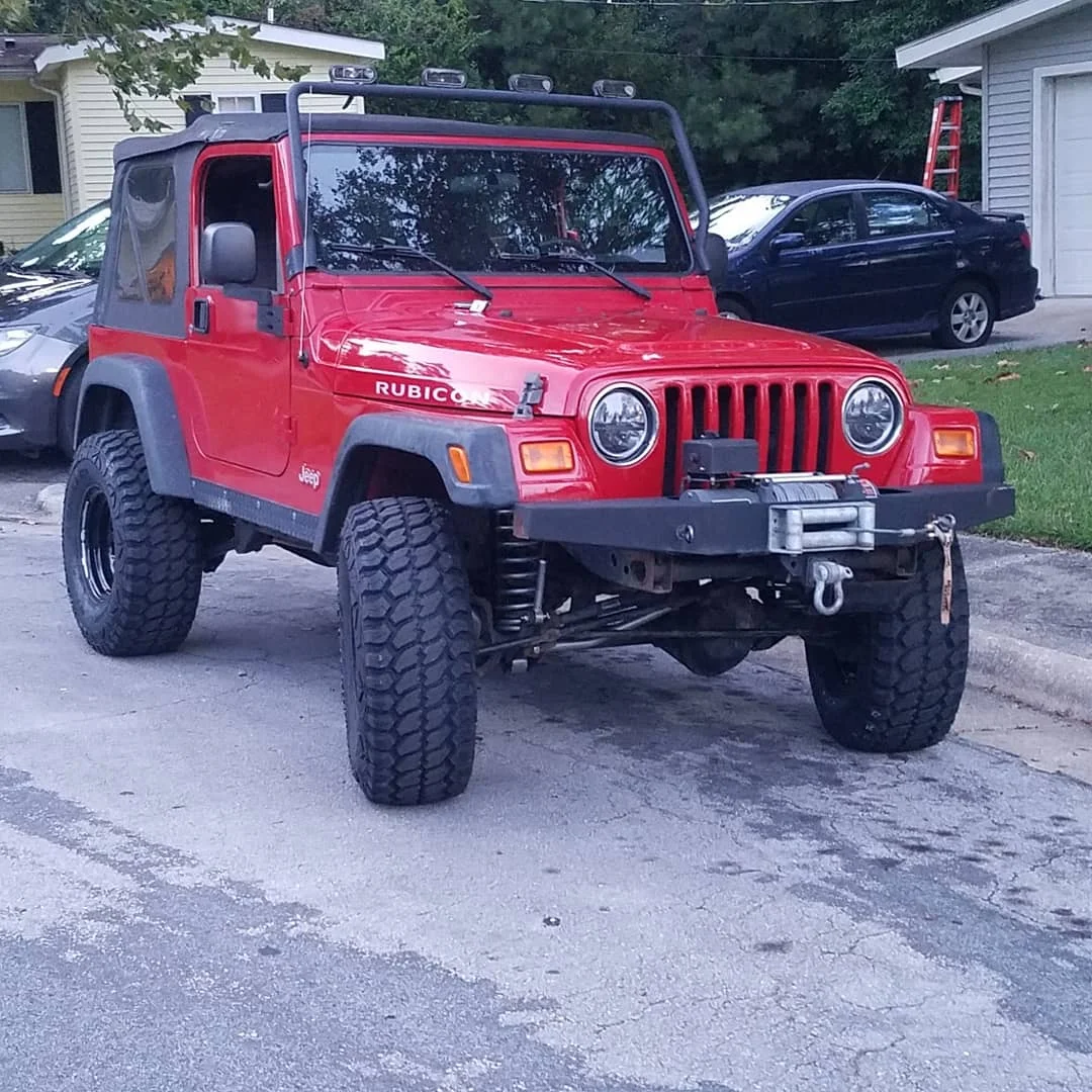

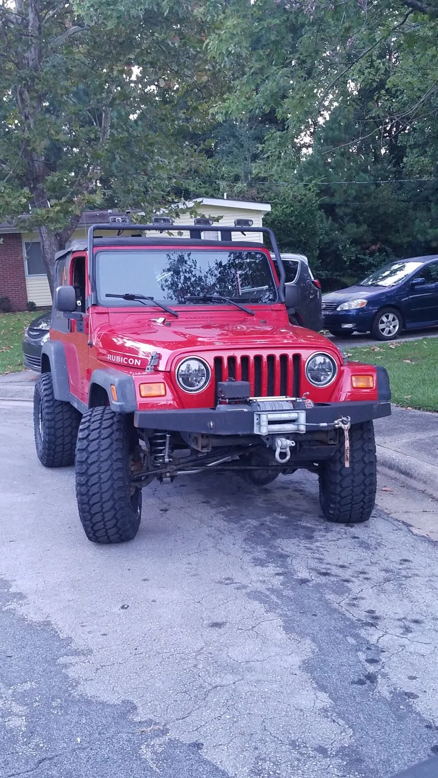

Big update! She got her lift on.
Stats:
Rubicon Express 3.5" suspension lift.
Rubicon Express adjustable front TB.
RE lower control arms.

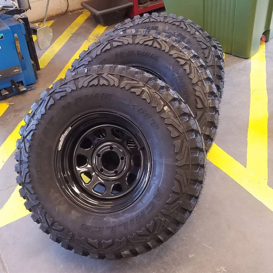

15x8" steel wheels, cant remember the brand because i bought them off of Amazon like 5 months ago.
33x12.5" Achilles Desert Hawk MT tires.
Installation done by: Self + friends
Time taken: 11 hours over 2 days.
Major roadblocks:
Rear shock upper mounts completely rust-welded.
Front lower driverside track bar, metal sleeve in forward bushing rust welded to mounting bolt.
Transmission skid plate forward bolts spin freely in frame.
Things that had to be cut off:
All 4 factory shocks.
Front lower driver side control arm at the axle mounting point.
Driver side factory sway bar end link.
Things left out:
Rear Shocks, drill need to drill/tap/thread existing factory welded nuts after breaking the heads off of all 4 bolts. Debating options on that front.
Also left out the extra drilling/bolts on the rear TB relocator bracket in favor of a few spot welds to secure it (+ the main bolt into the axle mount).
So, the ass end floats a bit right now but that should be rectified as soon as my mechanic and I decide which route to go with the rear shocks.
It looks so god damned beautiful right now.
Gotts love that rust, huh? She looks good though, that's for sure! Do you or one of your friends have a lift?
