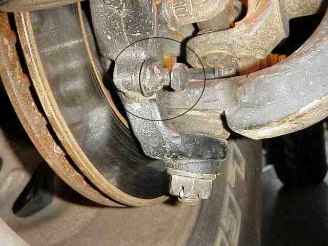

I sold my Rubi tires and wheels because they were 16". So many more choices and cheaper prices in 15" sized tires. If anything, you might need to add a washer to the steering stops, so the slightly wider tires don't rub the lower control arms when fully turned.
