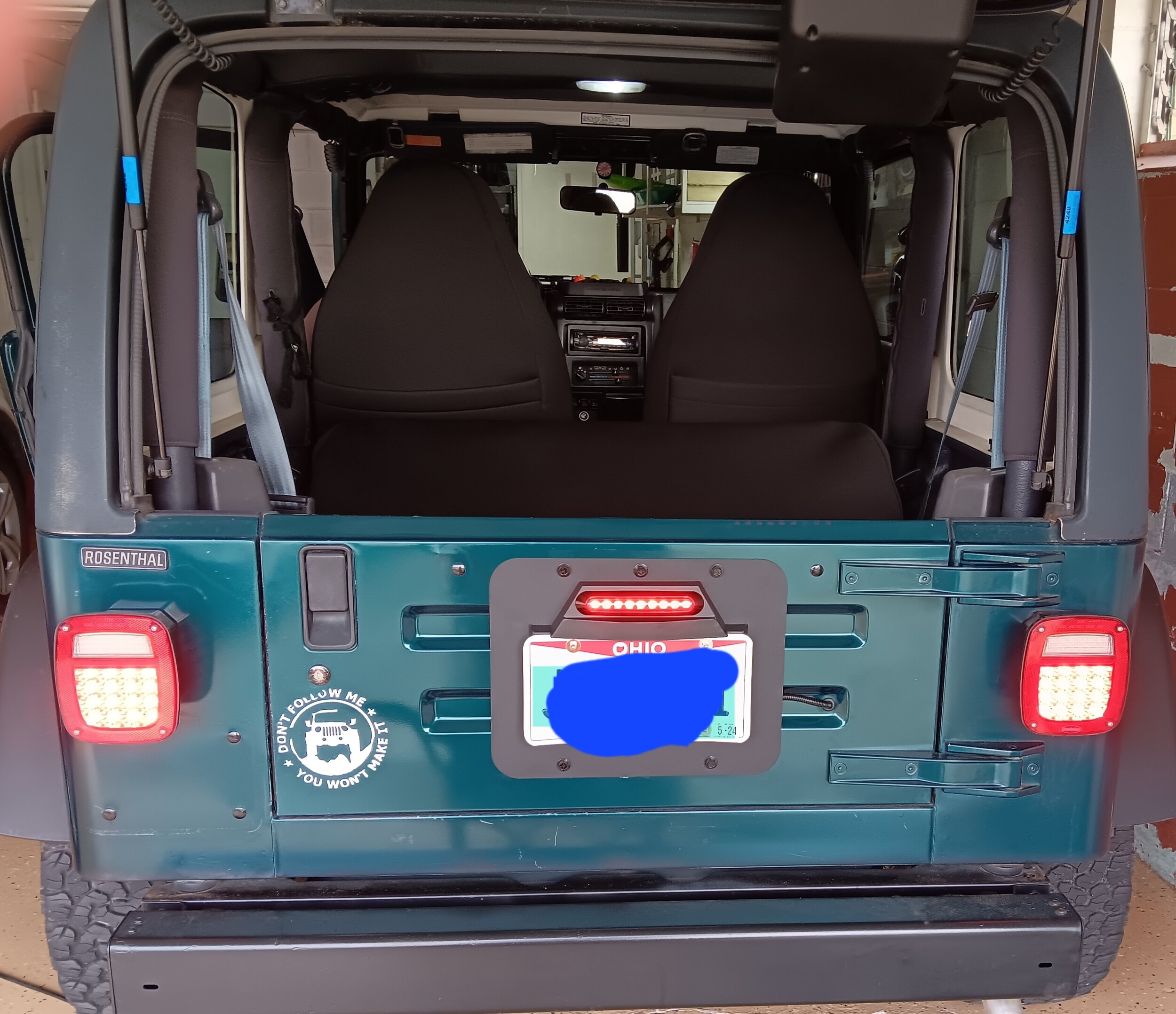

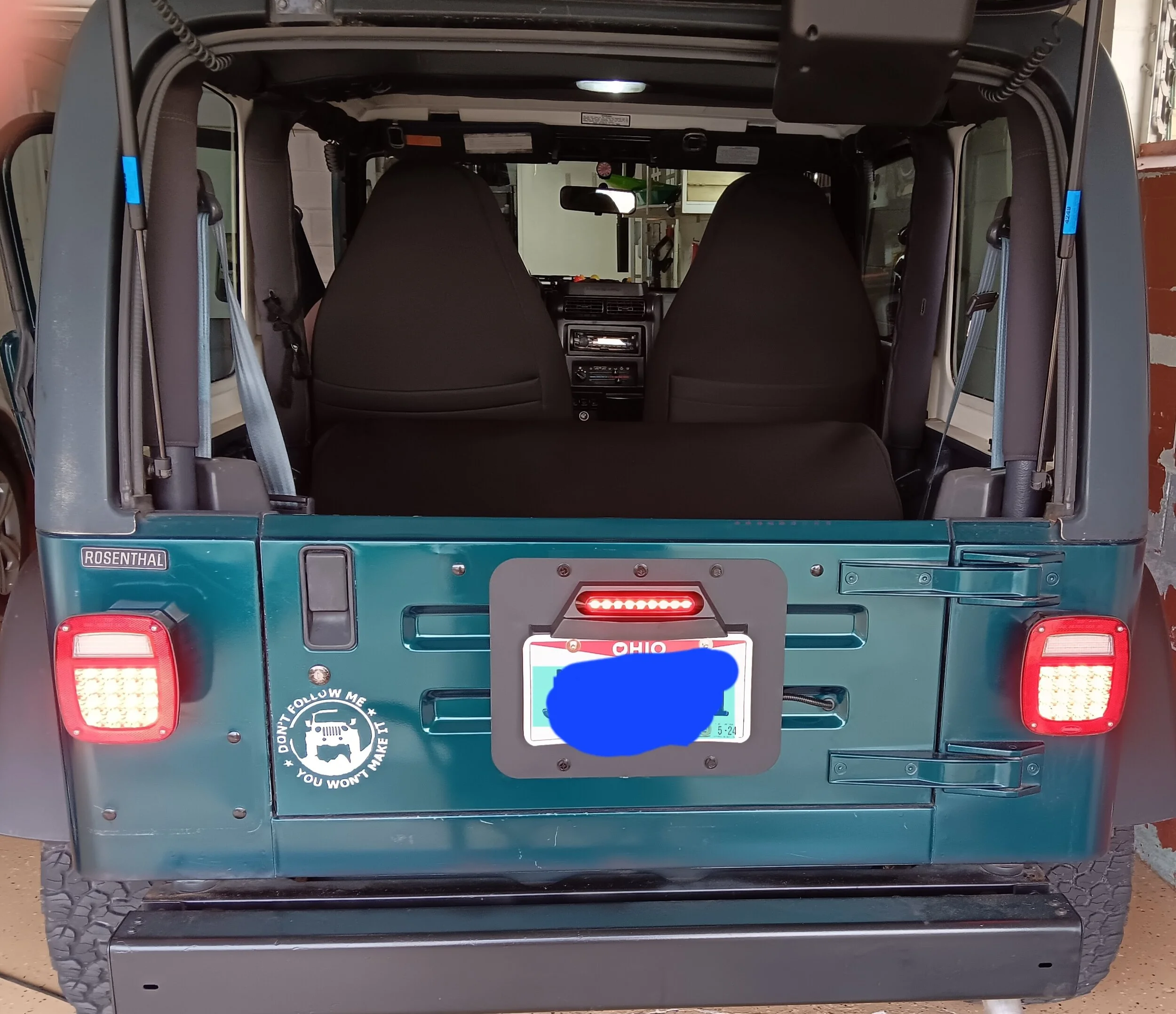

Decided to remove my heavy spare and go with a delete plate. Also moved the license over and wired the led for that. It is a Hooke Road kit, heavy steel welded together and powder coated. It had a "chrome" trim around the brake light, but I painted it satin black rustoleum.

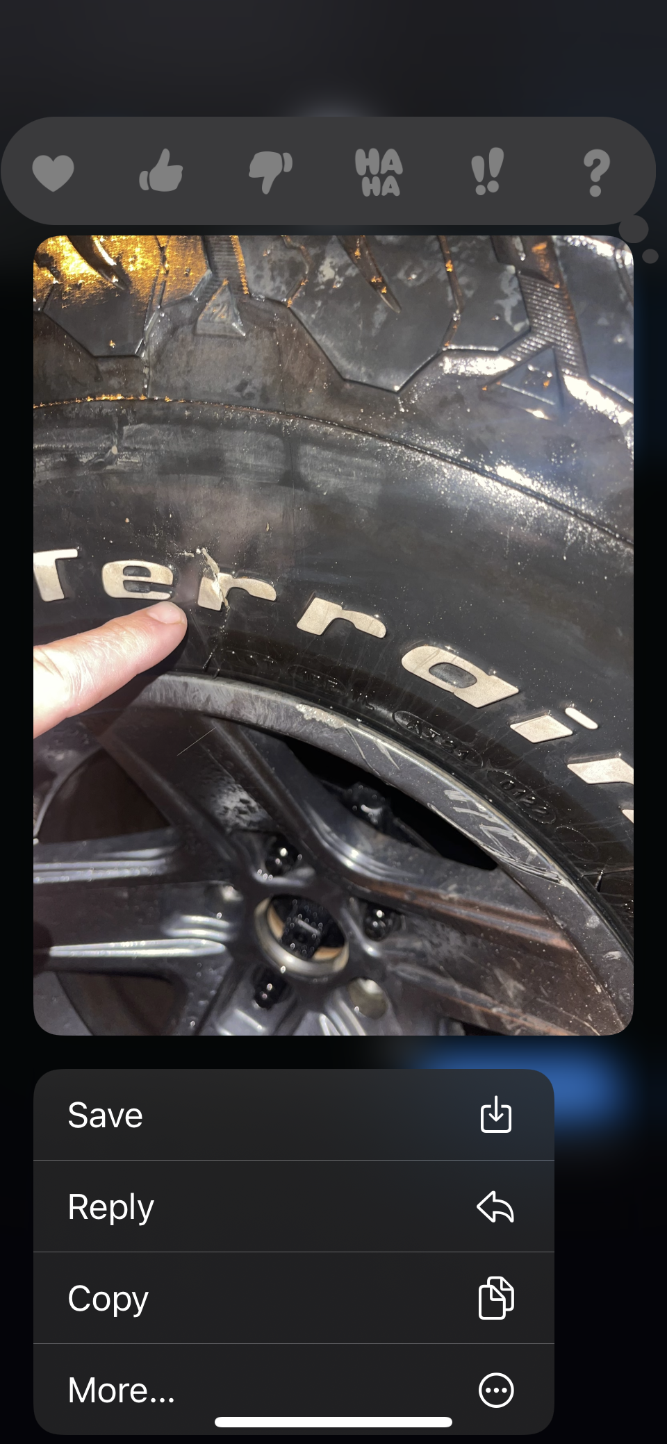

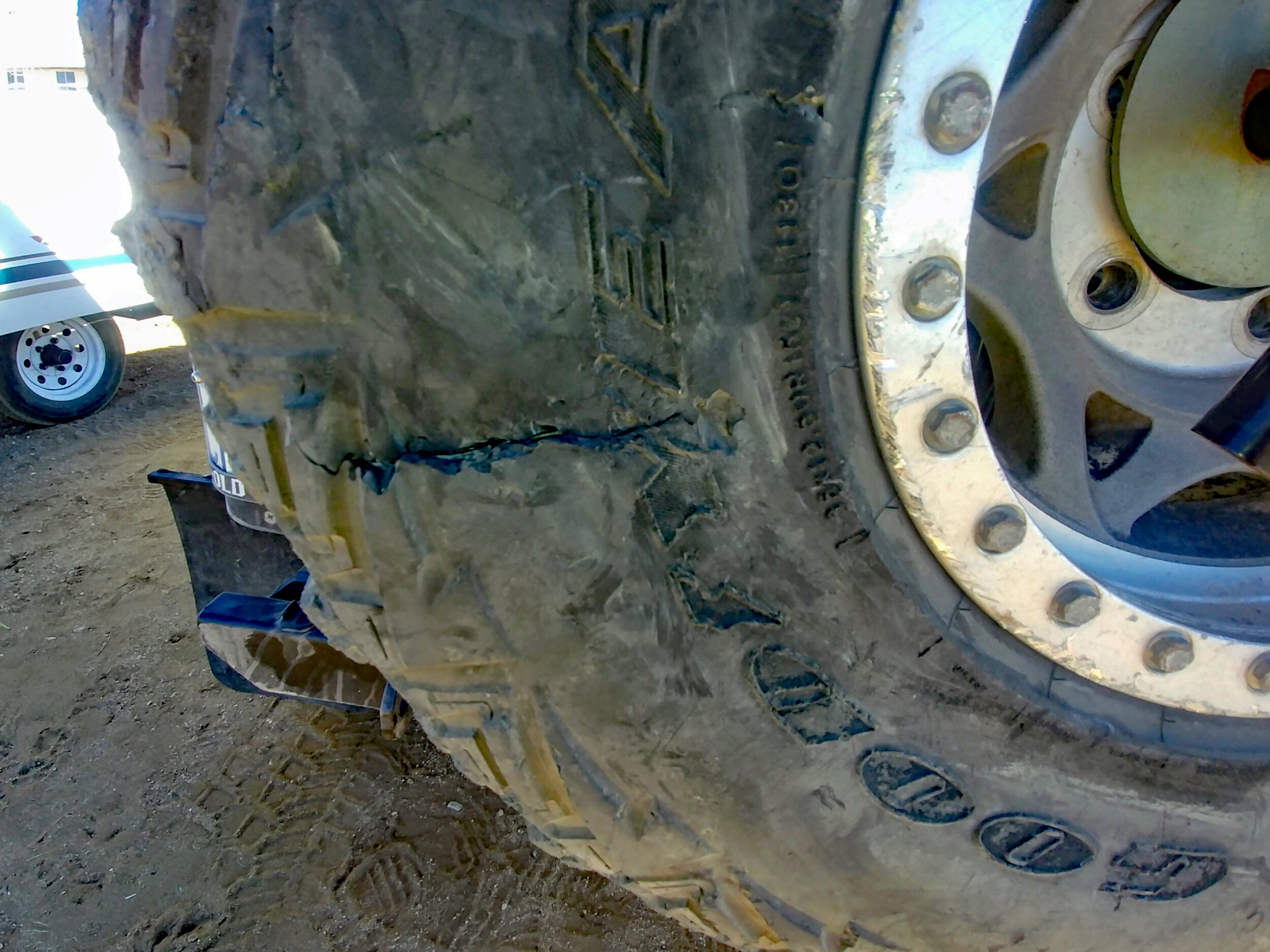

You'll never miss that spare tire until the day you need it. Tire plugs and a compressor won't fix all tire problems. Sliced sidewalls like this have happened to me a couple times.

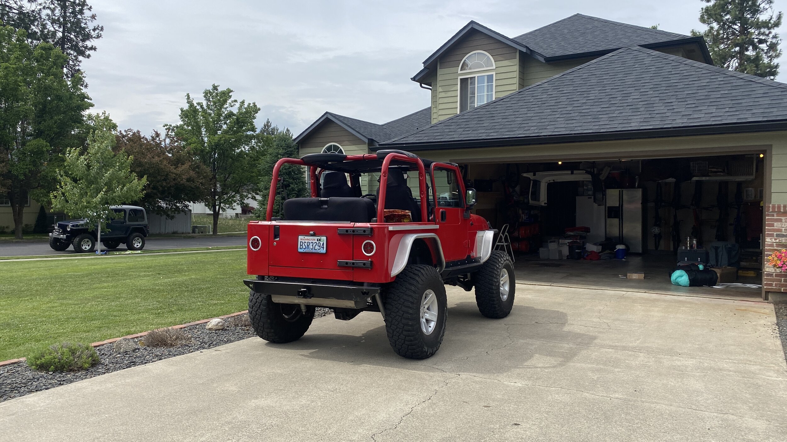

There is one thing to think about- Be a little more careful on wet roads- We have a young man in the area that runs no spare tire and drives pretty fast, And in addition runs a 12.5 wide tire....All those things came together one day when it was rainy and I saw him pull in to a fast food parking lot and lose the rear end.

Just curious (not judging) why you would delete your spare and leave yourself vulnerable? Is it the weight the looks or what. Like I said, just curious.

Weight is part of it, and put so much strain on the tailgate. Would be hard to latch and made such loud racket when hitting bumps, even with good rubber tire bumpers. Just personal, not necessarily a look thing.

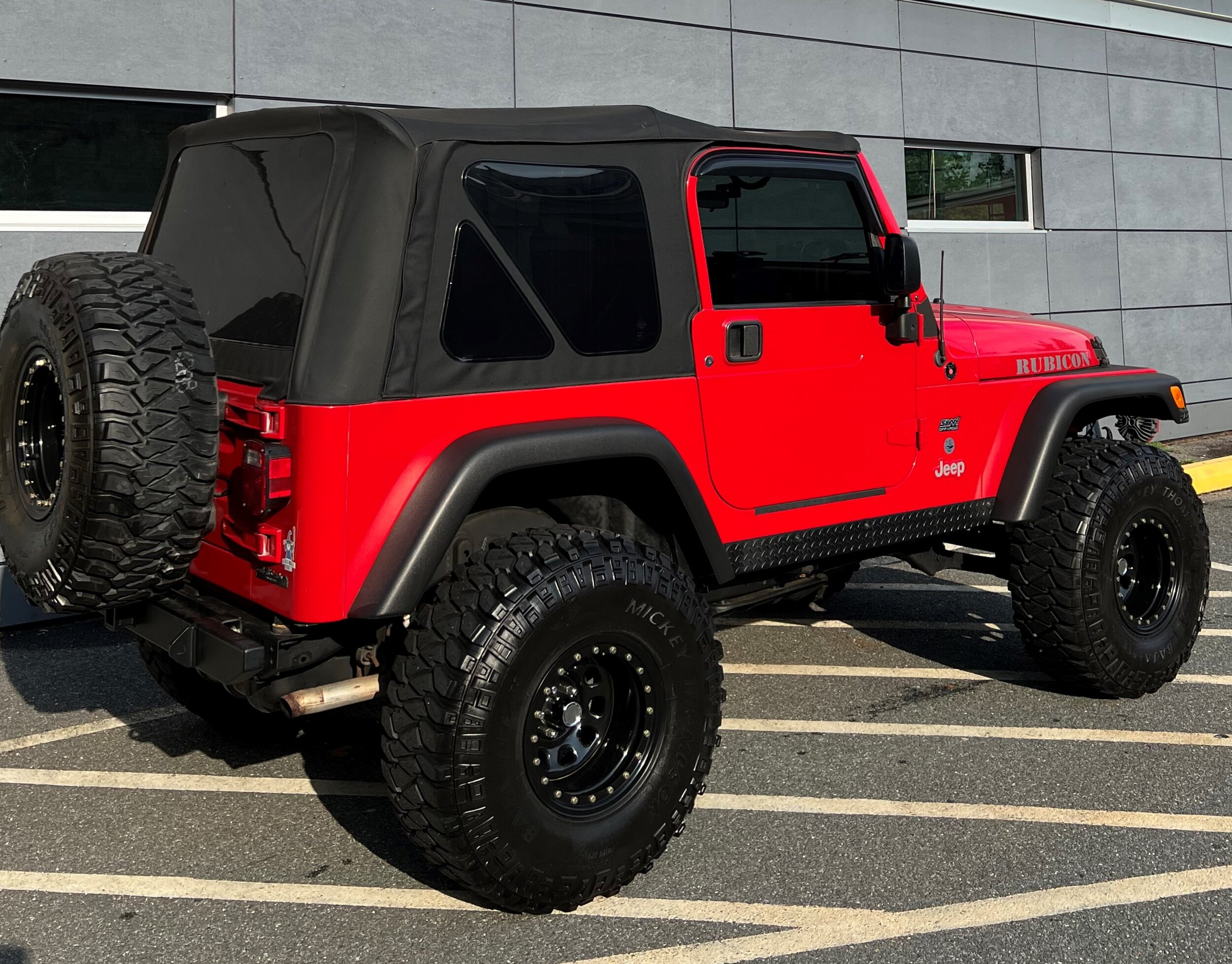

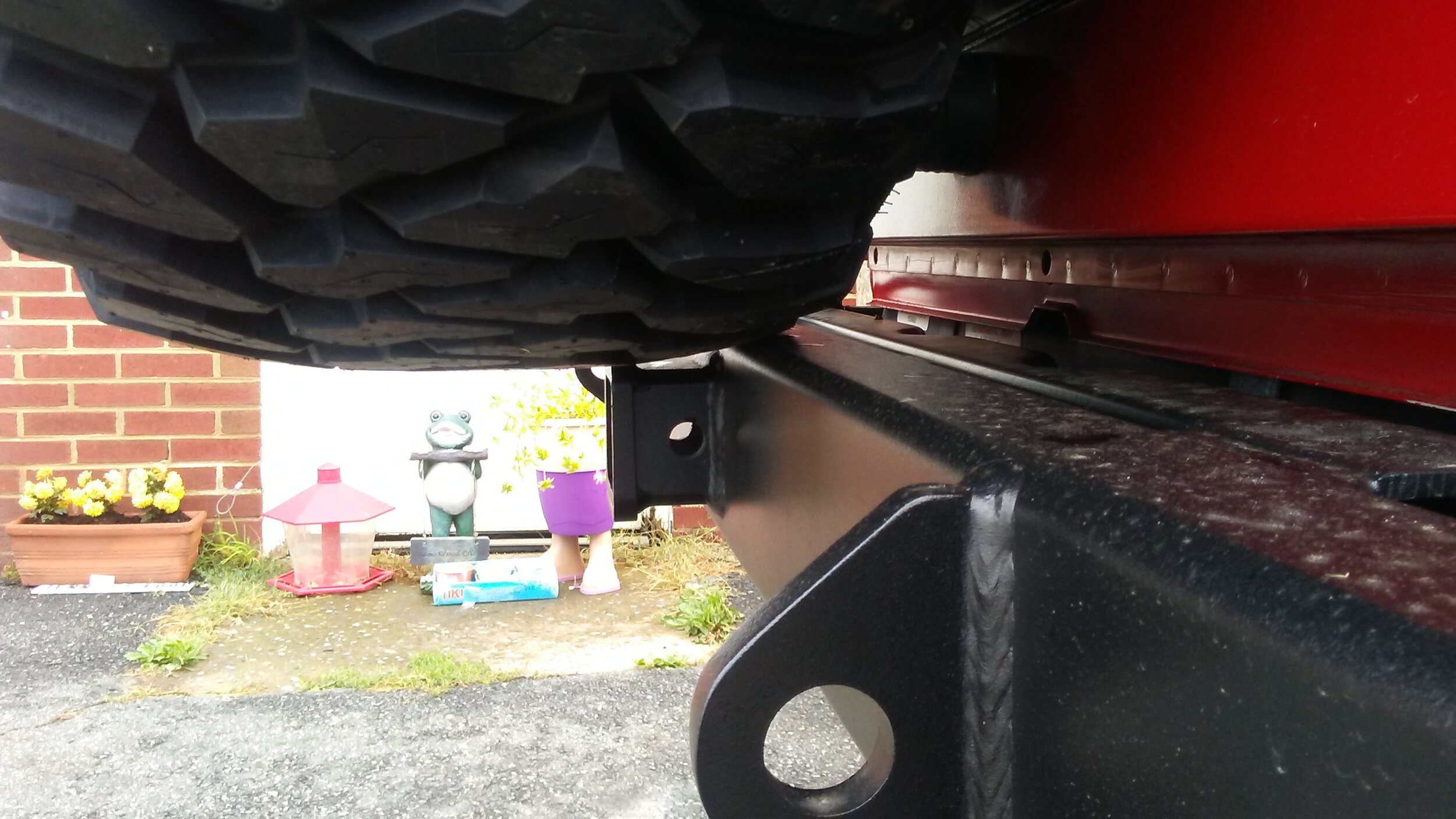

Now you tell me, after nearly 8 years with my 35" spare. :unsure:
p.s. My tailgate still opens and closes perfectly.

Nice I did the same with mine. Less weight is better for my 4 banger. Curious how did you run the wire for the license plate light? I need to come up with something better.
Very nice!!
How did you run the wire for the license place light?
I used the stock system where the terminal touches when the tailgate is closed. The light just has a power and ground wire. Ground inside the tailgate. Run the power to the tailgate connector. Inside the rear passenger wheel well connect power from the tail light to the other side of the tailgate connector.
