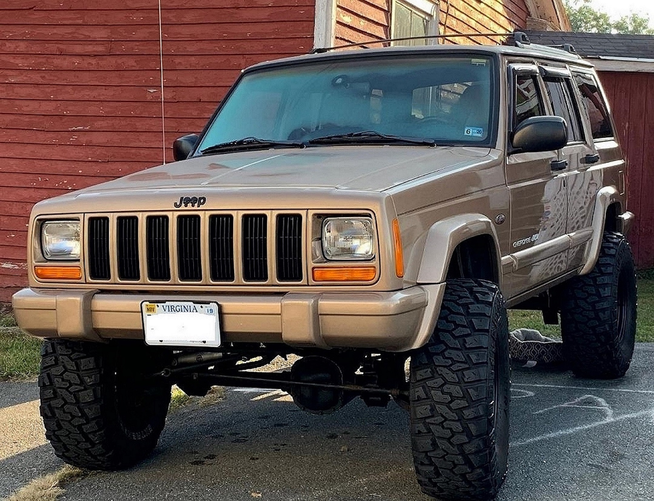

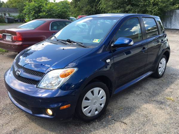

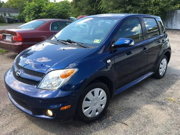

I delivered mail and newspapers with my XJ because it was all I had at the time. I spent $3,000 on a low mileage Scion. The gas savings paid for the car in 18 months. I've had it for 6 years now and drive it for long distance drives only. I NEVER drive the Scion otherwise and prefer to throw away money paying for gas for my Jeep.

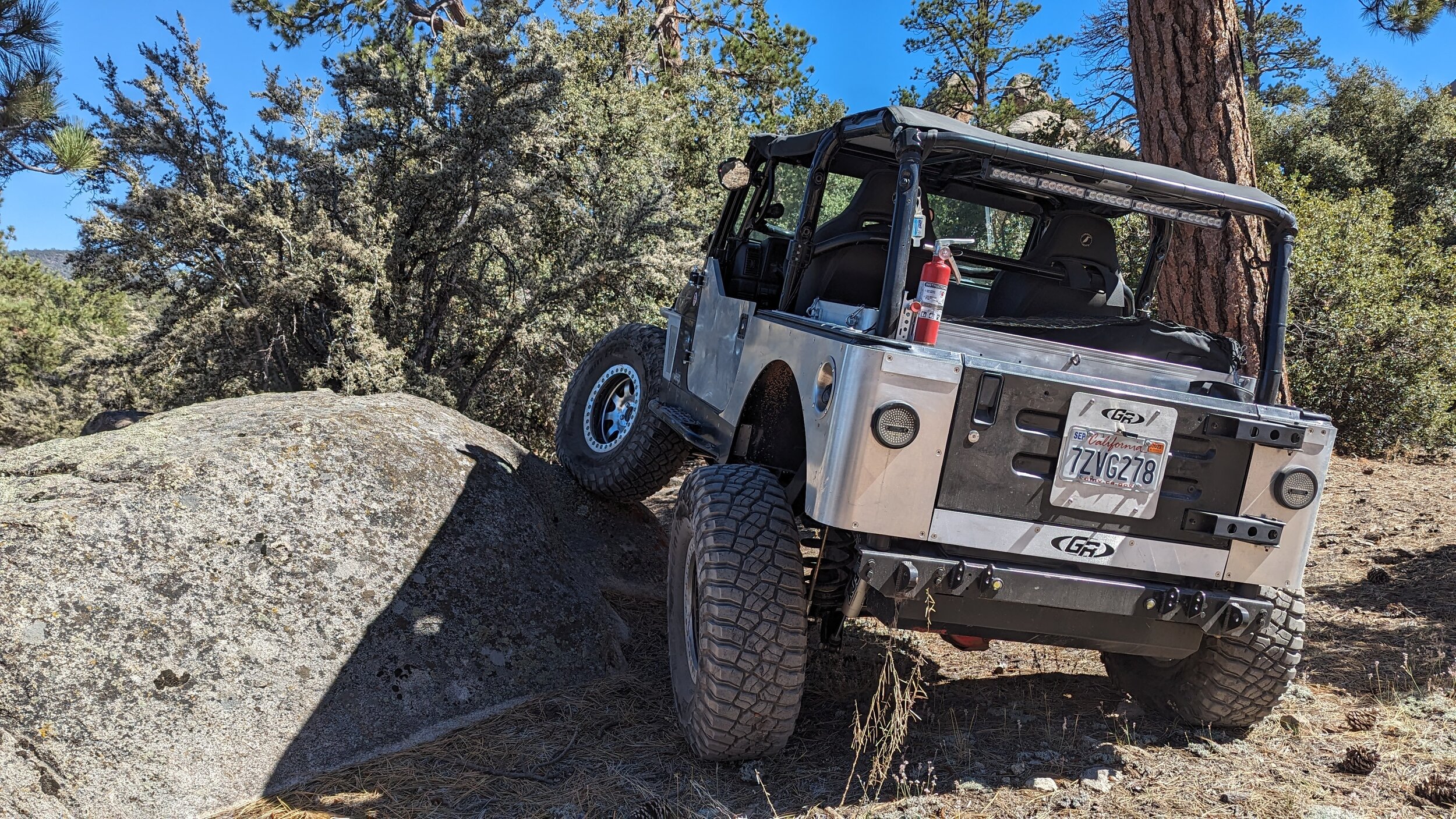

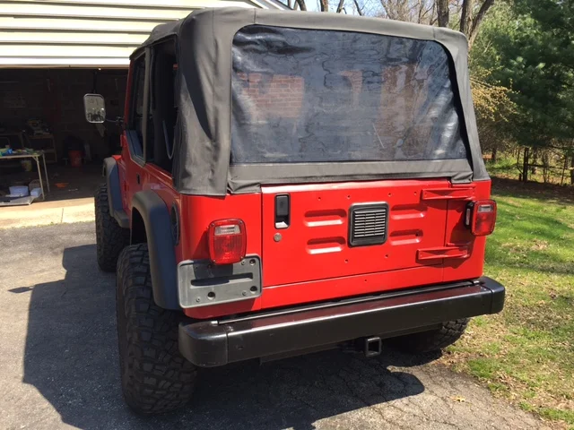

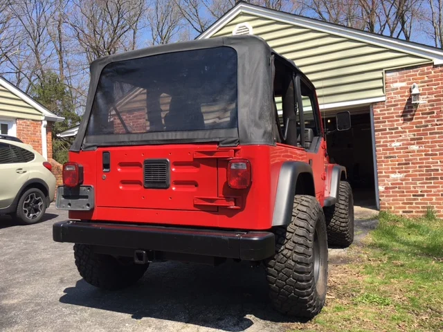

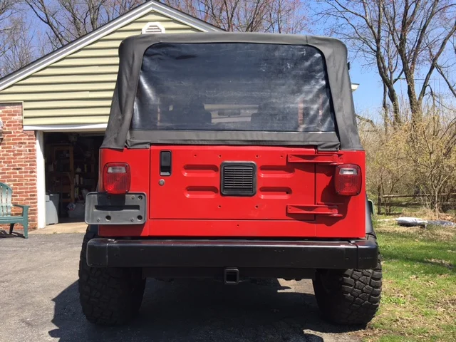

I dumped that goofy ass looking spare rack, bracket, whatever the hell it is 3 years ago & never looked back, couldn't stand thing hanging off the back of the rig. DDing, wheeling it or long distance driving regularly may be a different story, of which I do none, so I'll deal with a flat if it happens another way... one of which is, as I'm never all that far from home, just snag a ride back home to grab my spare which collects dust in my garage & pop it on.
Never considered the gas mileage aspect, doubt it has any noticeable impact, just like the clean look is all

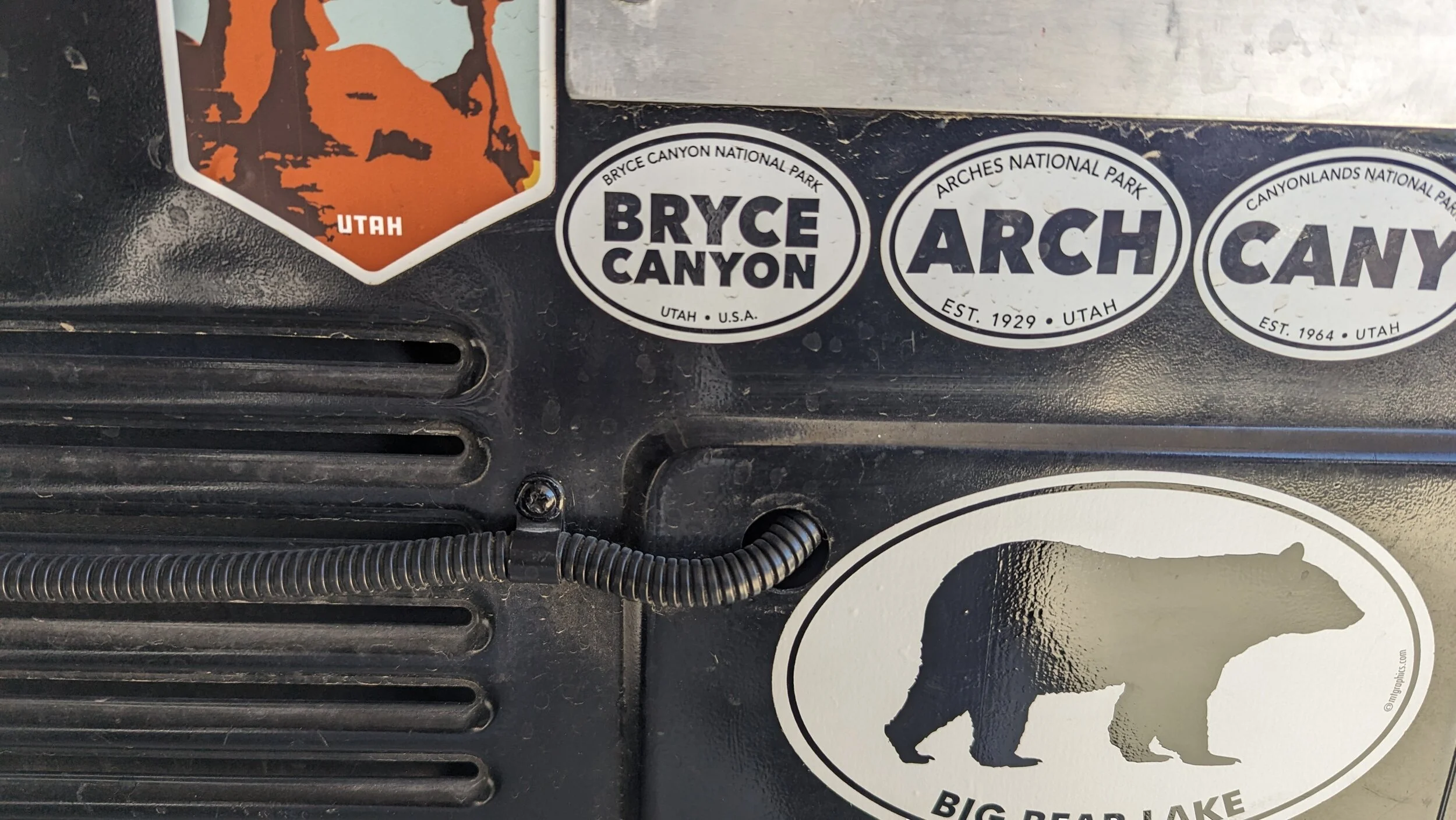

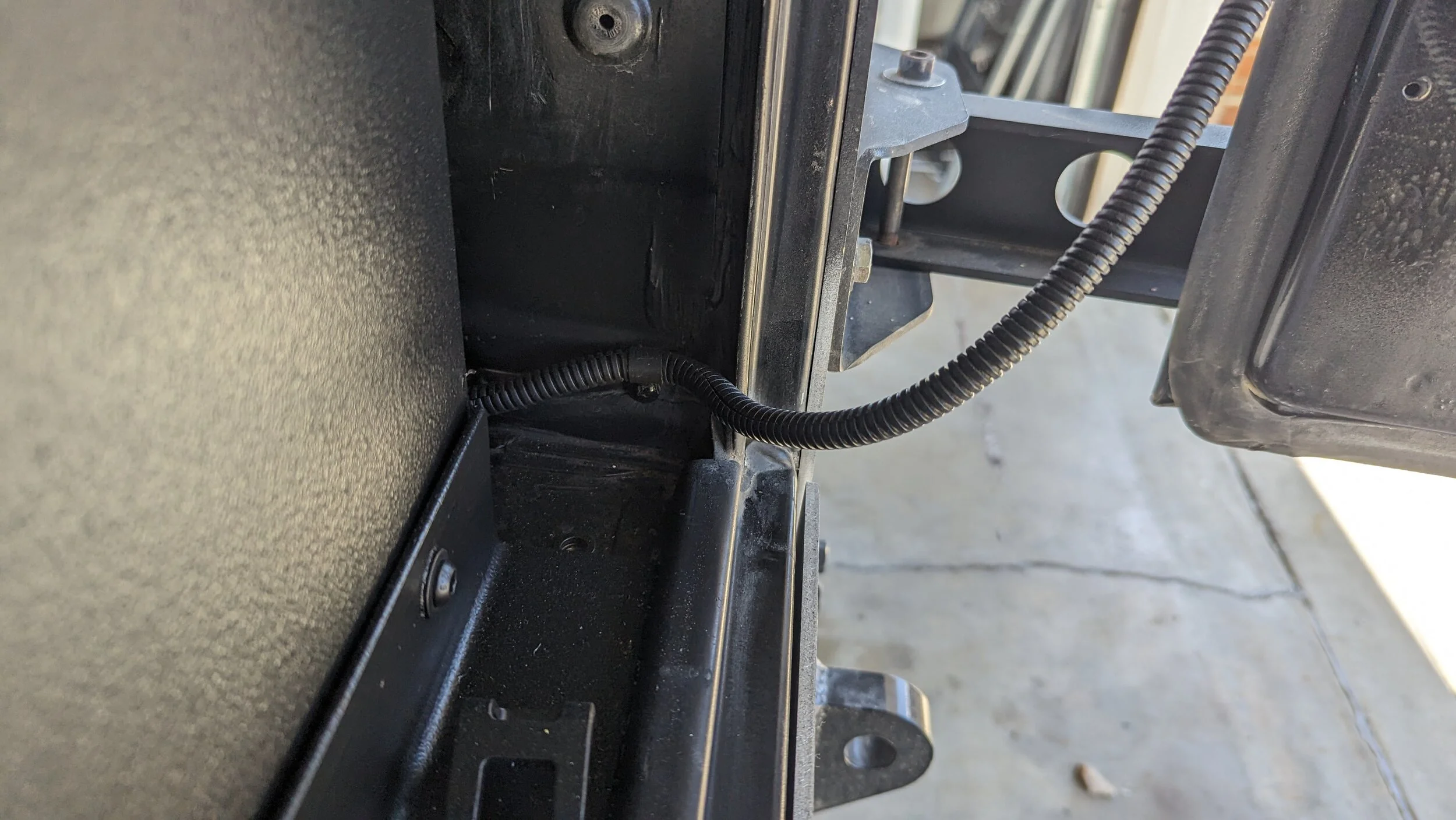

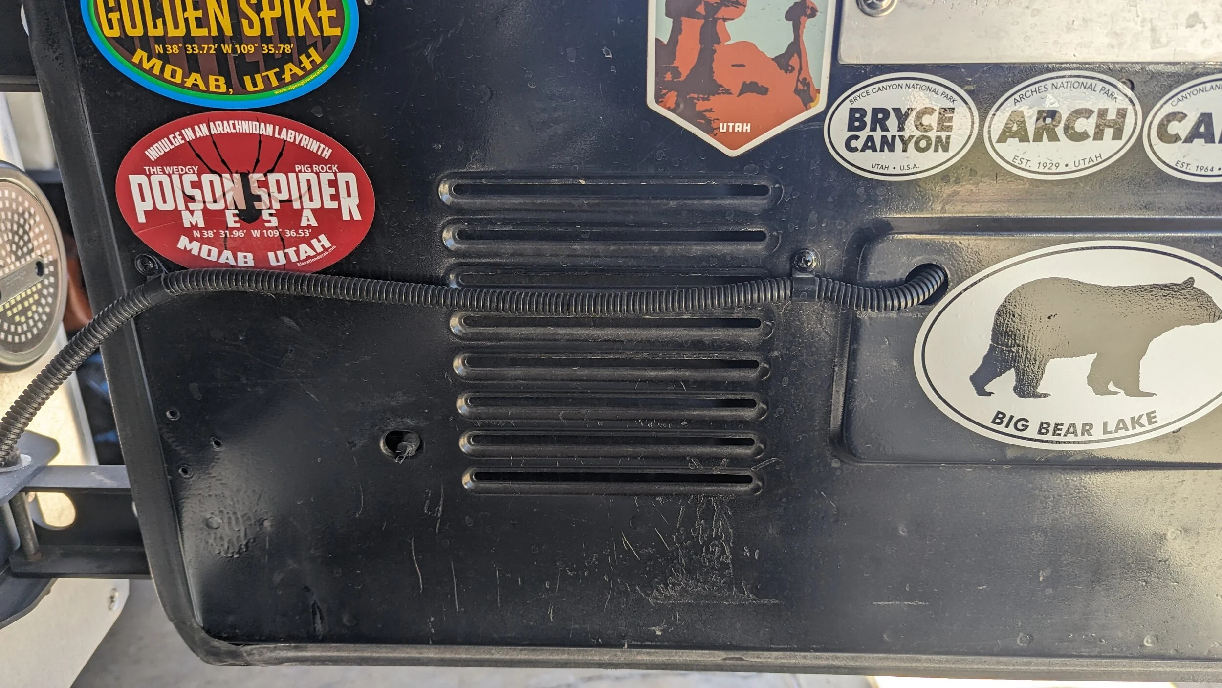

I used the stock system where the terminal touches when the tailgate is closed. The light just has a power and ground wire. Ground inside the tailgate. Run the power to the tailgate connector. Inside the rear passenger wheel well connect power from the tail light to the other side of the tailgate connector.
So you don't have a third brake light anymore?
These license plate holders have 2 lights one for the third brake light and one to illuminate the plate.
I wanted both to still work properly. So I am still using those stock connectors, the yellow wire I ran is for the other light.

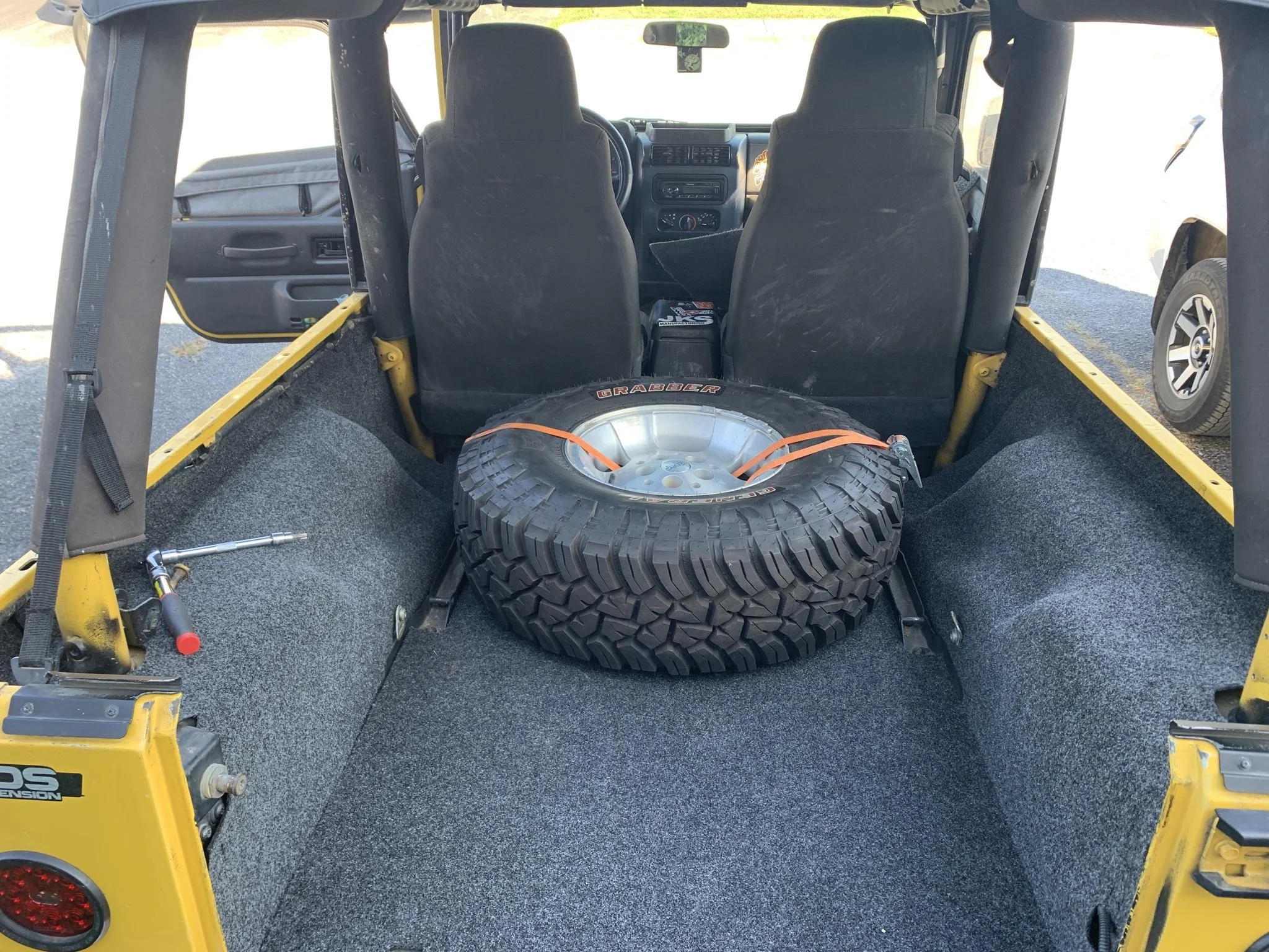

I had layed mine down flat under a rack, now i have it standing up against the harness bar.

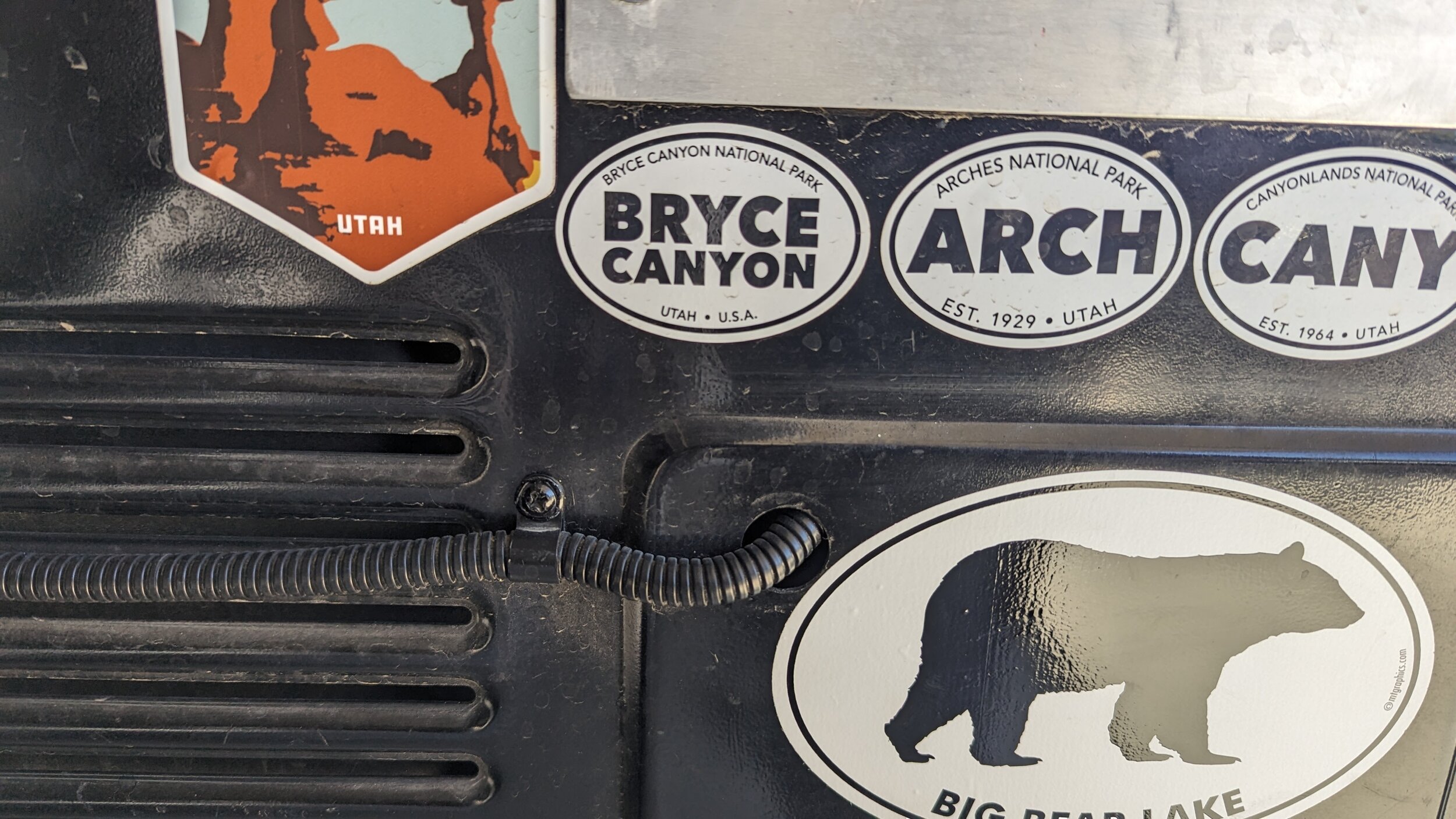

I ran mine thru the tailgate. PO had removed the 3rd brake light.
Ahh ok,
I think with mine I just need to put the wire in that same plastic loom. The problem I have is sometimes when I close the gate it closes on the wire.
I twisted it to make it like a spring but that didn't last very long
I am trying to see if there is a better way to do it.
Correct, no 3rd brake light. It's not required in WA, but it is in some other states. Sounds like you have a good solution with the yellow wire.
If you can avoid the loom and use the stock contact connector I think it will look cleaner.
