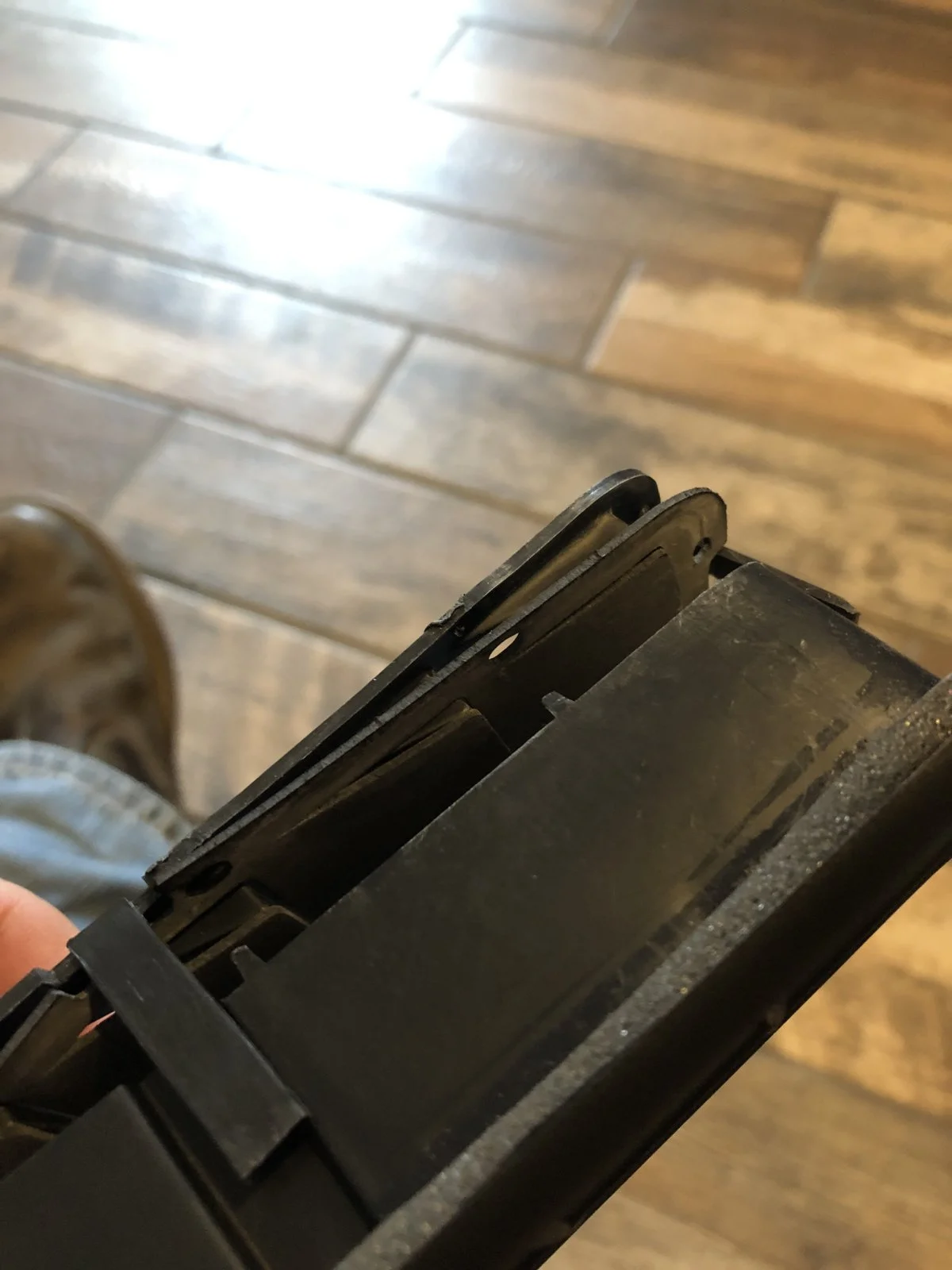

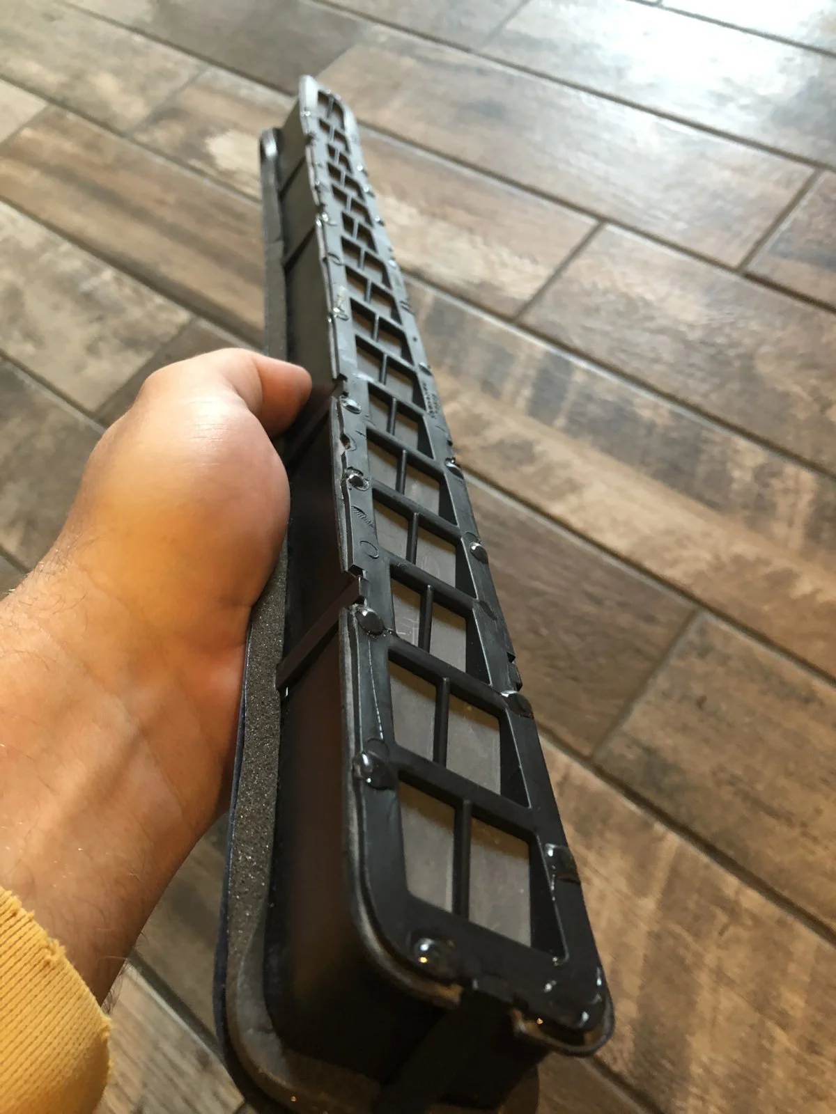

Heres a pic of where I’m talking about for future search reference.
I finally had time to stop by the store last night. Picked up some JB Weld two part epoxy with a fine nozzle and applied in all the holes where the small insert tabs seated then flipped over and applied to the back. Let it set overnight and installed this morning. It snapped on like it should. Again thanks for the replies!
