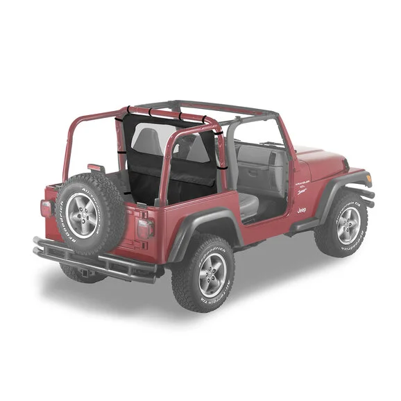

Not sure how much it would help but you can try a windjammer from Bestop

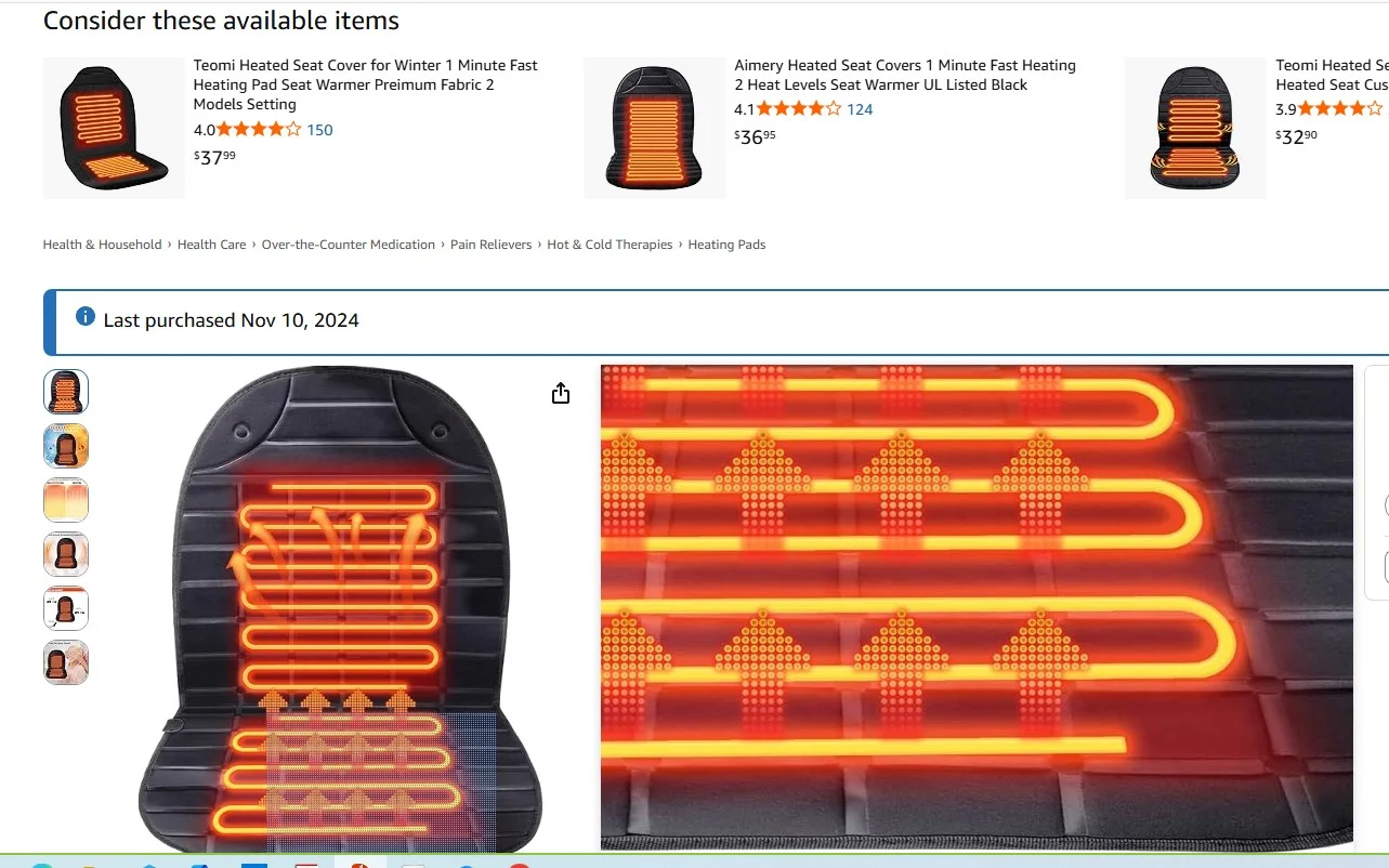

Like Mac recommend, heated seats will go along way. Dorman makes a universal kit that is easy to install and works good. I know down here you can get the universal kit from AutoZone, O'Reilly's and Summit racing. For insulation, look at 3M thinsulate insulation that they use for camper vans, it is mildew and mold resistant if it gets wet which it will from the hot/cold and your breath in the winter and then if you ever take doors or top off in summer. Put the insulation right against the sheet metal under the carpet and then fill the doors.

I'd start with heated seats to get direct improvement where it matters... on your bum.
Down here in SoCal, we don't get those types of temps, but a chilly night on the freeway w/o doors or top can be uncomfortable without them.
There are easy to install versions that go over the existing seats instead of needing to be installed under the upholstery. My previous setup was a pair of neoprene seat covers from Wet Okole that had built in heaters that you could plug right into the 12V outlet or cig lighter port.
That would absolutely help. You're cutting both the volume needing heat and the surface area losing heat approximately in half. Should quadruple the ability to heat the remaining cabin space. Especially if it's well-insulated and extended all the way to the hard top interior, but even with the gaps around the roll bar it would be a lot better than nothing because it'll reduce the delta across the rear section of the hard top, reducing the total heat loss from the cabin.
