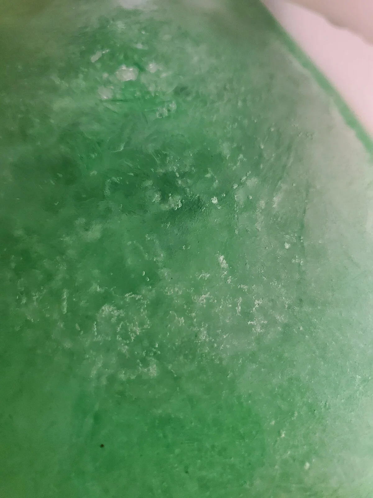

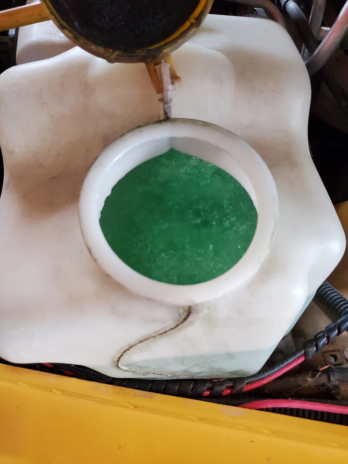

Xerex G05 x 2 ($44, Autozone) + distilled water ($1.50/gal). I used facet water. (Don't be like me). Dilute and test to -50 to -60° F

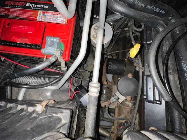

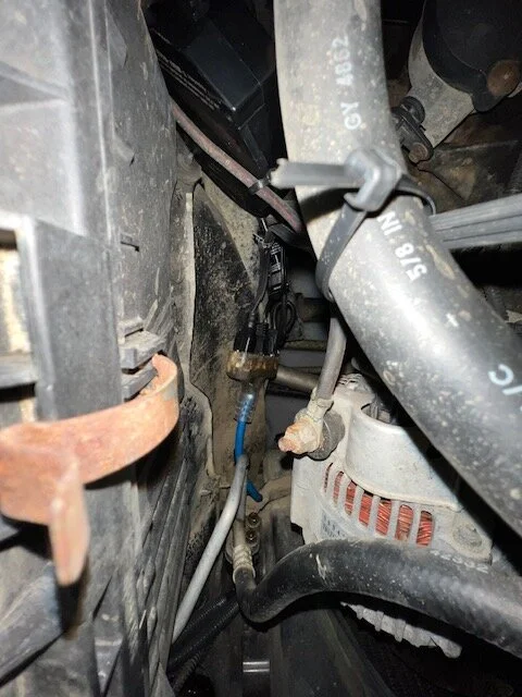

Trickle Charger
Disconnect battery cables. Connect Pos to Pos and Neg to Neg for the charger. Make sure to zip-tie or secure the box somewhere safe. On that note, I would wait to secure the power cables until you have all the heaters and junction cable in place to ensure you have enough play. Leave battery cables disconnected until the end.

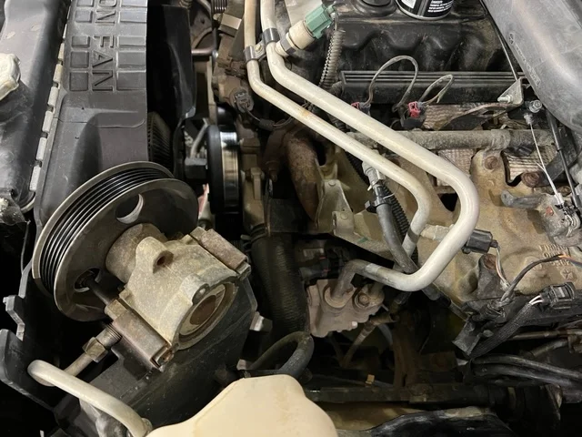

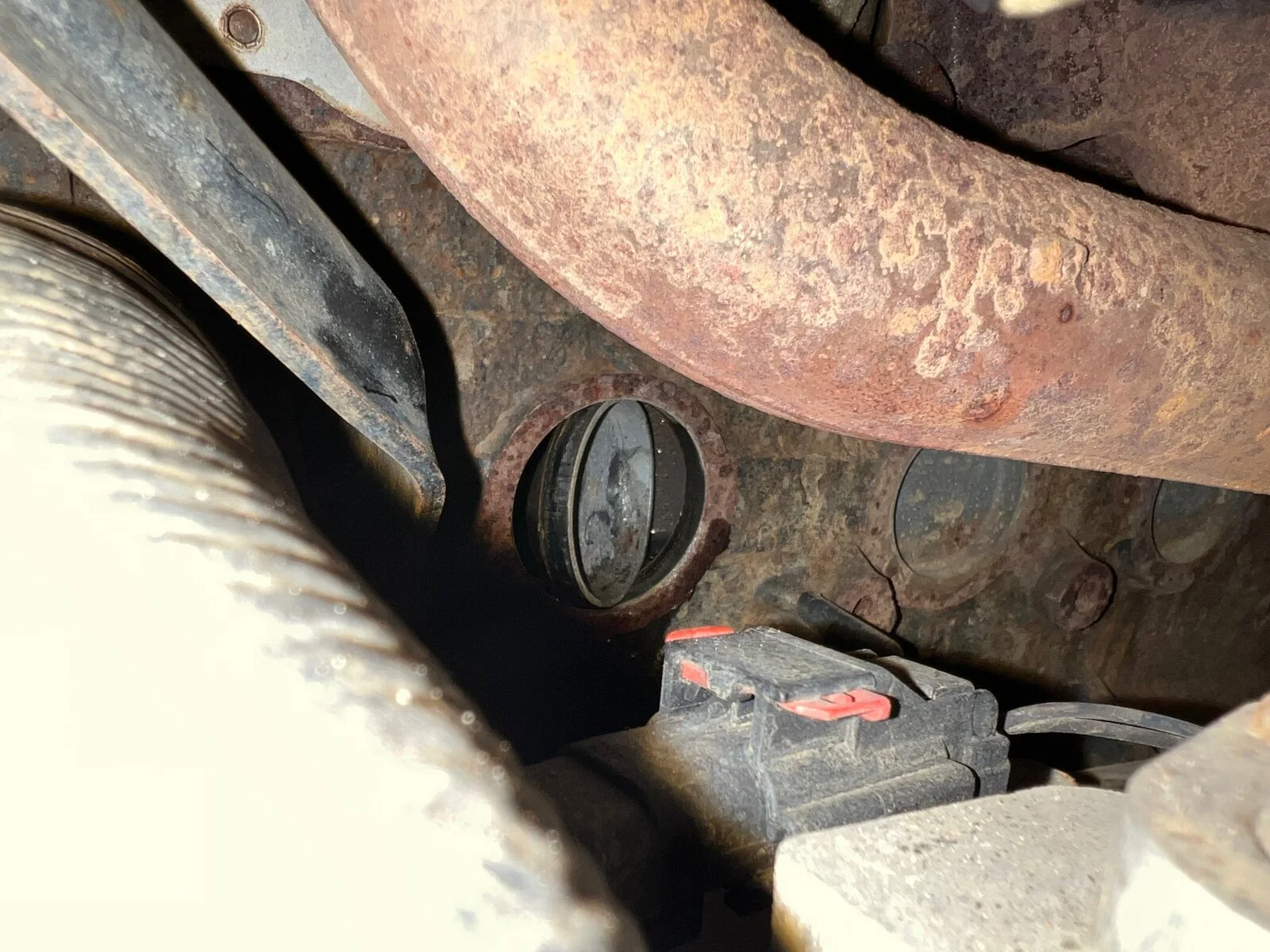

There are a few ways to remove the forward most freeze plug, as per my heaters instructions. The route I chose was to remove the power steering pump to gain access and leave the AC compressor in place.

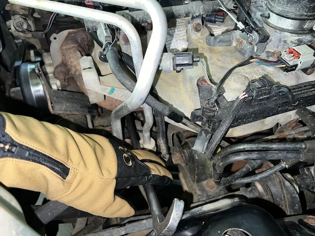

The steering pump has 3x 13mm (I believe) bolts holding it is place that need to be removed through the holes on the pulley. Move out of the way and snake a punch or similar object through the compressor lines.
Place a drip pan underneath to catch the coolant that is going to come out of the block. Place the punch on one side of the plug to rotate it vs punching it in the center and into the block and spiralling into a fit of rage. I put my pinch bar on the right side (3 o'clock) of the plug. Now proceed to beat that thing. Seriously, after 16 years that plug has settled down and laid roots in there. I removed the grill support rod 🤷‍♂️ for extra whacking room (2x 13mm).
Once the plug has rotated, snake the plier-like-device of your choosing past the steering pump bracket and pull the plug out. Now remove any burrs in the freeze plug hole, I did not find any, and clean with a rag. Install your block heater according to the MFGs instructions. My instructions were to lubricate to o-ring on the heater with coolant or soapy water and press into the hole at the 12 o'clock position (hoop facing up). Once settled and flush, tighten the bracket bolt on the heater to 25 in-lbs. Attach and route cable. I routed mine to the AC lines once again and across the engine on the intake pipe.
Now replace coolant with mix that you have tested to be adequate to your area. I went with ~ -65° F. Reconnect battery and burp air out of the system in whichever is your preferred way and check for leaks.

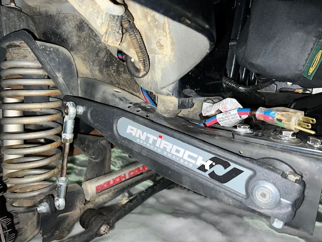

Route and secure junction cable. I routed mine between the body and frame through one of the rubber flaps on the passenger wheel well. Secure excess cables(y).

Also the trickle charger is the way to go. But don’t cook your batteries from over doing it when it gets warmer. Or you park them for long periods of time. Lost an RV battery to that $120 lesson.
