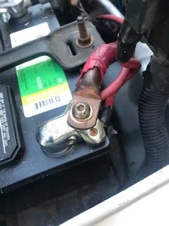

My 04 LJ has been acting like it has a bad battery, starter drag then click but after several tries works perfectly.. Since it had been sitting for a year I put in a new battery. Problem reoccurred so I figured it must have a bad spot on the starter, so yup, I put in a new starter. After instillation it still would not crank. I then switched starter relay with another and still no crank just click. Took a break and then tried again. This time a weak click then it spun over and started. Checked the batter cables, all look good but
It sent before I was done. The LJ came with a weird post connector that I had never seen before. See what you think.
Yes. Check your ground. Also remove both + and - battery cables. Clean and reattach. That funky post clamp could be causing enough restriction of electrons to F*ck wit starting. Run some sandpaper over all connecting surfaces.

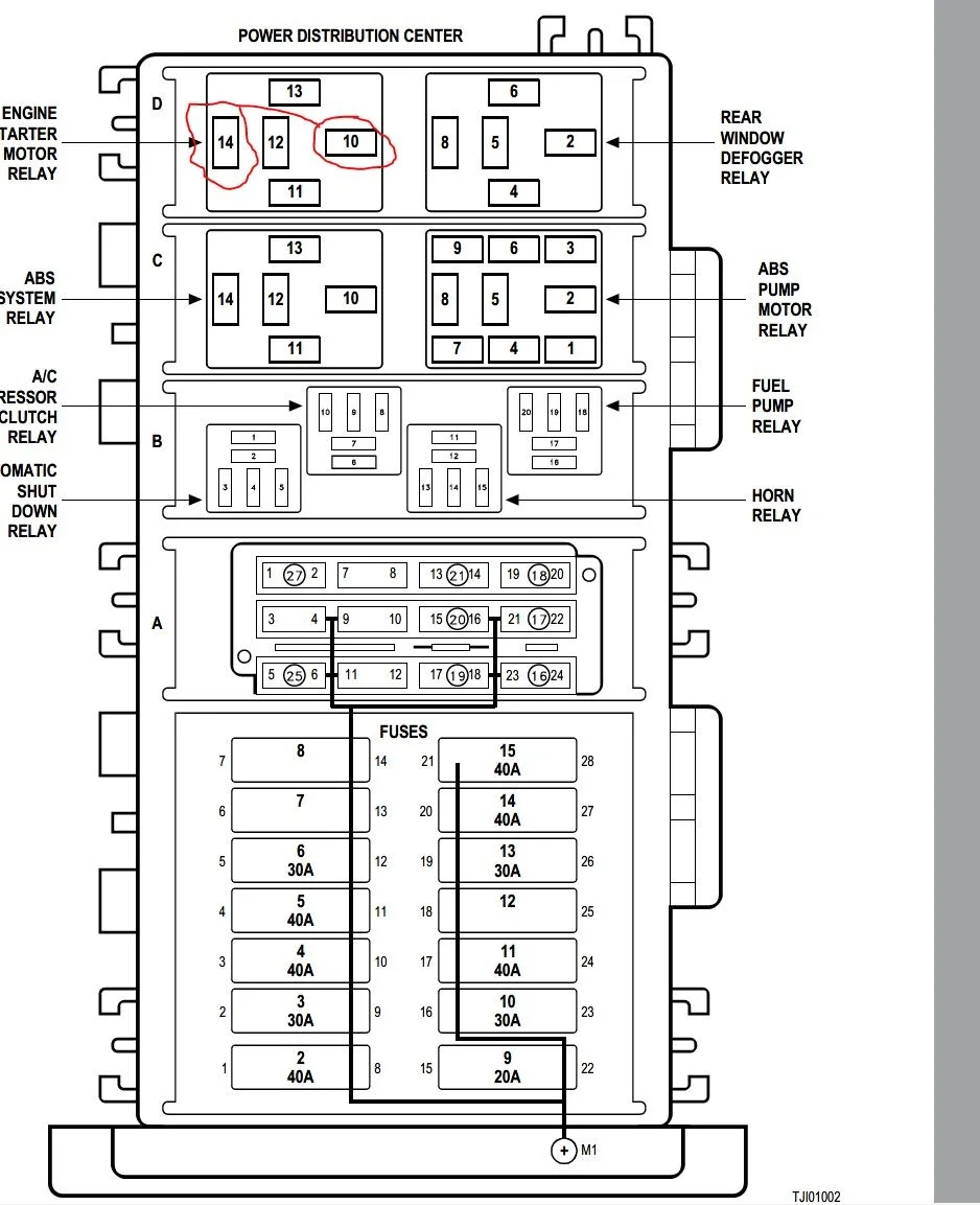

Why not jump the starter relay to isolate the "maybe switch" problem ?
Yes, you can pop out the starter relay and jump these terminals. By doing so you're bypassing the ignition switch entirely - if the motor cranks then you know the issue is somewhere in the ignition, if it just clicks then you know you problem is with the battery/starter. I just use a pair of needle nose pliers, I've had to do it more than once.
