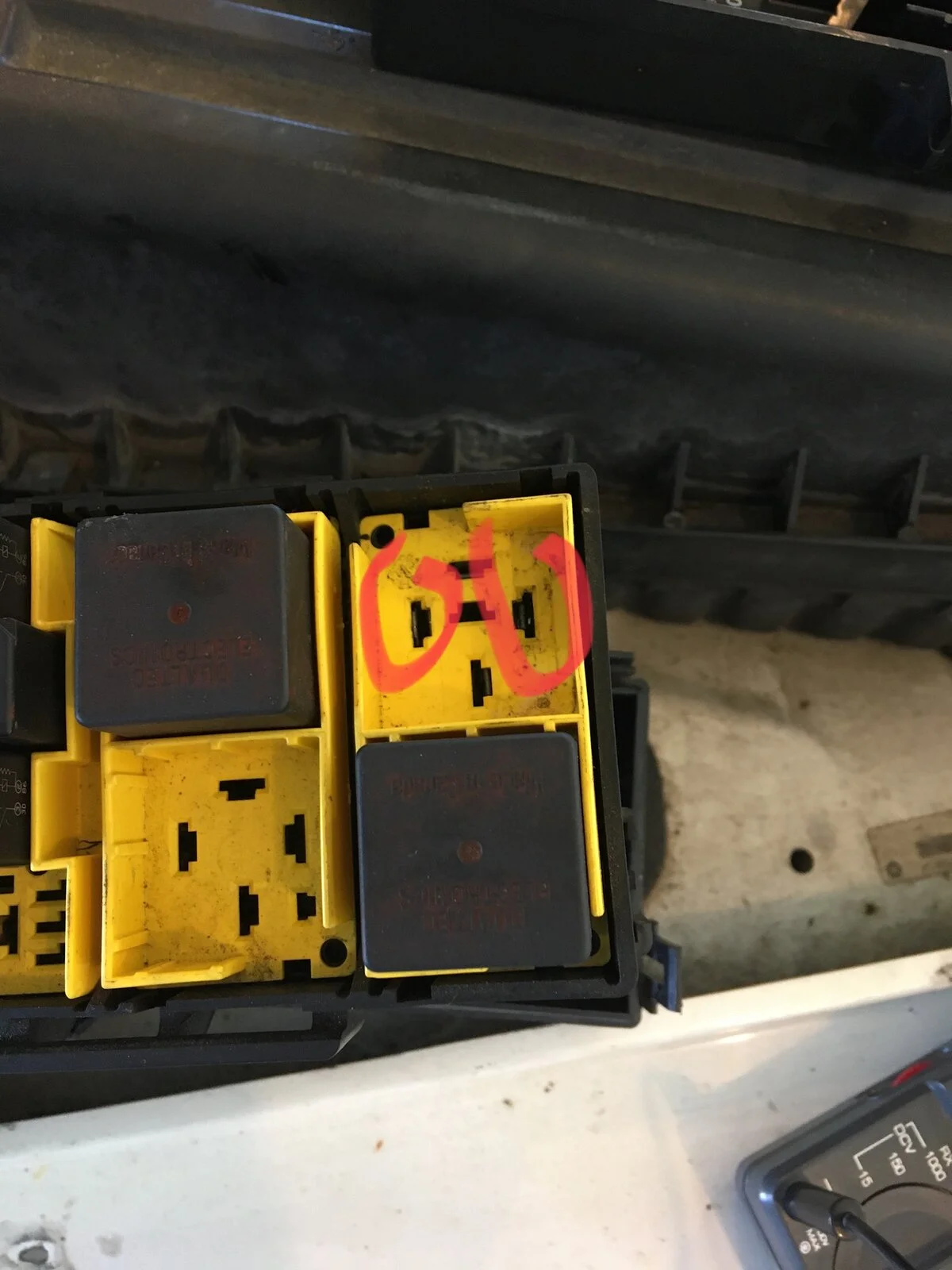

2. Looking at the starter relay circuit, the FSM shows terminal 85 is the coil ground, and 86 is the coil battery. Looking at the diagram (and the numbers on the relay) 86 is on the right, 85 on the left. But when I looked under the PDC, I found the BR LB (which runs to the NSS and is grounded when in Park, I confirmed) on terminal 86. Is this backwards from what it is supposed to be, or an I reading the diagrams incorrectly? 1 out of 5 times it starts and runs fine, and until recently it was starting fine everyday. So it can’t be wired backwards, can it?? But please look at my pictures and let me know if I’m reading the diagrams wrong. 86 is the terminal on the outside edge of the box.
