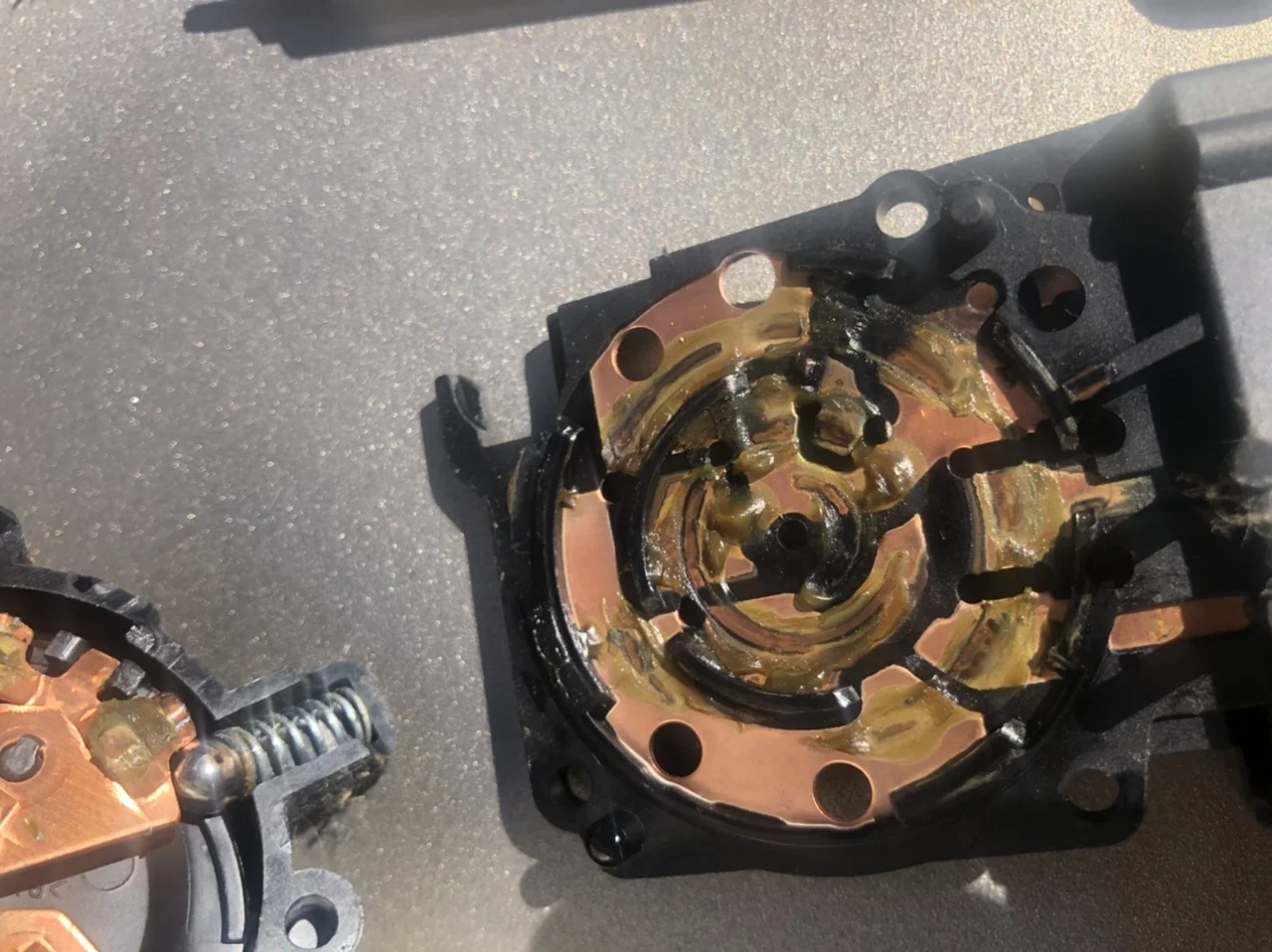

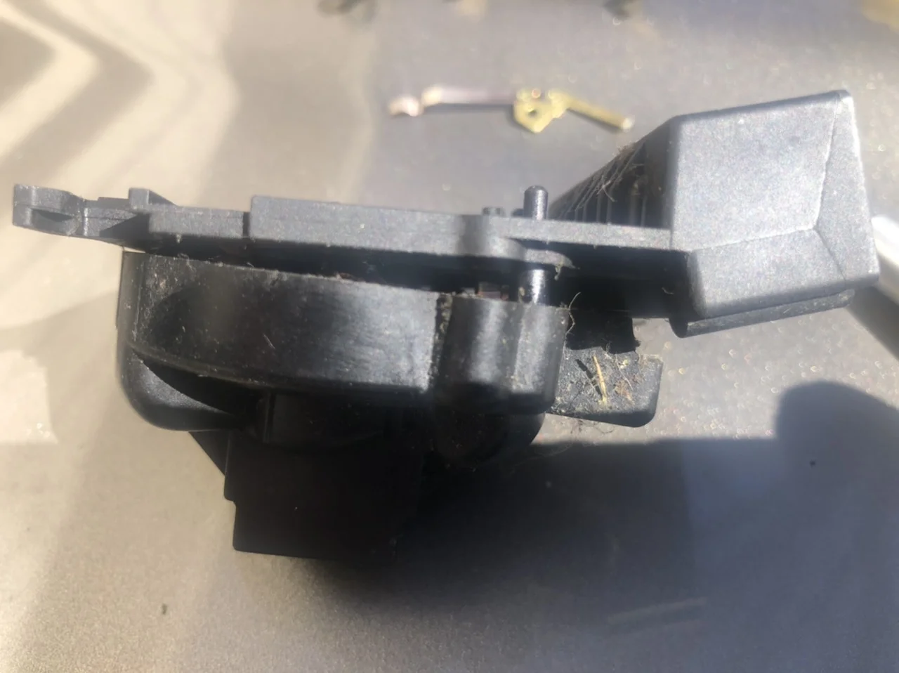

The ignition switches are notorious for going bad. Try and slowly turn to the start position and see if it engages. Years ago I diagnosed my dads Jeep, it had a hair line spot that would still engage the starter but if you turned the key all the way you’d pass it. The issue was turning the key as fast as we are accustom too would pass the spot with no starter noise or anything.
The switch can be opened, and contacts cleaned. Second photo shows dirty contacts…
