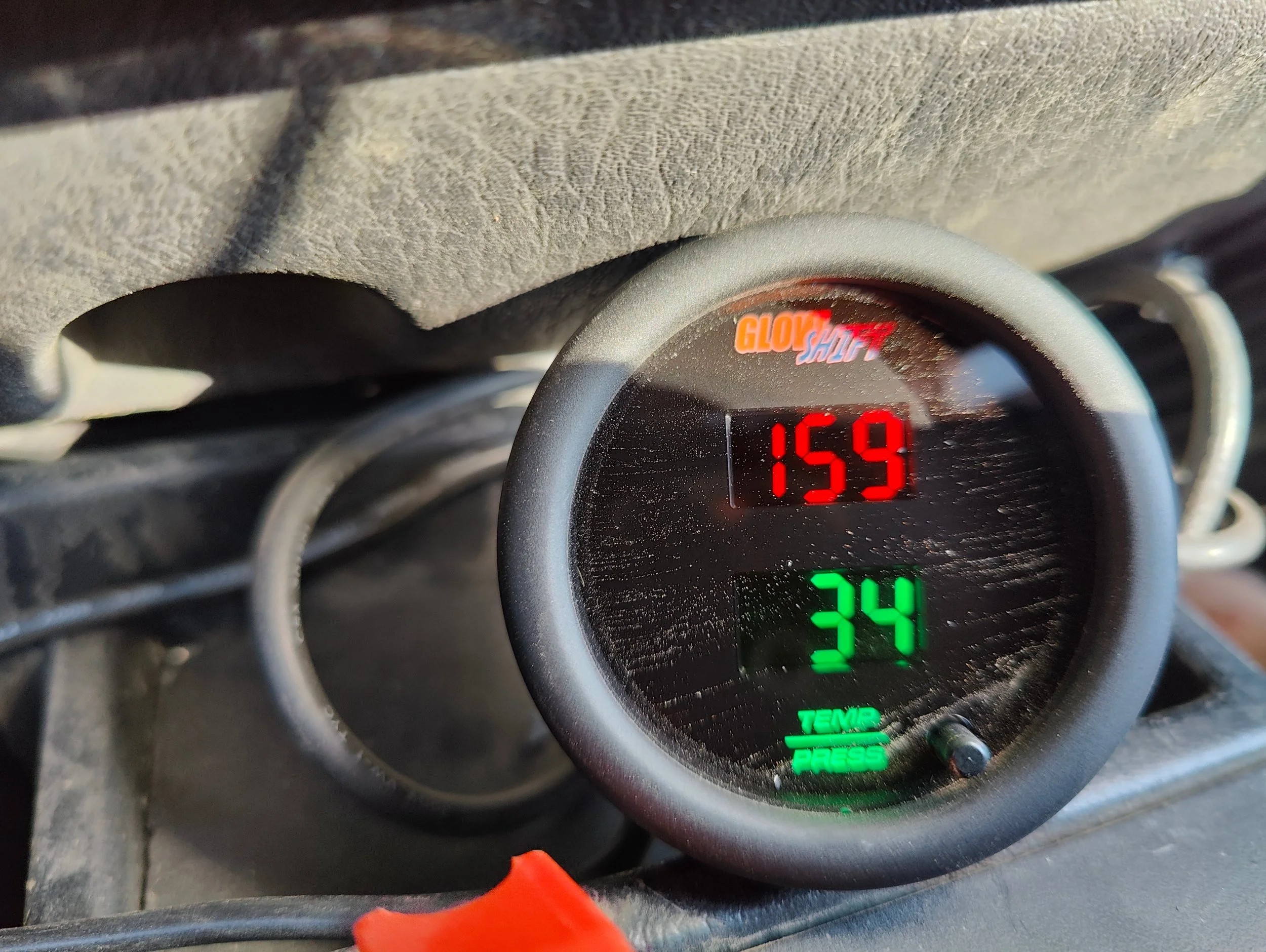

I would (and I did) install a Glowshift pressure gauge with electronic sensor. I also got the combo temperature and pressure but it's not necessary...I installed an oil cooler/heater and more or less proved it's primarily a heater.

It's just a few plugs. I tucked mine in the tray in front of my shifter wedged in-between the dash and shifter console. Not in my line of sight

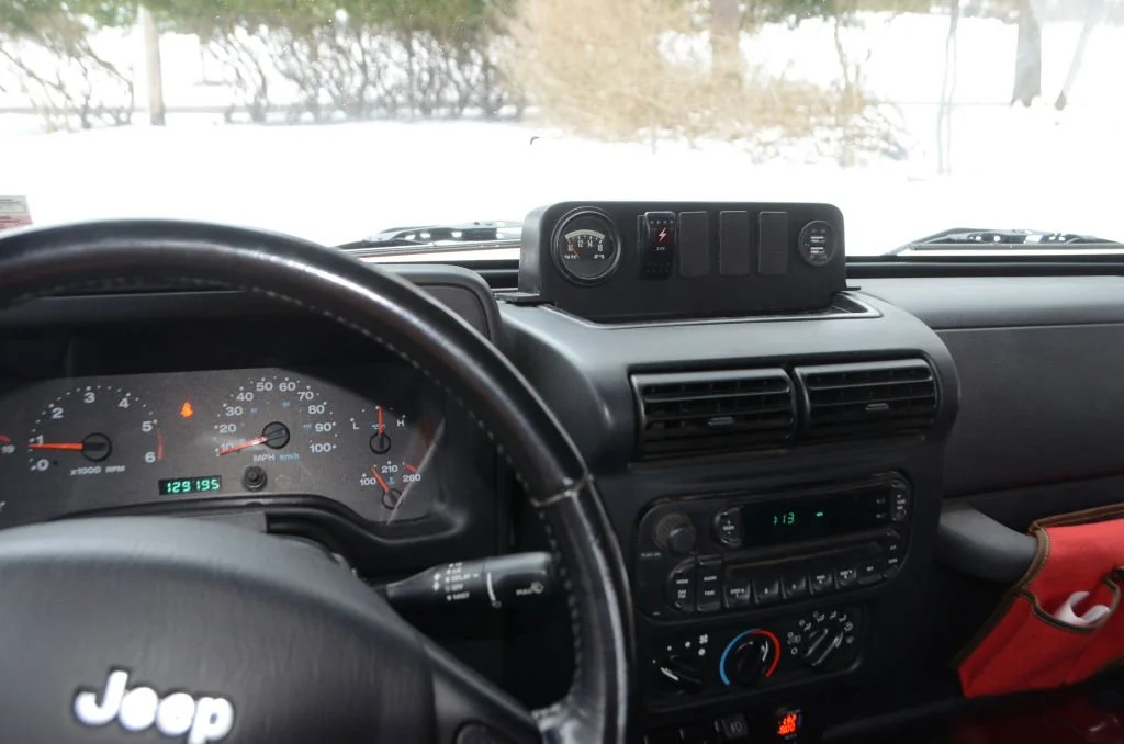

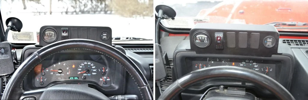

Not exactly sure where you want to mount the gauges, but a while back I did this auxiliary gauge/switch panel. The prototype was drilled for one gauge, four switches and a USB power port, but the panel is sized to fit up to four 2 1/8" gauges. It could mount just behind the tray in the center of the dash or on top of the instrument cluster although in the latter position is does interfere with the view a bit if you're not as tall as I am. A few photos of the prototype:

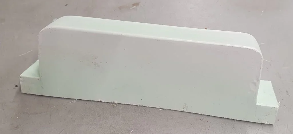

I did it in fiberglass although it could be done to be 3d-printed as well, I just have lots of experience with fiberglass and I don't have a 3d printer. As it comes out of the mold before drilling:
Is this anything like what you're thinking of?
Doing things like this in fiberglass is pretty easy and very inexpensive.
