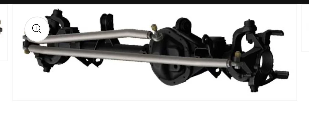

Are these type of steering arms just as strong if not stronger/better than the OEM style steering components? For the TJ. ? I just notice a lot of jeeps with these type of steering .
That's typically called Crossover steering. The TJ steering is called Haltenberger steering. Jeep's engineers switched from Haltenberger to Crossover from the TJ to the JK. Most here that are on the stock axles and 35" tires or smaller just go with the RockJock Currectlync, which is a stronger version of the stock set up. It's a well-respected upgrade. If you switch to Crossover, be aware that just because it's Crossover, it's not automatically better. There are some poor options on the market.
There have been many discussions on this subject here on the forum over the years. Here's a Google search link for you to do further reading, if you wish:
https://www.google.com/search?q=site:wranglertjforum.com+crossover+haltenberger
I started on your journey about five years ago, and after reading up on the subject here on this forum, I went with the RockJock Currectlync and Mr. Blaine's high-strength tie-rod.
That sort of steering has no place on a factory width TJ axle.
The reason you notice a lot of those on TJs is quite simple; there's a lot of idiots out there who buy into the marketing hype and love to create new problems for themselves.
Again, they have their application but it isn't on a factory width TJ axle. It's on a 1-ton axle setup or similar.
