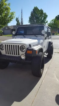

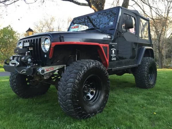

I just bought an '04 rubicon. It currently has 33x12.50r15 tires on it. I'm assuming its lifted, but how much?
The previous owner was the 2nd owner and knew nothing about the jeep. I took it into a shop and he said it had 2 inch spacers on it? TIA! 13235956_10201764981722951_1813525751_n.webp 13236306_10201764934681775_1724778741_n.webp
It's definitely lifted to clear those 33" tires. I would say that's somewhere between 3-4" of lift.
Hard to tell for sure though without seeing better photos.
You can measure the springs to check. Measure from the top to bottom spring perch, and stock the front will be right around 12", and the rear will be right around 8".
